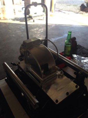

I'm so fed up with UPS. They are holding my wiring harness for my coil on plug setup until the 4th now. I guess it hardly matters since the intake is still at the powder coating shop and the new tops at the Cnc shop.
Posted via Topify using iPhone/iPad

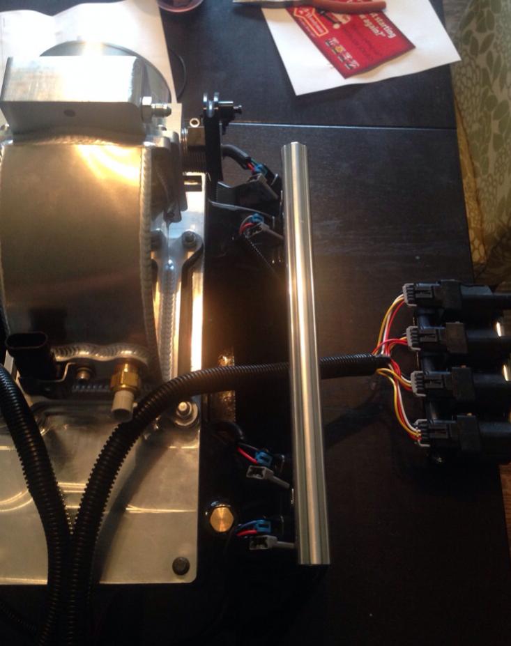

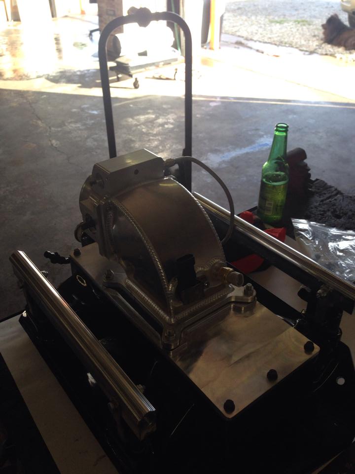

One step closer to being done. At least I can put the intake back on.

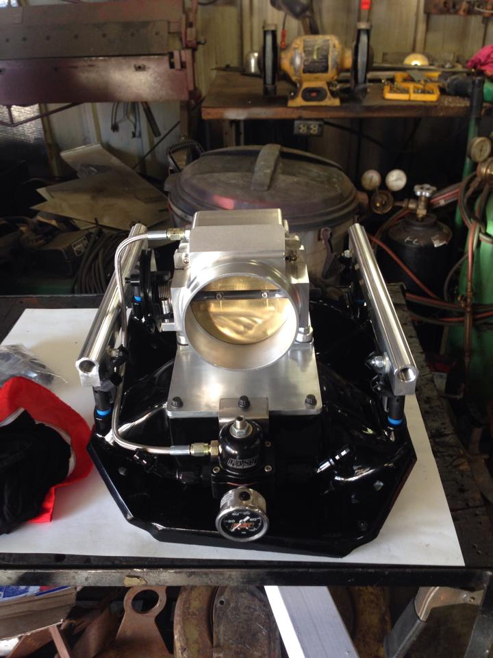

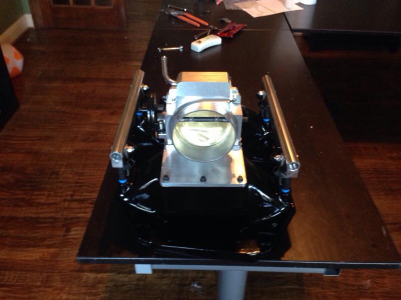

Waiting on a few more fittings so I can try to put it back together. The manifold is coming along though.

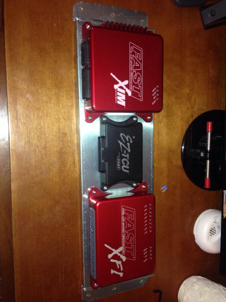

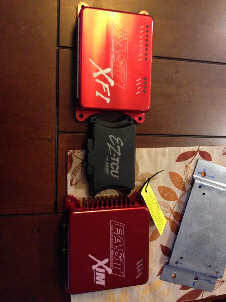

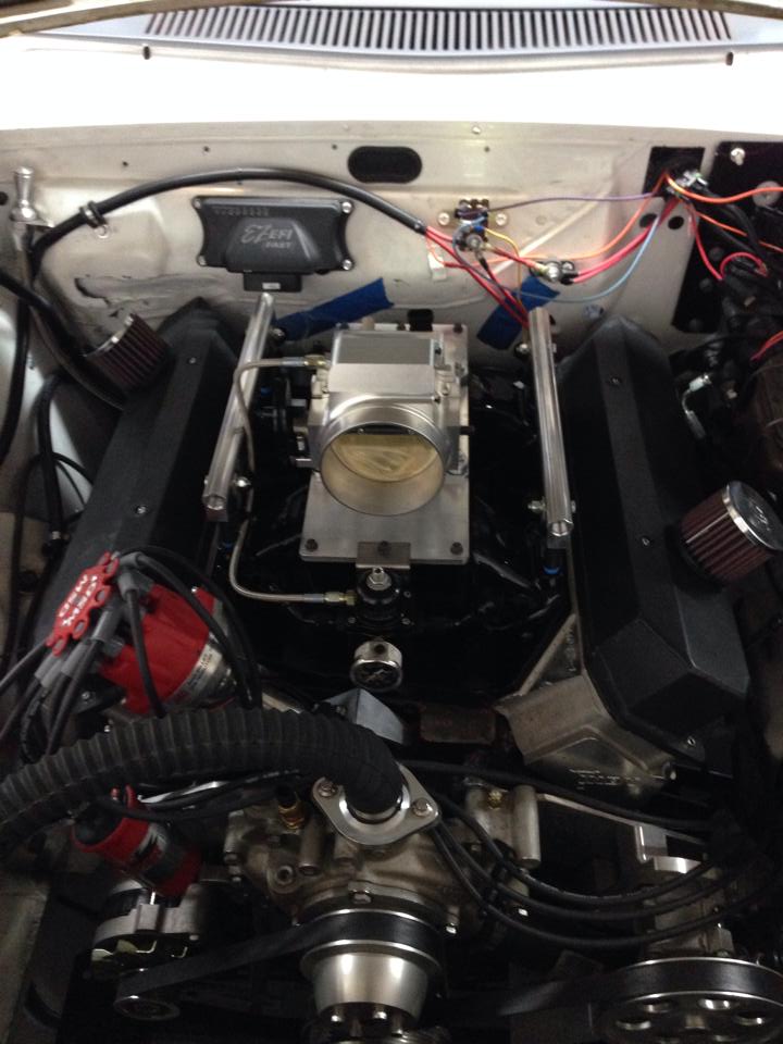

Getting ready to embark on the coil on plug ignition journey,
Perfect! Are those weatherproof or do they need to be mounted inside the car or trunk? Do they build much heat?
They will be mounted under the dash inside. The Xfi isn't weather proof. The XIM and Tcm are weatherproof. They don't build much heat at all.

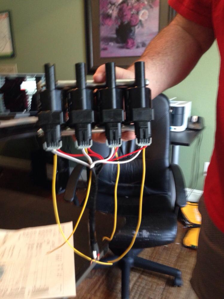

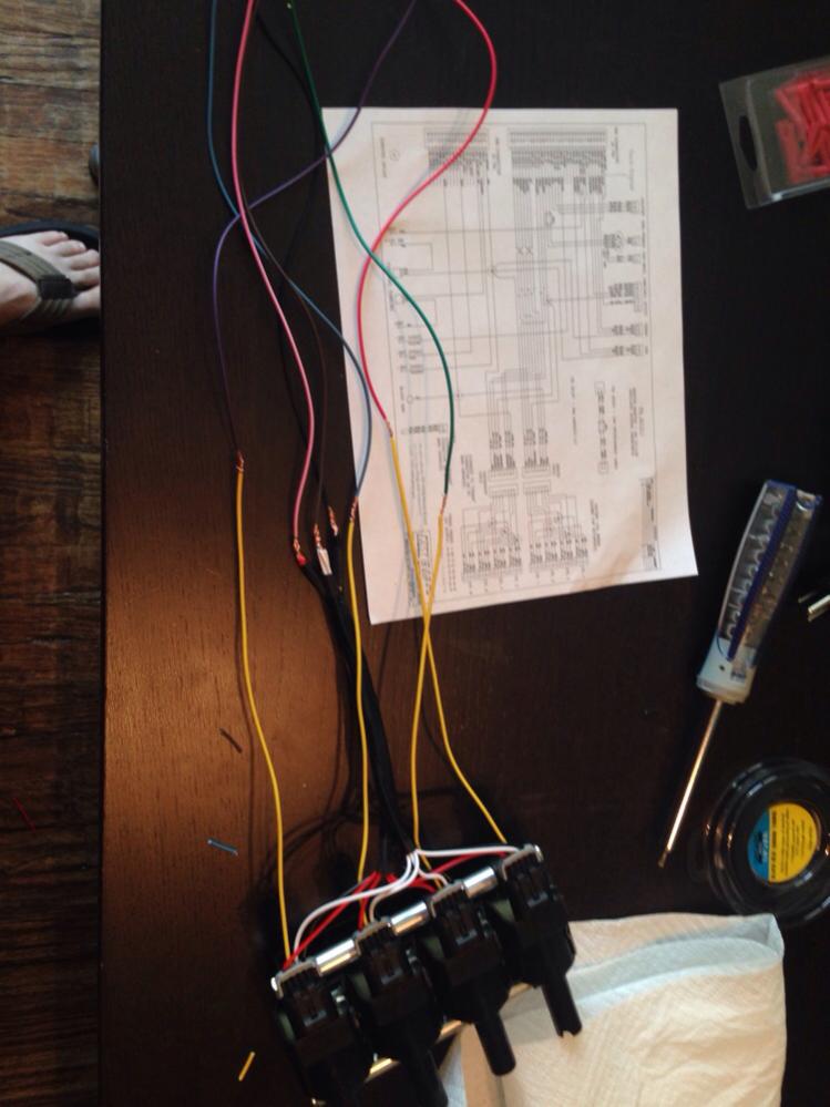

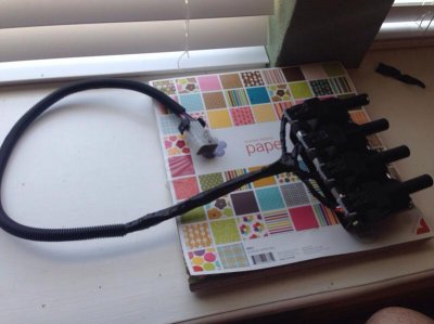

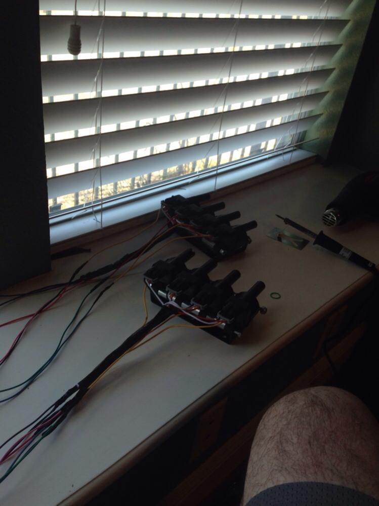

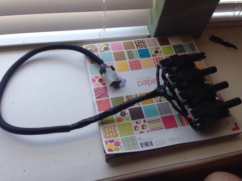

Making the coil on plug ignition harnesses today for my big block Mopar. All I need to do is solder the connections and seal everything up. One side down and one to go.
Coil on plug harnesses are basically done.

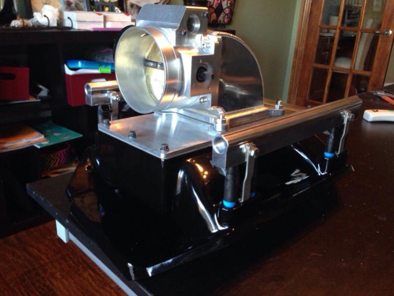

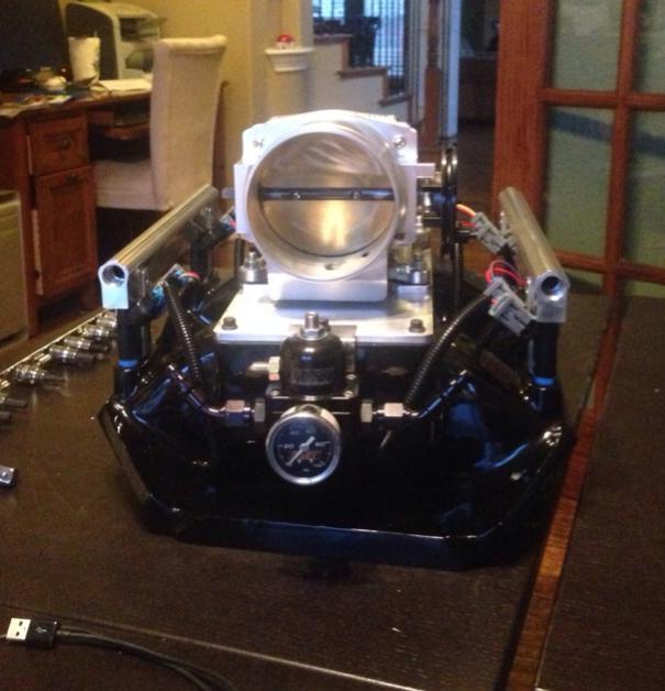

Getting closer. Made up the injector harness today. Waiting on fuel rails. The first set didn't have the tap run through them correctly.
Is the air gonna go thru the tb even though it's upside down? LOL!!!!
Its not upside down. It is reverse airflow enhanced
