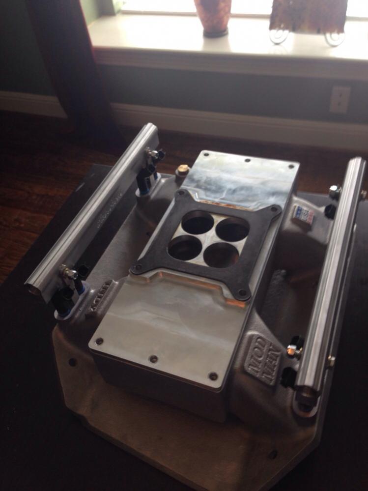

We I finally got the manifold back from the machine shop. It came out good. Waiting on the elbow so I can mount the throttle body and put it back on the car

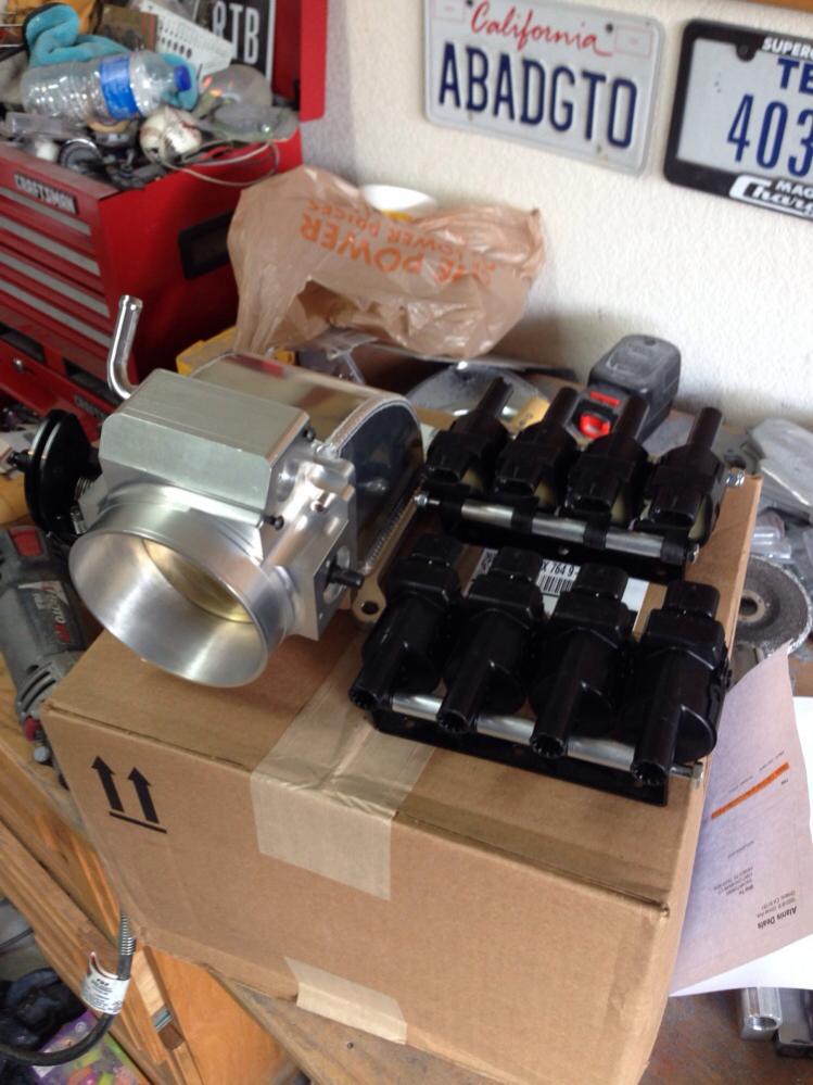

It was like Christmas came early at my house today.
Ls2 coils and mounting brackets, a 90 degree sheet metal elbow I had made, my crank trigger all showed up today. Finally

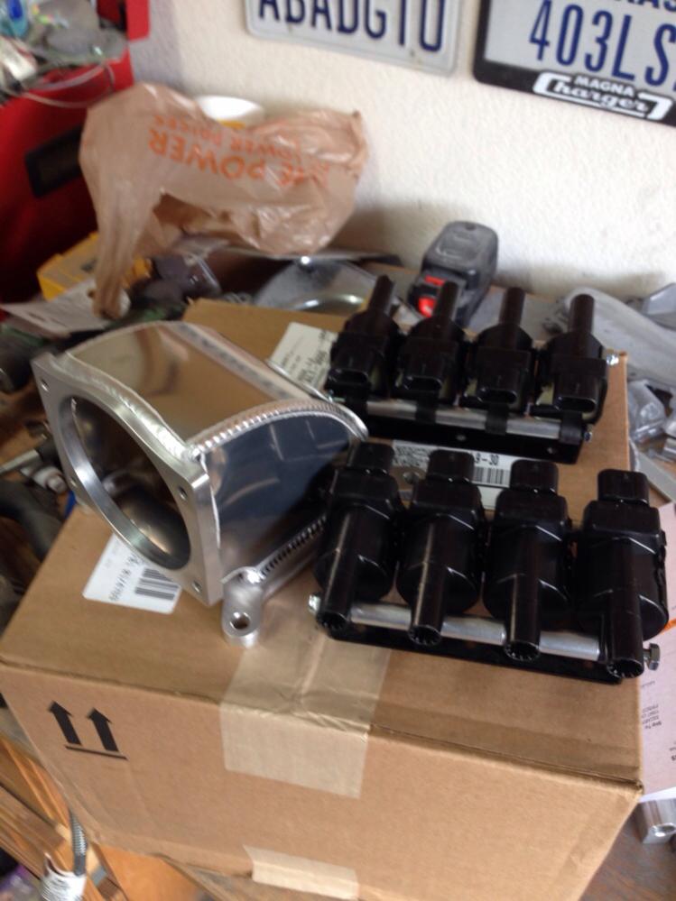

With the 102mm throttle body attached

Man, those are some sexy parts!
Greg, should clear it with an inch to spare
Looks good. Whats with the odd fuel lines?
There'a an delivery and return line at the rear. The front is a cross-over line from one side to the other. This was built by Kevin Mignosa and run on his poly for a while. He designed and built it all and used a wide combo of injection parts which caused him trouble so he decided to go the single 4bbl carb route and I swapped him for my stock, new in box, Weiand 7503 manifold. I'm going to use an EFI from one of the manufacturers. Maybe Eddy, maybe Fast-EZ. Time and money will determine that.
