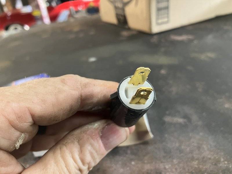

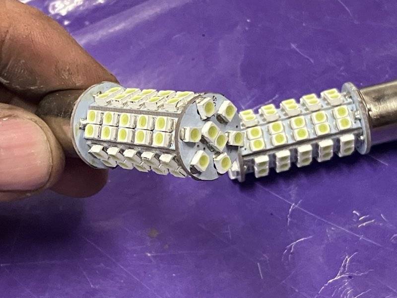

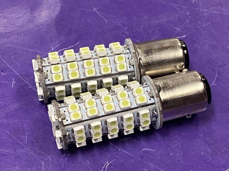

I recently picked up the LED lamps shown in the link below from Amazon..Cheap price for 3 pcs.
Amazon.com

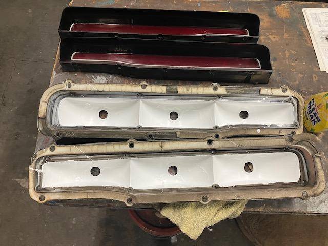

I replaced all the incandescent lamps on rear of my 66 Charger.with these LED's I did not replace any of the front lamps, kept them as incandescents so there was some current draw and the original thermal flasher did not have to be replaced...Since the charger has 3 lamps per side, a car with one or two might be different situation and require a LED flasher unit.

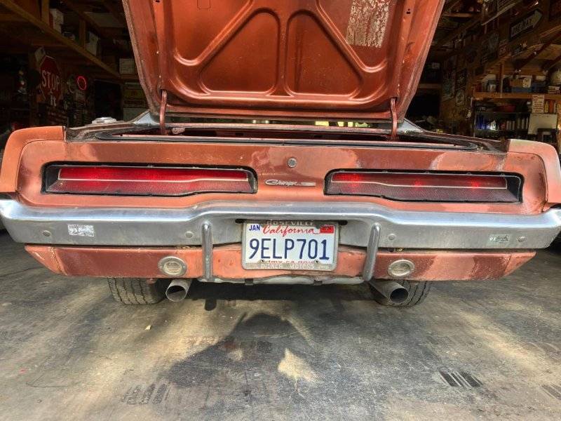

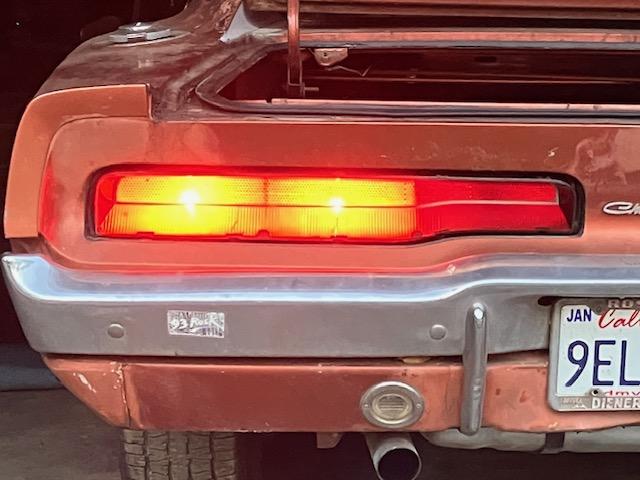

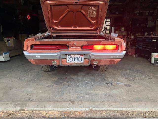

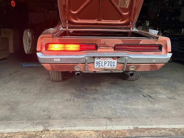

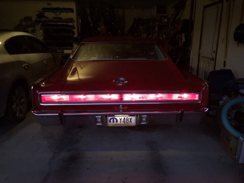

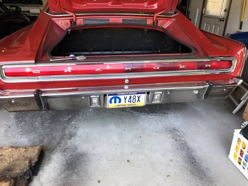

Very pleased with the brightness of these , at least 2-3 times brighter than incandescents. The one pix shows the LED's on LH side and incandescents on RH side in daylight to show the difference. Second pix is night time brightness of the LED tail lamps, the turn & brake functions are significantly brighter..
The side by side comparison is dramatic. To me, the left looks even and consistent while the right side is dim and has uneven brightness.
