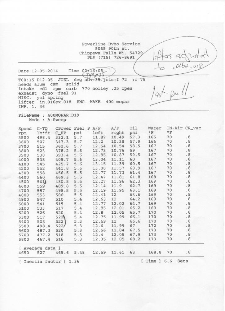

This turned out to be an awesome thread with a pile of great info HT413. I know you have seen these #'s, but I thought I would post what my combo made if others are curious - hope you don't mind.
400 block bored .040, 440 Source 451 stroker kit, 10:1 compression with flat top pistons, 440 Source Stealth heads(surfaced and a valve job), Holley 770 Street Avenger, Comp XE282 solid cam, 1.5 roller rockers, Edlebrock RPM Performer intake, 6 quart Hemi oil pan, Firecore distributor, orange electronic ignition box, Melling hv pump. We also did the same test with a Holley 850 double pumper. It gave an additional 8 hp & 8 ft.lbs. over these numbers.
Forgot to mention that at first. 10:1
Our builds are really close. When you account for the lash of your solid, I think our cams are even in the same ballpark in duration.
Great to hear the 770 carb didn't give up too much vs the 850. I was thinking With holley 750 I might be losing a lot, but hey, maybe not. I wonder how the 750 vac secondary compares to your street avenger.

770 vacuum and 750 vacuum have same venturii, throttle bores and boosters. 770 has few more gadgets. shouldn't be any power difference between them if both are optimized. in my opinion both are small for 450 cubes, but if it's what you have go for it.
