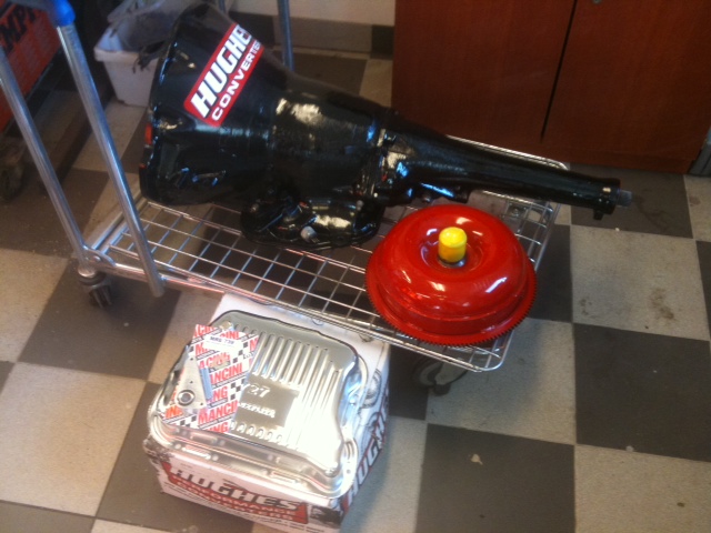

Went on a trip to my folks and picked up the tranny I left to a guy nearby them a couple of months ago, it was a 727 from 383 2 bbl so he had to change some parts inside so it has the same spec as the hemi tranny (he says, he has built 4 trannys for me before and he is great), he also put in a shift kit and I put on some fresh paint and a decal just for the looks...
Got a new Hughes 24-25 converter and a deep pan from Mancini too, hopefully it will be ready to mount to the engine as soon as I bought some oil to the converter, is it a good idea to pour some oil in the new converter before assembly?

They say you should pre fill the converter before installing it but you don't have to, many have done it without, yes im guilty. Good thing to do in case something happens so they cant say you voided the warranty. Looks great! Good luck.

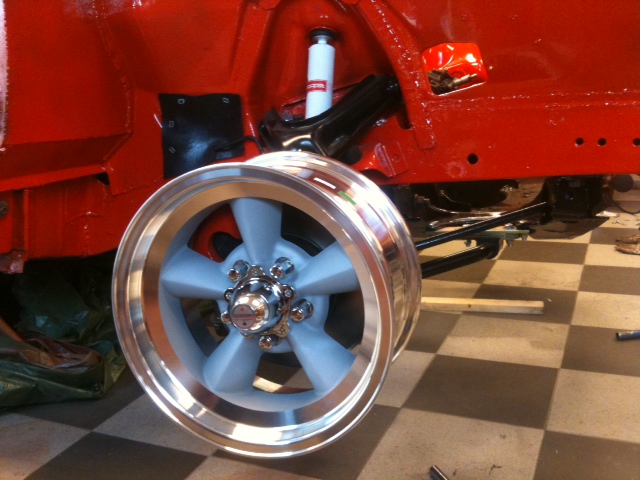

Back again after a week out of town, went to Svens house and Santa was early this year. Got my self a front sway bar and a new set of wheels and a lot of other parts.
I just had to try them on... Thanks again Sven for helping me with this!

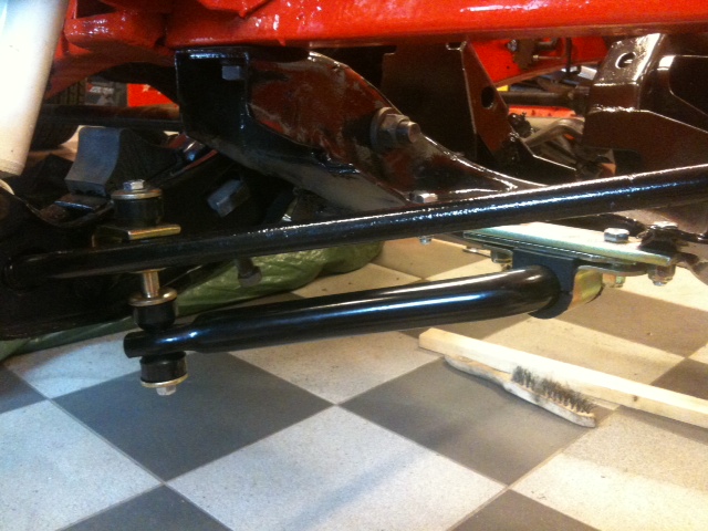

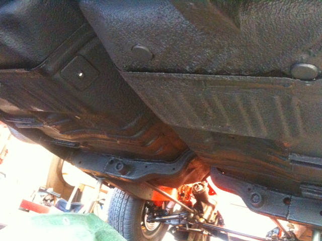

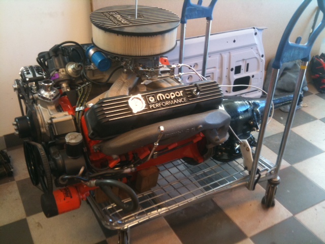

Thanks Uli and all other! Got some more work done today, new paint and "bodycoating" on the undercarrige. Put the tranny to the engine and realised that my flexplate is wrong, a new one is on its way.
It is pretty neat to have it together on the floor, plenty of space to mount the kickdown and throttle cable and get it adjusted, also mounted new PCV valve and crankcase vent, got my new pulleys from a guy in CA (from ebay) and they are nice, but all this small parts takes a lot of time, sparkplug cables etc...

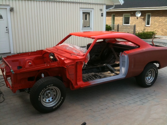

Update, blasted all the windows chanels, they were OK with almost no rust, painted the roof too because I did not have anything better to do.
I will put on the vinyl top in a year or two but it feels good to have it done, and it looks better...

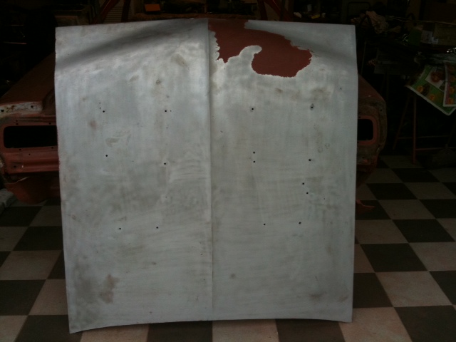

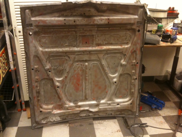

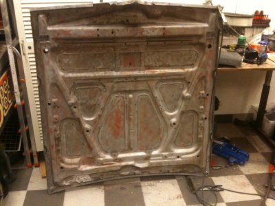

Blasted the hood too, it was straight with no bondo but with 15 holes instead, I will weld then and drill 14 new ones... Ran out of sand before I was done with it! Continue tomorrow.

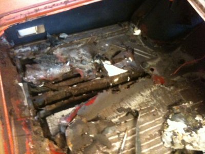

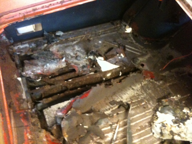

Took a bite in the trunk, damn it is rusty! Have to order more metal!

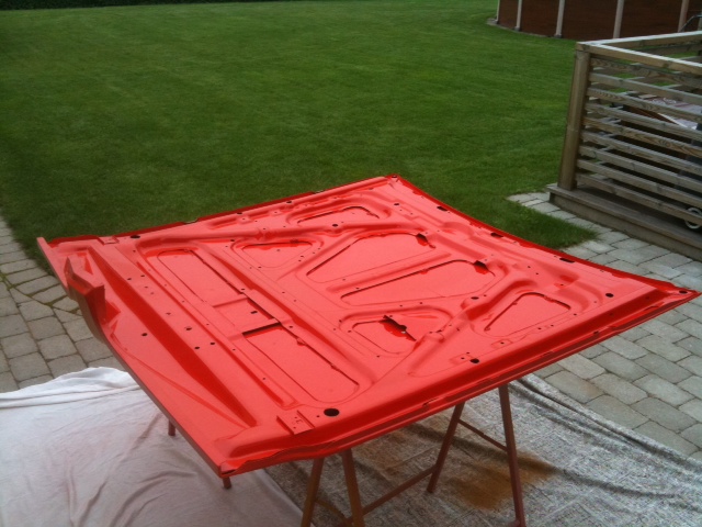

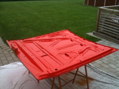

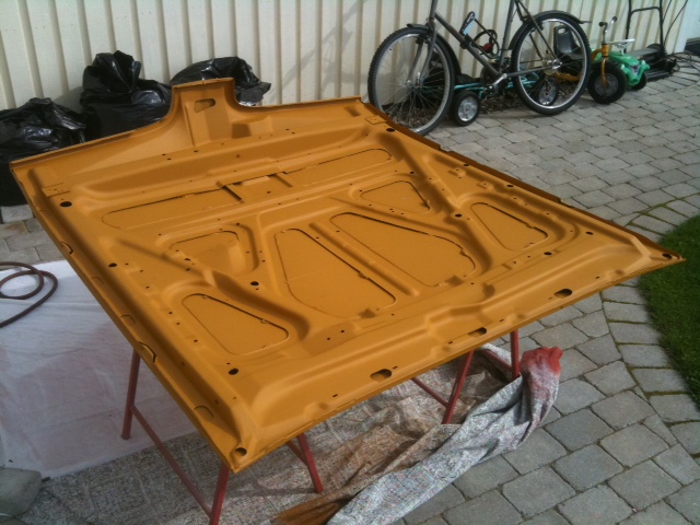

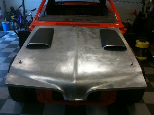

A good days work, hood has primer on both sides and inside is painted. All the extra holes are welded and the new ones are ready, missing two holes in the front, have not decided if I should put on a bee... I think they look so cool!
Also a picture of the trunk, say no more...
Found a paint shop 500 meters from home, talked to the guy and if we work it out I will only prime the outside and let them do all the work with bondo etc. It will save me a year or two...
it's a good color.will look good with the hood and scoops on it,
