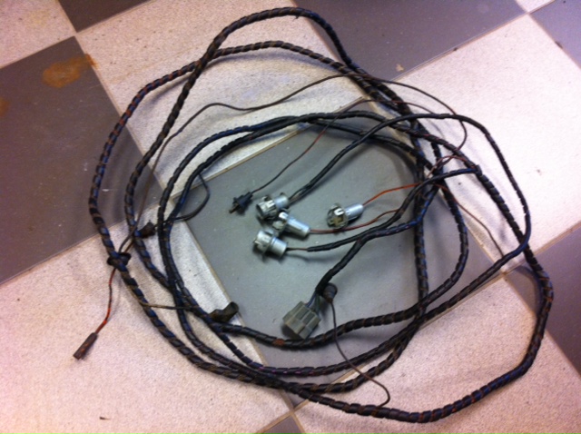

Did a minor resto of the rear wire harness, did some "long distanse blasting" to remove some rust and freshened up the connectors, put on some clear coat on the outside and shifted the small springs in the side markting connectors. I will also put on some dielectric grease so it will not rust again.
Also found a plastic spiral, not the resto look but it will protect the cables.

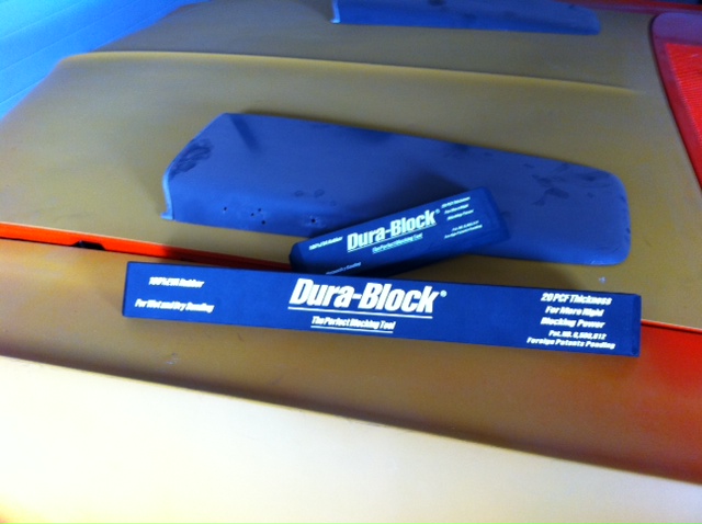

Had to drill some holes for the BEE in the front, just for fun, also mounted the N96 and I need to have them mounted during filling and grinding, the hood has some dents and without the sccops in place it will be impossible to get it right.
Lucky for me MR Spauldo sent me a pair of Dura-Block so I can start the mission impossible! Thanks once again Kent!

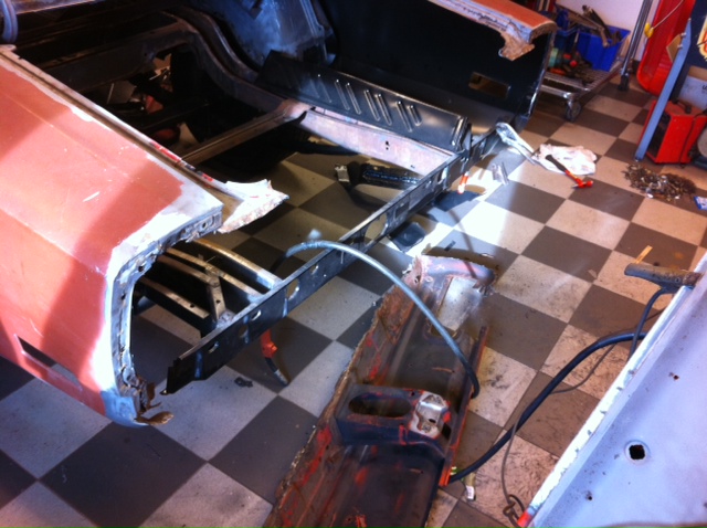

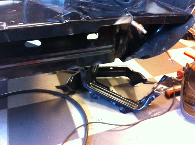

Replacing the inner wheel house (outside) without removing the quarter panel!
Some wise men put on a new quarter but did not replace the rusty inner fender, nice work, now I have to cut out the old one including 1 inch of bondo and cut in the new one and weld it upside down with a drum brake in my neck...

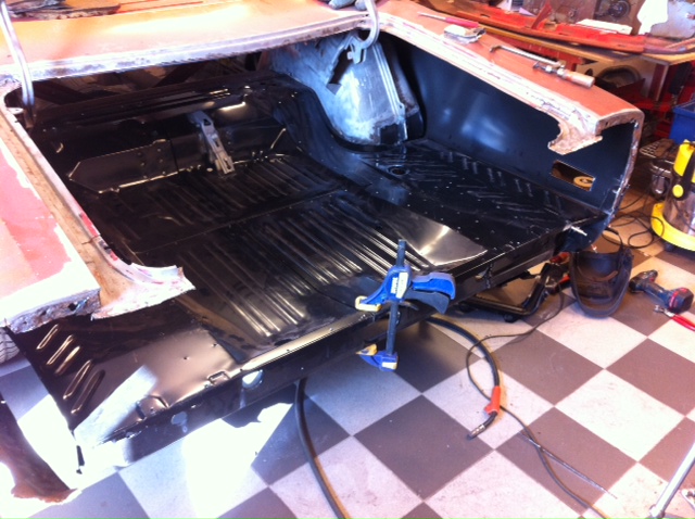

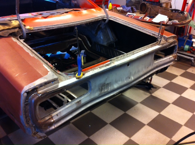

Good news, spent saturday working on the rear tail panel. Had to replace some parts and patch it a little but it is 1000 times better them the old one. Did some test fitting of the trunk and extensions too, much easier when the tail panel is not in place. Parts fits pretty well.
Hope to close this rustwork in a week or two, getting tired of the smell of dust from the angle grinder and burning skin...

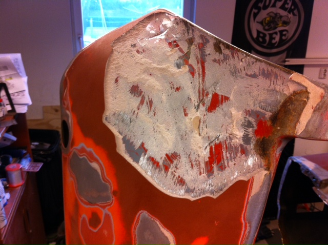

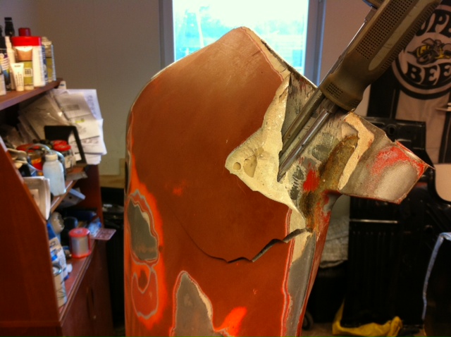

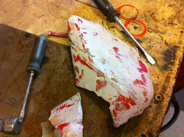

I have an announcement to make, we have a World record here in Sweden, I started to pry of a bit of bondo from the front valance, the piece that came of is over one inch thick and it weights probably 2 pounds, anyone has a thicker bondo repair on his car? And it is totally rust free behind, just a simple dent that someone filled up with bond!

When Opel in Malmö expand I was there and did the sheetmetal job, one of theres guy filled up a door with 7 cans plastic padding, I asked him why he didnt push out the dent, Ohhh its soooo much job to take out the doorpanels, IDIOT!!!!
Wow! That's an impressive lump of mud someone slapped on there....and how is shaping/forming 2lbs of bondo easier than poping out a simple dent?
well,with that off the car will be lighter and probably get better fuel mileage now.

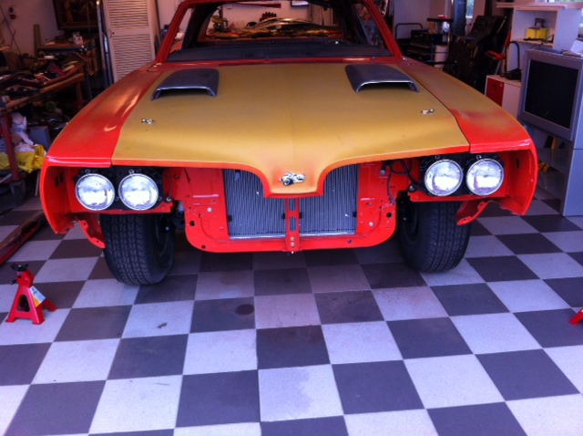

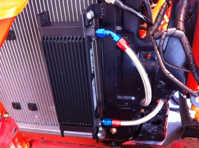

I am so tired of welding so I spent most of the time in the front, mounted a new tranny cooler, it is a Setrab that is made in my town, no chinese crap here! Made a ridgid bracket and connected with Earl´s, it is a feast for the eye :icon_winkle:

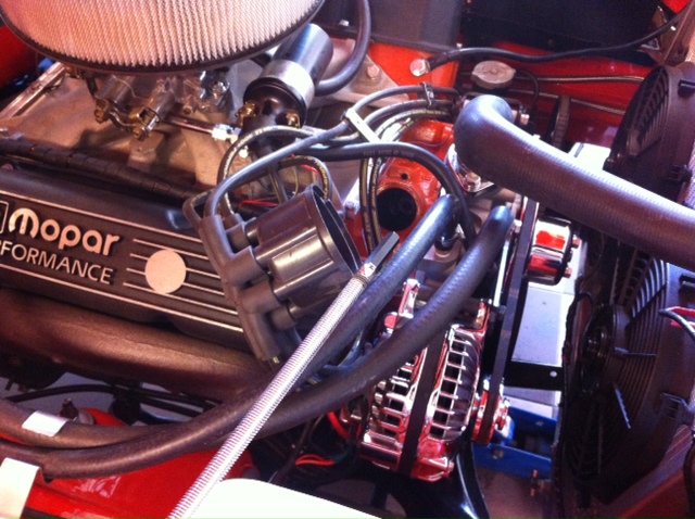

I bought a new ministarter on eBay, damn what a difference! It is twisting that 383 like it had no spark plugs compared to the old one.
The only thing left for startup is to connect the exhaust pipes and do a cardiac examination of myself, and add some fuel of course.
