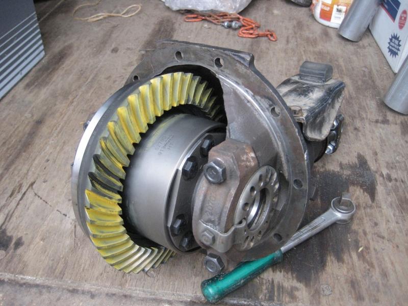

That yoke looks like something I had here and I bet you have 3.91 gears in that rearend....
Do you mean this one I bought from you? It's going into mine 68 GTX.
That must be the new Eaton you got in that picture?
Hey, what can I say...right country, wrong Swede! Glad you got them home!

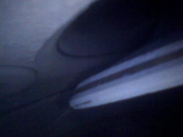

Got myself a small usb camera from China and took it for a tryout in no 1 cylinder, works OK, not like something a surgeon would buy but for 15 bucks...
It´s got 4 LED lamps that is adjustable,

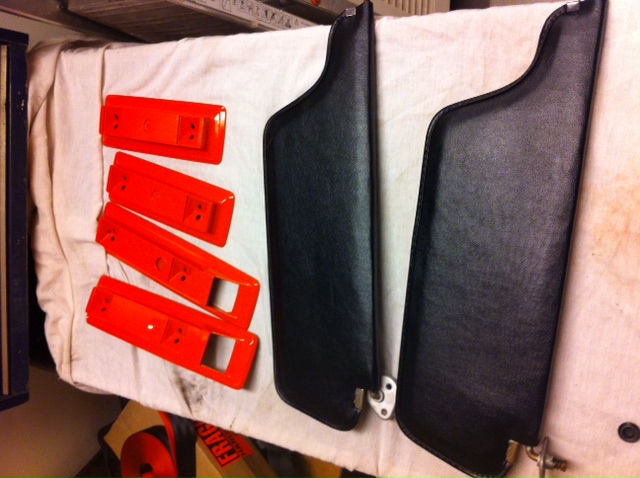

A minor update, ran out of welding gas and decided to try my new vinyl paint for the old white sun visors, I spent lot of time cleaning them from Armor All and all other stuff they have used on these parts for 40 years, finally I took a 400 grip sanding paper and rugged the surface. The result was really good, time will tell how they will look after using them.
I also color matched the arm rest bases that all the chrome was flaking of from, wet sanded them and first primer and then bodycolor, mayby it will be to much but then i can always buy new re- chromed ones, this one is worth a shot, will break off all the black in the interior. With the padding on they look pretty nice.
