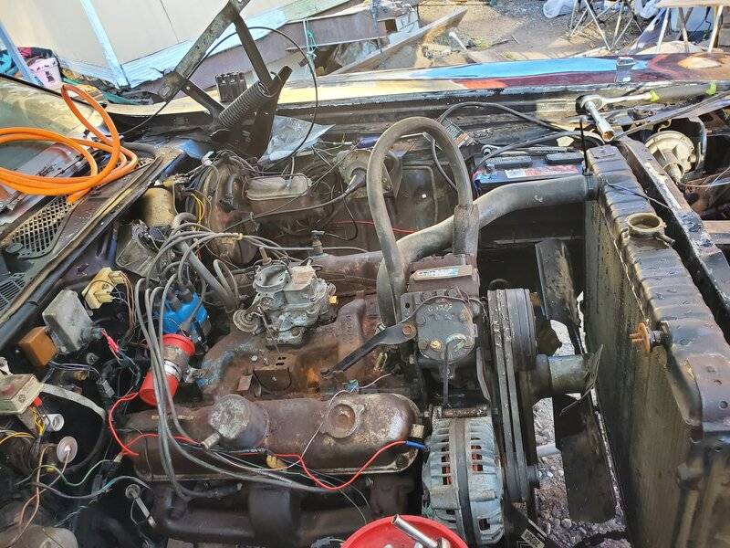

I only see 2 freeze plugs in the pic,
Ok cool makes life easier i got a plug kit and It came with all those small ones.The big one in the middle is the camshaft. Leave that and the small plugs alone.
I can only find 2 on the front of the block is it under the water pump?Do all of them while you have it out.
4 on the heads
3 on the front
2 on the back
6 on the sides
As mentioned use deep brass plugs.
Flush out the block after all are out.
Clean all of the muck out of the side ones.
Clean all the bores out with Scotchbrite and fine sandpaper.
Use Indian head gasket shellack to seal the plugs when installing.
Ok good. I'm going to put the motor back in and use father's day to get her up and runningNo, my mistake.
Only 2 on the front of the block.
No after I get her up and running I plan on a cam and head upgrade. I'll paint thenDid you order your corporate blue engine paint yet?
can you borrow or rent a radiator pressure tester?
I try that tonight ill let you knowWas it leaking before? You could of cracked the block when you dropped it! Alot of stuff could if happened. I guess the cheapest way to check without removing eng again us to pull heads and fill the water jackets up see if water runs out below.
