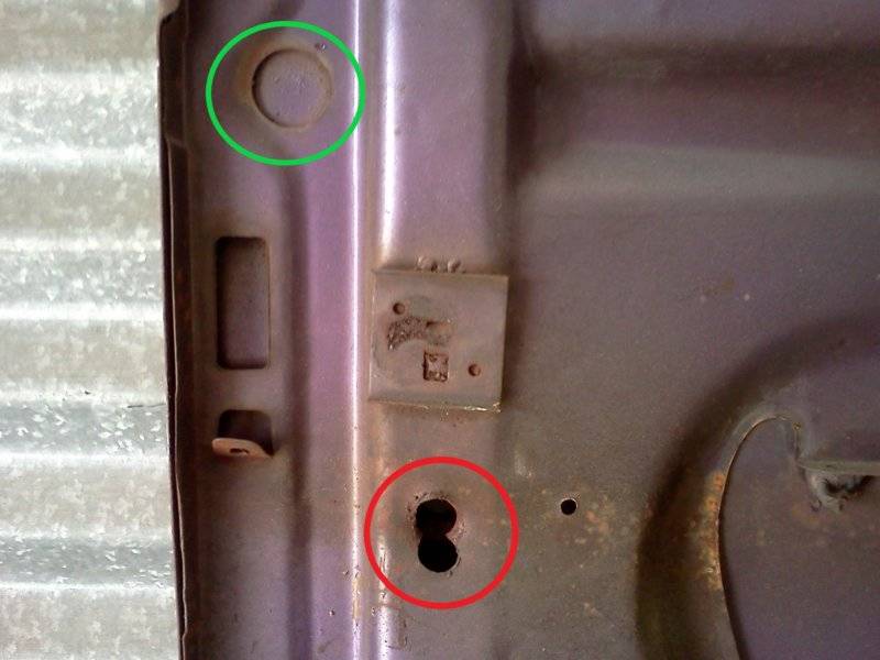

My peve about hood pins

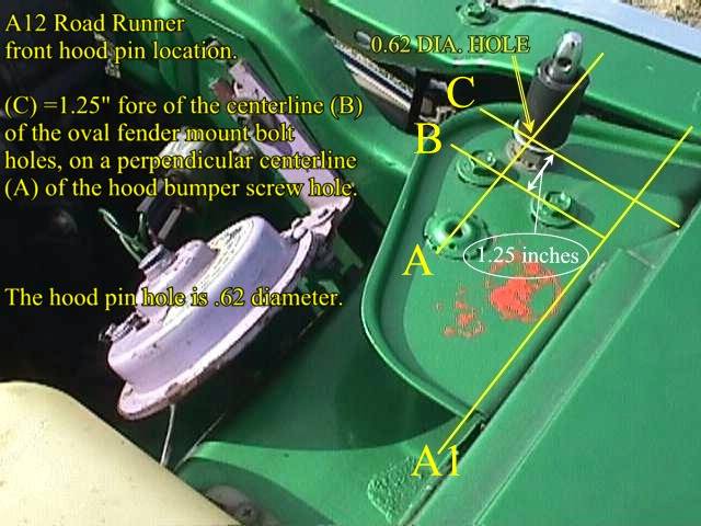

pre-made locating stamp and cut-out from the factory with corresponding mount pad below it...
...and people still get it wrong.
Half the work is already done for you.......
Meh. Mine were drilled directly above the adjustable bumpers so I kept them there. Welded the pin to the top of bumper.
Don't buy someone else's screw ups. Problem solved.
Curious, may be a dumb question but , is there a locating mark on the fender flange? Any pics of it?
There is a mounting pad on the fender flange, aligned perfectly with the locating hole on the hood.
Not sure how so many folks get it wrong, but they do.

What year are you referring to? Mine is a 69 and no locating marks on hood or fender . I would like to know the correct spots as I’m installing the 6bbl hood on mine
Well.... some folks like myself just don't drill holes in our hood because Mopar said drill here. I spent a lot of time moving the plates around where they would correspond with a good location beneath before finding what suited me and it wasn't there :poke:, to me I just don't like them on the edge. The sloppiness in your post is what's bothersome not where they are.

I believe some models have an extra bracket that is not present on non pin equipped cars.
I also believe a simple substitute bracket could be made of heavier gauge metal to locate the pins in the factory position, aligned with the area on the hood, already prepped for them.
