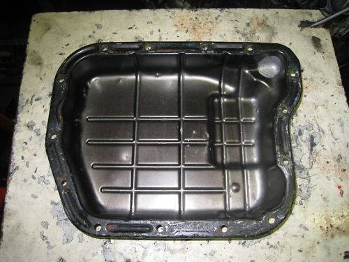

Looking for suggestions and knowledge on the BB 727. I've got some leakage and I don't know if its the pan gasket or something else but the trans is leaking fluid. It's covering the whole pan and dripping and seems to have been for a long while. The car is a 68 Coronet RT, I have no idea when the filter or pan gasket was last changed. It's been sitting w/o starting since approx 2003 so I'm thinking even if it's not leaking from the pan gasket the fluid and filter need changed and I'd like to have a easier method of changing the fluid with the drain plug on the replacement pan.
Any suggestions on an improvement in the pan?
I've read a stock 518 pan is heavier duty, stronger, etc with more capacity but this doesn't exactly look like it fits ??. As far as the drain plug I could put one in I suppose. Don't know if filter extension required.

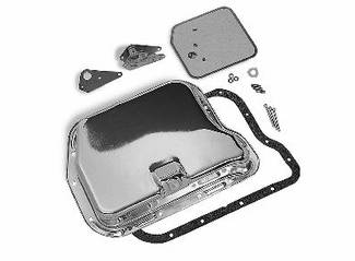

http://www.jegs.com/webapp/wcs/stor...EAR=1522949&MAKE=1523433&N=1523452+4294966021
http://www.summitracing.com/parts/hup-hp1580/overview/

I think having a discussion with your original pan on a flat wood bench with a hammer will straighten it out (pun intended). Yes, a deep pan will need a filter extension. And I will say that your pan in the pics appears to be deeper than stock so you must already have a filter extension??

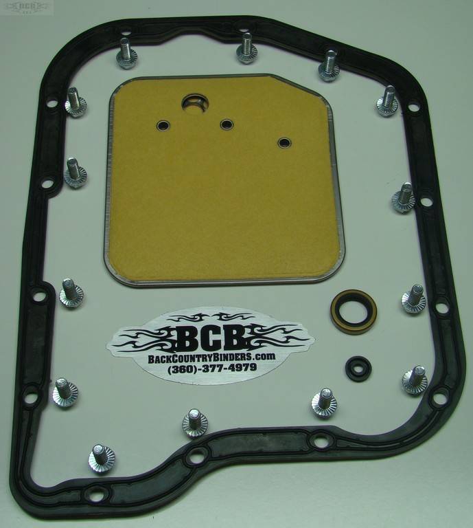

I'm planning to start the Engine and trans pull this weekend and will check it out real good. Found this gasket kit. Sorry for size but it's a linked image so I hope it doesn't bother mobile followers. It looks like it addresses all the possible leak areas you mentioned and is supposed to be good for sealing.

is the hard mopar gasket in the bottom pic the one you and others are talking about?
