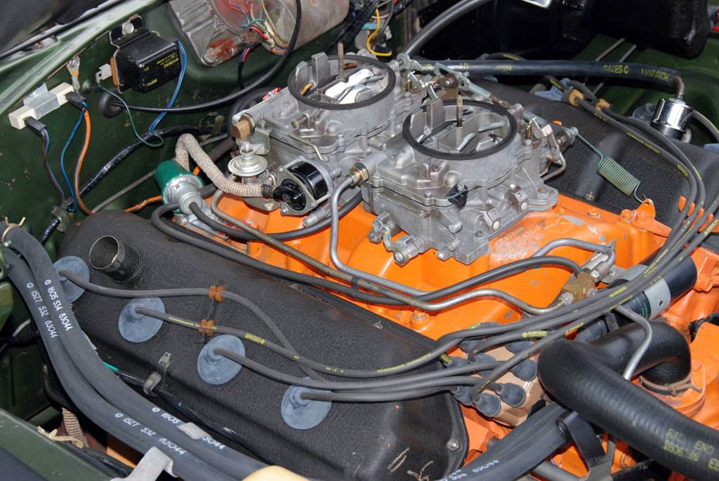

From the "other" board. A '69 hemi GTX (not my car).... That's the airgrabber cable just below the VR.

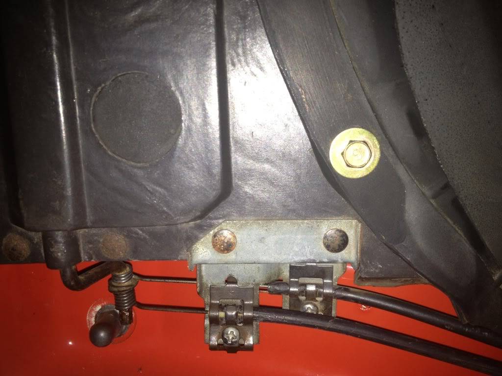

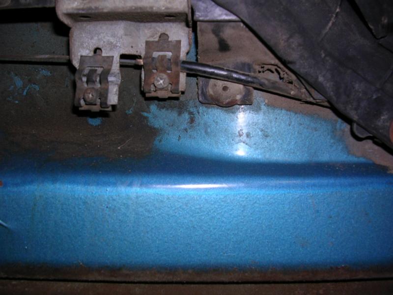

Here ya go. The cable from the fire wall goes on the passenger side where the double retainers are.

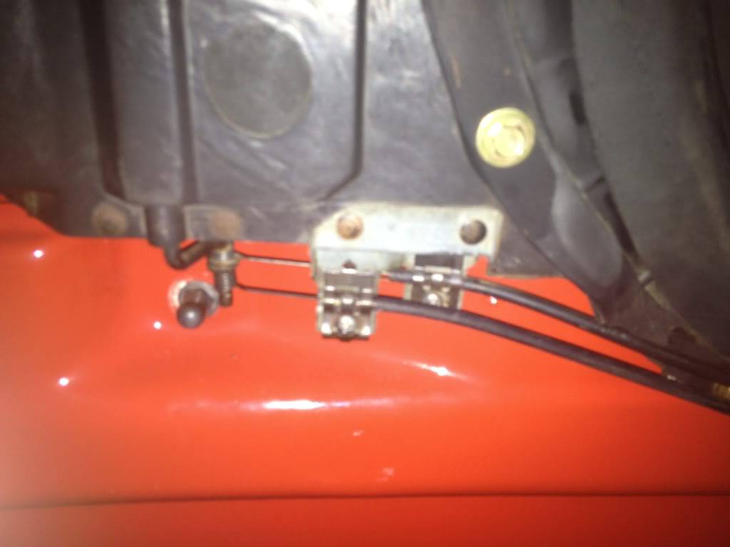

Where is crossover cable? Can you take a pic so we have more of a view of routing?

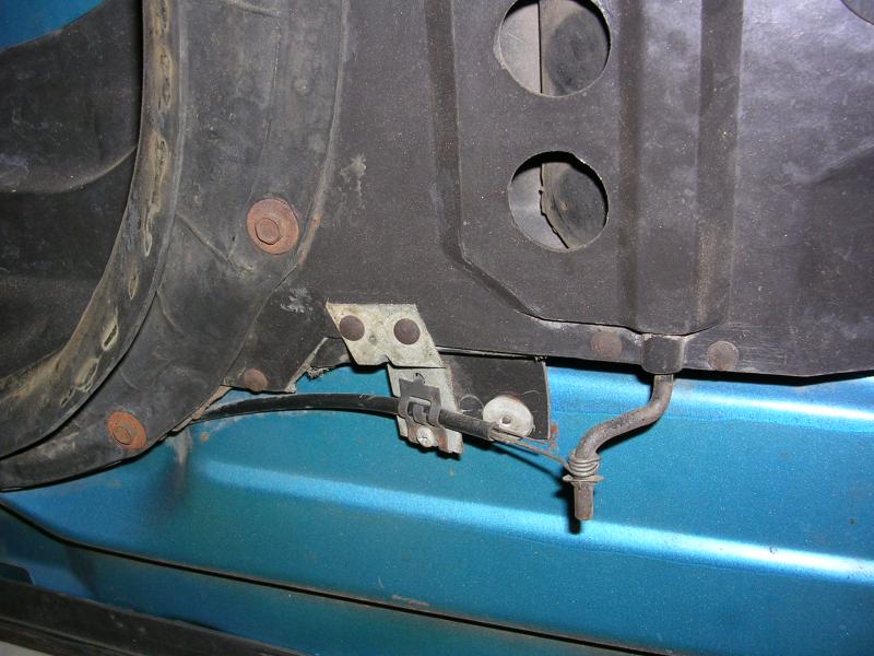

Here is a pic of mine, no extra cable outside of the fire wall. The pull cable attaches to the passenger side and is the lower cable. The cross cable is connected at the same point and is the higher cable.
I think the Clips are the same as the ones used on the heater control cables. I found some used ones on ebay.
