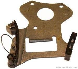

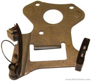

Also any SBM V8 weather LA or magnum benefits from the automatic chain tensioner that the magnum 3.9L V6 uses. This tensioner setup takes the place of the cam thrust plate. If you havent seen one of these, it spring loads a teflon shoe on either side of the timing chain preventing chain slop and timing irregularities. MP sells it for $45, but you can find em for about $33 on evilbay.

Tech tip. Use engine tech TT387 cloyes, or similar about $25 -$35 for dakota 1990-1993 magnum 3.9L V6 also fits LA and magnum V8. I recommend drilling an 1/8" hole in the thrust plate of this tensioner over the drivers side lifter gallery end for chain oiling or use the hollow drilled bolt that goes on that side for the same purpose. Prevents chain slop and bouncing timing or jumped chain as timing set loosens up from use. Even true double roller chains get sloppy after some miles. Pull ring in picture on left side is to allow for chain setup, then it gets removed to allow tensioner shoe to rub the chain. Only better way than this is an expensive gear drive set.
