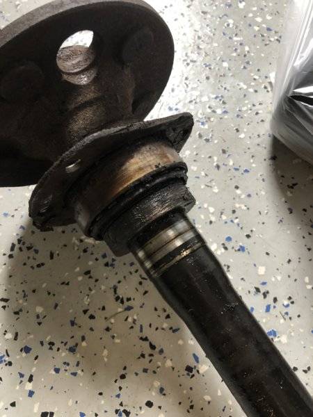

First of all, your car looks amazing. I did buy new seals and bearings, but after looking at what needs to be done to replace them, I think I’ll take your advice and repack them . I did notice there is some slop between the outer flange and the bearing. Is this normal? Probably about 1/31” of space there
Gotta be some slop for assembly. Push the bearing into the cup.. rolls nice?.. flush some gas through it to clean it and repack it. Put it all back together. Of course the issue is that you cannot change the outer seal without removing the bearing, but if there are no signs of grease leakage on the brake backing plate you should be fine!

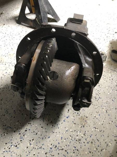

Well, got everything out. Would love to replace the bearings, but after reading how to get the old ones off, I think I’ll just repack the ones that are in there. They seem to roll fine

You're going to end up with a partial pack unless you remove those bearings.
Nothing wrong with that, but I wouldn't try to get the old grease out- just add to it.

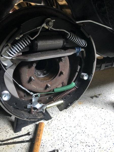

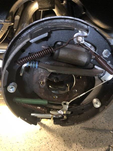

Something doesn't look right with those brake self-adjusters.
The green spring looks contorted in the first pic and comparing the two pics makes it look like those green springs are attached differently side to side.
This would be a good time to verify the assembly and test the operation.
use your thumb to pull out on the silver braided cable and make sure the self adjuster actually turns the star wheel and it doesn't go back.
I see the same as YY1 on the adjuster, cable looks loose ? but the second pic the backing plate is on its way off the axle ? Nice Floor by the way:D, anyhow if the bearings seem to roll fine and are not chipping or galling get a needle tip for your grease gun and a tube of wheel bearing grease.
Its just like a kid playing in the mud LOL. use a old hair dryer or heat gun on low will help the grease flow down into the bearing while the axle is standing upright.

...the two pics makes it look like those green springs are attached differently side to side....
Kinda' appears like 2 springs competing over the same hole. The bottom picture looks like the green spring is relieved since the shoe is off the pivot point and shifted up.
Is the green one supposed to attach from the inside?
The bottom red spring(by green) is not the right spring imo. Also the one blue spring on e-brake strut is kinda cocked in upper pic, should be a little relaxed like the lower pic of opposite side.
If grease is "flowed" into a bearing cage, IMO there is not enough grease.
It needs to be forced.
That's why leaving what's there alone might be the best course of action.
If the OP cleans out the grease that's there and can't get enough new grease in, he's F'd and the bearing will fail.

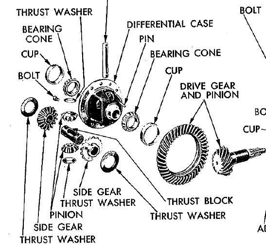

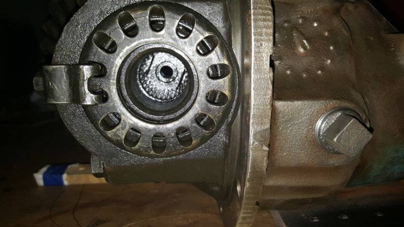

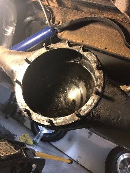

Thanks everyone. I will definitely check out the brake situation. I was thinking that there’s not much meat on those pads for supposedly being new. As far as packing the bearings, there wasn't much grease in there. I spent some time pushing bearing grease into the bearings and feel like I got them pretty full. I’ve had a couple of folks warn me about this center space in the differential. Where am I looking at to make sure it’s still there? I was very careful pulling the differential out and did not loose anything on the floor or inside the case
you can see the spacer looking from the side, look through the bearing were the splined axle end goes, there should be a spacer { round steel dia. of the axle } in the middle of the chunk.
that gives the axles something to bump up to , if missing you can not get your end play set for the bearings

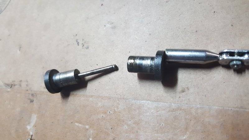

1967 Coronet is talking about these. They are normally held together by the thin pin. Sometimes the pin breaks and you'll find the button on the end of your axle or in the housing or housing tube if it falls off when removing the axels.
In this view the button is missing...
Get yourself a service manual and get those brake springs where they belong. I've never seen the one spring that's going over the adjuster to that pin before. Never have seen that pin located there.
1967 Coronet is talking about these. They are normally held together by the thin pin. Sometimes the pin breaks and you'll find the button on the end of your axle or in the housing or housing tube if it falls off when removing the axels. View attachment 788475
