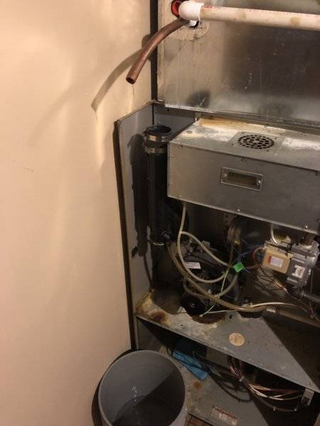

Had to cut the drain to get the cover off so I gotta fix that, didn’t think that one through then water started pouring out lol. Panicked I guess.
