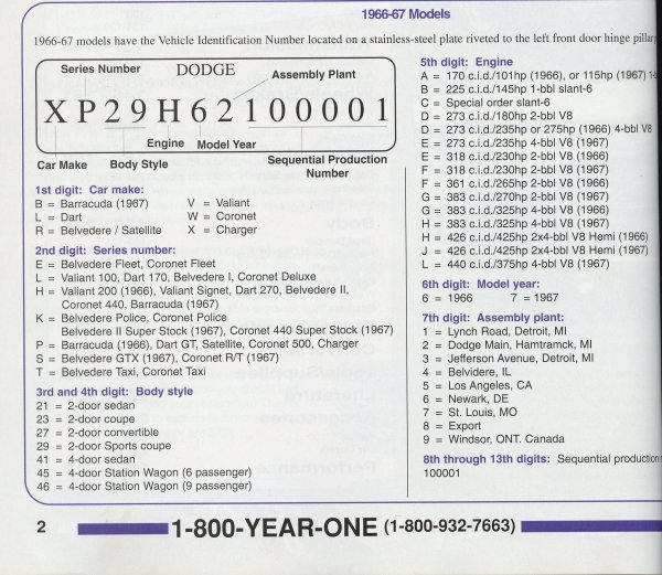

Wonder if someone might help me with numbers on a 67 Coronet I'm going to look at.
Guy says it's a "Coronet 440" What would the first 4 of the vin. for a "Coronet 440" model? I know a RT is WS23.
Engine codes are: again I believe "J" is 426 Hemi, what are the other engine codes for the 67 year??
Thank You!
See attachment
