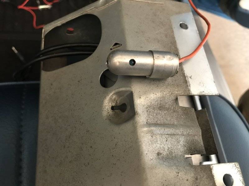

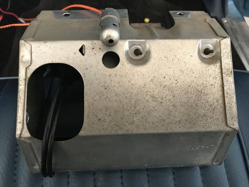

It’s been a while since I removed my ashtray. Is this attached and pointed in the correct direction ? This is backside of encasement. Not that it matters cause I can’t get half of my damn accessory lights to work, lol !
The small hole pointing up is the light that shines into the ash tray, and the big hole is where the metal bulb assy pokes thru. It needs to be removed and reattached from the inside of the housing. This will make the small hole point down.
Sorry, it has been 30 years since I did mine. The wire comes out of the small hole in the housing, and the wire for the lighter element comes out thru the large hole. The light housing clips into the tray housing facing the ashtray (inside of car). Here is a pic from the internet...
