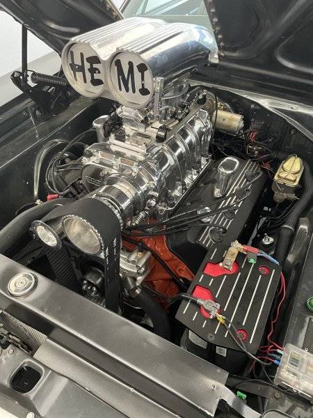

I am trying to adjust my rockers on a 426 Hemi. It has hydraulic lifters. It was running fine until I decided to adjust them while I had the valve covers off. I have the picture of which valves to adjust after each 90 degree turn. Tried that and now runs like crap and won’t idle. I don’t have a balancer, but it has a crank hub (6-71 blower) I set it to TDC on compression and adjust intake 2, exhaust 8. Now my issue is the next 90 degree turn. I used the 37 tooth crank pulley and made a mark every ninth tooth. If I turn it clockwise every ninth tooth, should that give me the 90 degrees to adjust the next set of valves? I’m having a hard time with this. If I had a 7” balancer and calculated 90 degrees on that, wouldn’t it move it further than a 4” crank hub moving 90 degrees? Anyone have an easier way to do this that can dumb it down for me? Thanks
