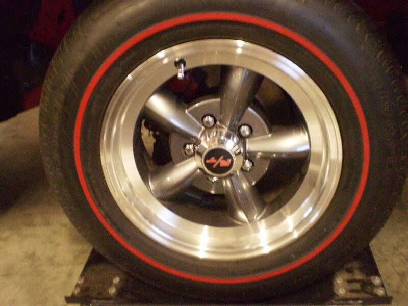

Here are rims that I am running on my cars. Both sets are 15" X 7". The Magnum 500 looking rims are actually 1-piece aluminum rims. The black detail is powder coated, center cap is plastic. They are lighter and less expensive than steel Magnum 500's. They are sold here in Canada by Golden Leaf Automotive, but I bought mine at a local swap meet for $100.CAN each new still their boxes. I couldn't get my $$$ out fast enough! They are going on my '64 Polara.
My other set of rims are for my 1967 R/T. They are a Torque Thrust knock-off sold by Jeg's Speed shops. I paid just under $100.US each for them. I found the R/T stickers online and they were same size as wheel center hub cap. I am not sure of back spacing, but they clear disc brakes on both cars. I am guessing 3 1/2". Tires are 215 R 70, about 26.5" tall. It is getting harder to find big 14" tires.

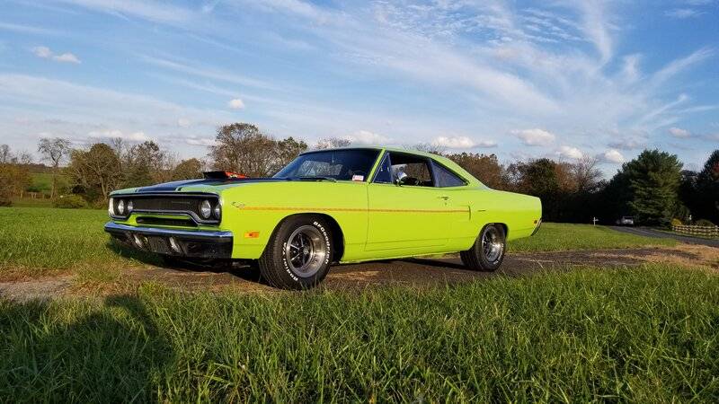

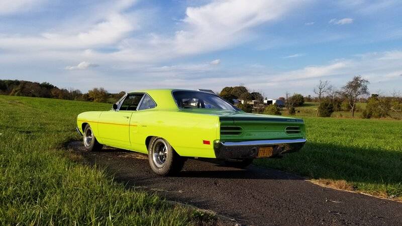

For 15 years I had 225/60-15's on Magnums across all 4 corners on my '68 Charger. It was a great balanced look that filled the wheel wheels without looking too far off stock. Recently I upgraded the rubber with 255/60-15's on the back. Jury is out for me. The back hooks up much better now (manual, 3.55 gearing and 380 HP on the dyno) whereas the 225's loved to spin. However, it now has a slightly aggressive stance which wasn't the look I was going for as the Charger looks stock to those that don't know better.

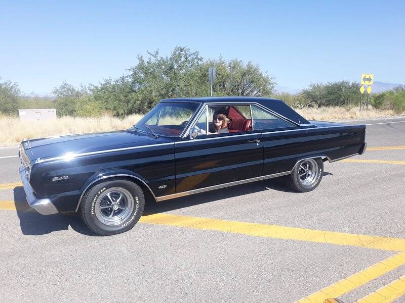

My car has 15x7 chrome magnums and 245-60-15 tires
Currently BFG TAs,,,,,,,,But thats about to change as I have redline radials on order from Diamond Back

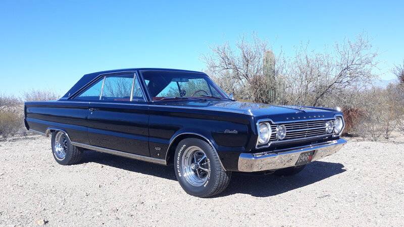

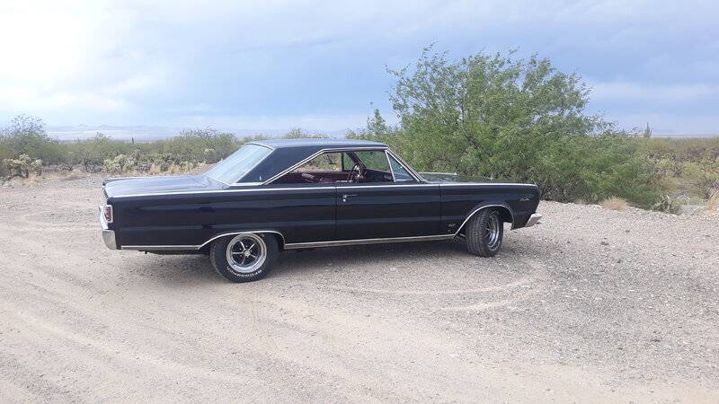

I have 15x8 (4.5 backspace) wheels on all four corners. Tires: 245/60R15 on front and 275/60R15 in the back. No rubs, full turning lock to lock on the steering with no issues. Here are two pictures for reference in case this looks good to you.
