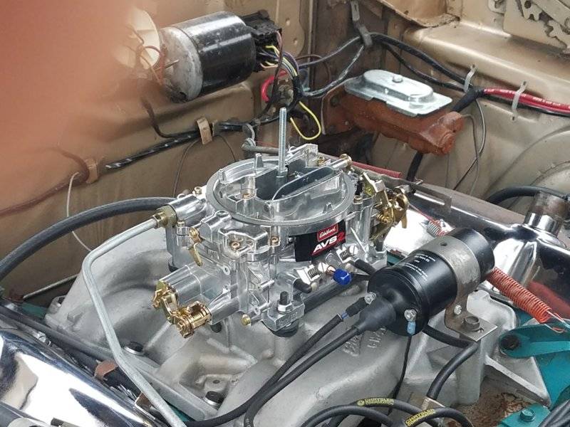

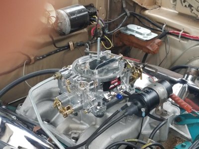

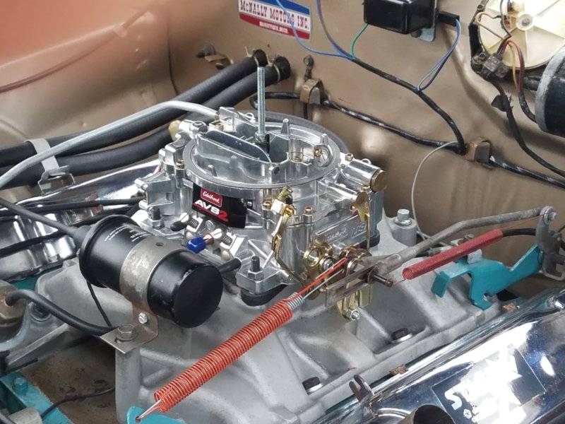

      I installed my 800 AVS/2 a few weeks ago,haven't tried it out yet,maybe this coming weekend.I'll let you guys know how it goes ASAP.I had a 1407 750 on it before,it worked pretty well with that on it.

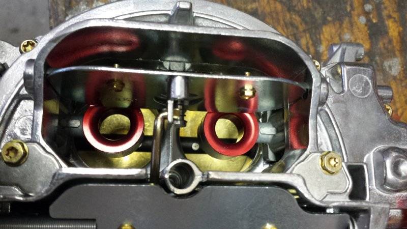

        Looks nice.
        Usually when you put an annular discharge booster in place of a conventional booster, everything else being equal, the annular booster usually reduces total flow. Do you know what might be different between the regular 800 AVS verses the 800 AVS2 to get the flow back?

        The 1406 is only a 600 cfm Performer Series
        Big difference
        What motor and specs did you put the 800 AVS2 on ?

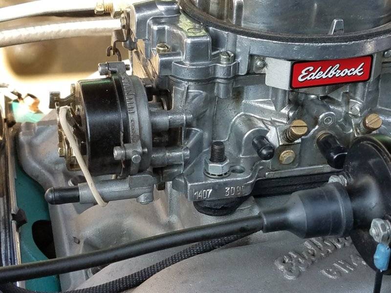

        My mistake,my old carb was a 1407.The motor is a stock '74 440 HP

          My rejetted , springs , metering rods , larger nozzle on the 1407 , was told to drill this that , bend this , throw it in the garbage LOL
          Anyways i ended up putting the factory Carter AVS back on
          Then i bought a Edelbrock 800 AFB - Was night and day difference going with that right out of the box compared with the worked over 1407

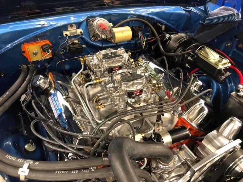

            I put 2 650's on mine. Runs great so far, response is crisp.

              I finally got a chance to drive the Coronet with the new 800 AVS/2...It does have noticeably better response at light throttle settings than the 1407 750 it replaced.It doesn't seem any faster,(I didn't figure it would be),but for regular driving & cruising it feels like I don't need as much throttle as I did before.Hopefully this will mean better gas mileage.I was going to check MPG but about ten miles into my ride the dang odometer quit counting (always something, right?).Anyway,I'm pretty pleased with the way my car runs & drives with the AVS/2.

                you don't need "as much throttle" with the 800 because the 800's primaries are noticeably larger than the 750's. the edelbrock website says these carbs can be bought direct from edelbrock. also, from the website, it appears that edelbrock ditched the big jets on the 800avs2. not sure about metering rod changes.
