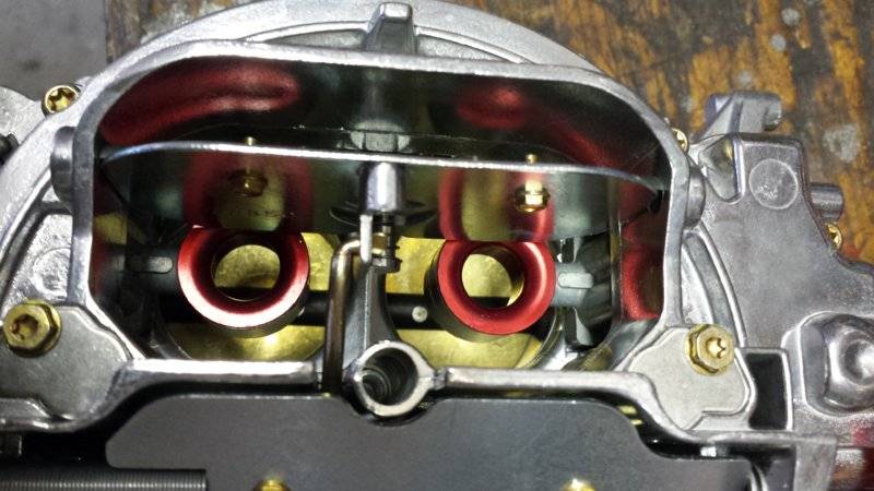

    you have to figure jet area. the cruise area for the 1812 is .00637. the cruise area for the 1912 is .00518. I worked on an 1813 a few years back and ended up with .107 primary jets and 70x47 rods with .104 secondary jets. cruise area was .00515 and WOT was good. so, the newer jetting for the same size carb confirms the tune up I did. one thing I did to help tip in was get rid of the big squirter. I used a .024 and this set-up drives great with very responsive WOT. I always believed to 750's and 800's were way too fat and the over rich condition contributed to the hesitations.
  2. lewtot184
    lewtot184 Well-Known Member
    Messages:
    4,637
    Likes Received:
    2937
    Joined:
    Aug 21, 2011
    Location:
    indianapolis
    Local Time:
    4:57 AM
    that booster looks good for the large venturii.

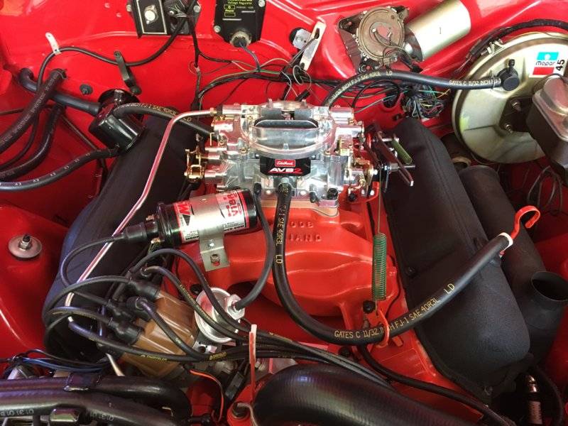

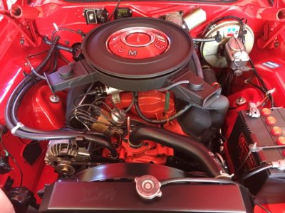

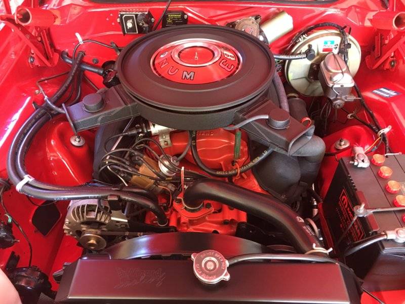

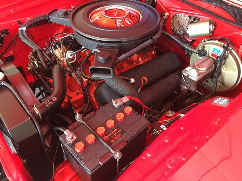

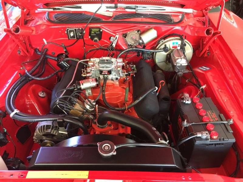

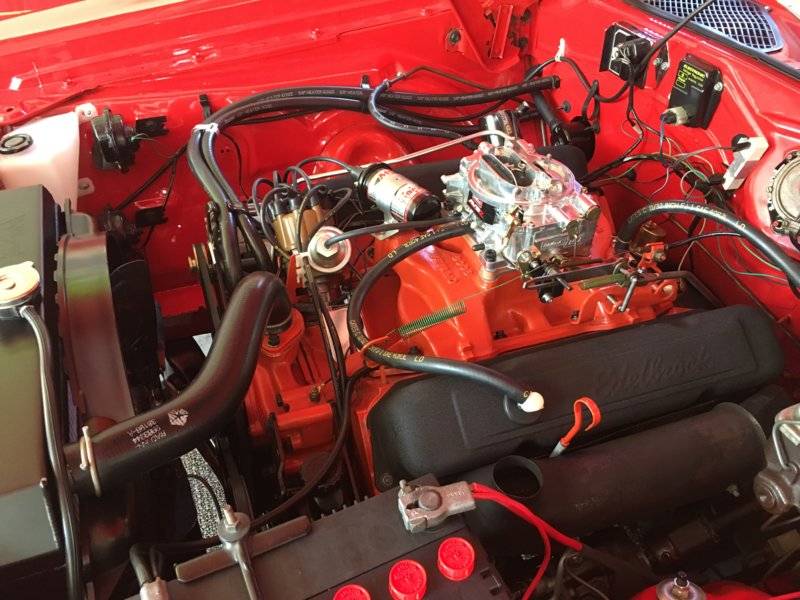

        #s 383 Magnum/432 Stroker that I built last year
        Factory Exhaust Manifolds
        AVS-2 installed this week
        1912-800cfm
        Installed a Edelbrock 1/2” open spacer at the same time on top of the Weiand dual plane
        Replaced a very clean 1970 Carter AVS 440 HP-750cfm that I had setup pretty decent and tuned over with Edelbrock jets/Metering rods/Covers
        Honestly I thought it ran pretty damn good before
        WOW - Throttle response down low off idle is scary responsive - Add 20/30 mph into the throttle and the Auto Trans 3:91 Sure Grip is going sideways
        Cruise is great
        Only thing I did so far was set the air screws and idle
        The air door is set up on the light side , will tighten the spring up next a tad and go from there on metering rods and jetting if needed
        Very happy so far with just a few quick cruises
        Starts and idles Awesome , but so did the Carter AVS that it replaced

                      Give us a comparison between the two after you install the 800 AVS 2 versus the 750 AFB
                      I bought mine a year ago and posted earlier in this thread
                      Since then
                      800 AVS 2 - Running .101 Primaries / .104 Secondaries
                      .065x.052 Metering Rods
                      7" Pink Springs
                      Re-Adjusted float levels from 7/16" to 5/16" - Float drop 1"
                      Removed Choke Hardware
                      Factory needles and seats
                      Awesome Awesome Carb
