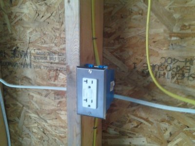

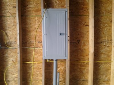

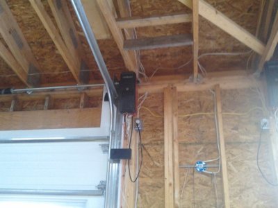

I passed the electrical close-in inspection on 10/17/18. Only needed to install a single GFI at the first receptacle on the circuit to pass.
Also installed the entire circuit for both garage door openers.

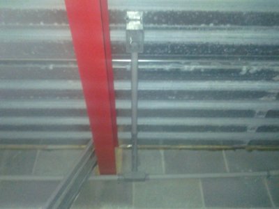

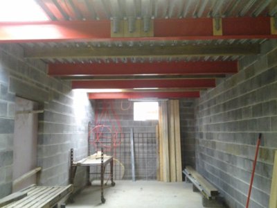

I have all of the lighting circuit completed in the basement in 1" PVC. It will allow for (6) 4' LED lights to be installed on the bottom of the metal pan decking. 6 lights for a 12x40 storage space 9' 6" high should be plenty.
Electric 7.jpg Electric 11.jpg Electric 6.jpg View attachment 672130 Garage Basement Electric 1.jpg

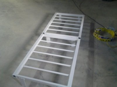

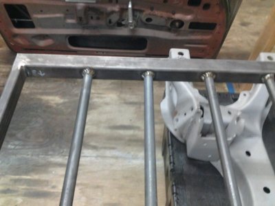

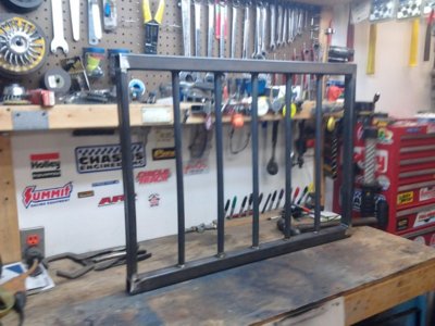

Where the basement windows are at ground level I decided I wanted to make bars for them so they couldn't be broken into.

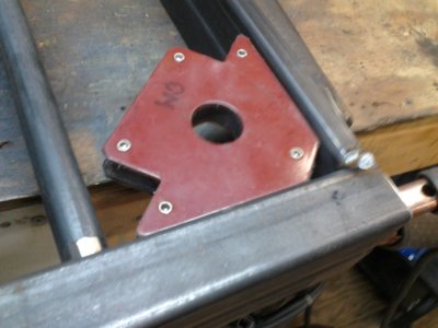

I fabbed the bars up last year from 1 1/2" box at the top and bottom with 3/4" box at the sides.
I installed 3/4" solid bar stock 5" on center drilling the top and bottom bars and then assembling everything and welding it together. Finally got primer and paint on them for installation behind the basement windows. I still need to install the PVC Trim around the window frames but there sure isn't much daylight left when you get off of work at 4:00...

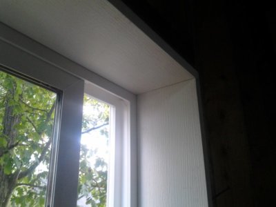

Since I can work inside I started installing the trim around the inside of the garage windows...the balance will need to be completed once the drywall is finished and painted...

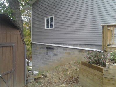

Completed the down spout for the SWM system to capture the water from the back side of the garage roof...

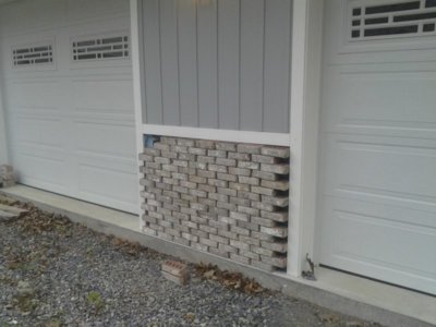

I have a mason coming Saturday to install the brick at the 3' 6" high openings beside the garage doors...
I know I didn't get any work done all summer but I did manage to get flowers planted around the porch in the spring...:rolleyes:
PVC window trim 1.jpg PVC window trim 2.jpg Basement Door.jpg Back down spout.jpg Brick 1.jpg 0921181915d.jpg

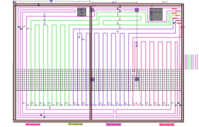

I have 2" Z Furring and 2" rigid insulation to install in the 3 exterior walls in the basement...
The sooner I can get that completed the sooner I can get into building the panel for the in floor heating and sorting out what I want to use for a heat source...The pex is in the concrete ready to go with 4 zones...
Leaning towards a propane tankless water heater...I have no access to natural gas on my road...

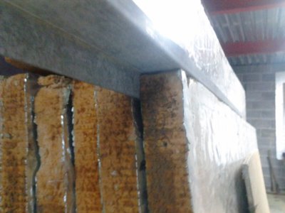

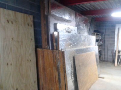

I started installing the Z furring and the R-13 Thermax foil face insulation in the basement.
I ripped down 2x6's into (2) 2" strips and tap con-d them in around the window and door openings so I have a substrate for trim...
It's really time consuming when your doing the framing, insulation and electrical all at the same time...But it's also one and done...
The west wall is finished minus going back and taping the seams...
This wall will have plywood attached and become the area where everything for the radiant in floor heating will be attached.
On to the back wall where I also need to incorporate the electric boxes and pipe...everything is 1" PVC with 12 gauge wire set up for a 20 amp circuit.
About the time I get to the back door I'm looking at this and thinking maybe I don't want to install anything on the face of the framing after taping the insulation...
It's very reflective and actually brightens everything up a lot...
I used the sheets laying down in a full 4' x 10' length and installed the first one on a Z furring channel at the floor and the second sheet against the bottom of the steel beams. This created a chase in the wall that allowed for the PVC pipe for electrical to be installed in.
Once insulated and taped it is the finished product.

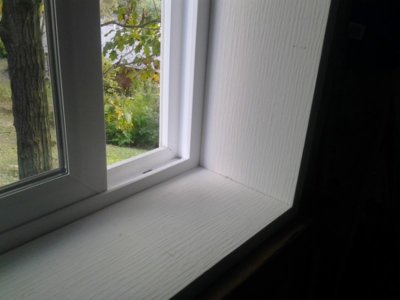

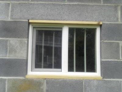

Supposed to be nice yet tomorrow...I may try to get outside and install the PVC trim on the basement windows while I still have daylight...
West elevation window is 100% complete...
The PVC trim is a little harder to work with but makes for a nice finished product without any painting...
One down one to go...The trim for the east is cut...should be able to install it tomorrow night...pending no rain...
The mason came Friday and installed the brick at the front elevations between the doors and at both ends...

I also finished the insulation at the south and east wall and added it the electrical piping for the compressor...along with the trim inside the basement window sill...

I have 1200 L' of 1/2" pex in the floor...I need to figure out what the volume of fluid inside the pex will be at some point. It is set up with 4 zones each 300' long.
