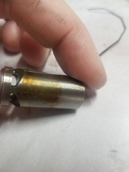

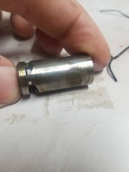

I've seen the same thing happen with a stuck pressure relief valve in the oil pump. Oil would flow, but would not come out of the oil pressure port on the back of the block. Basically, you have flow, but no pressure. The relief valve is an easy check, since the pump is external. Just remove the large nut, then the spring, then the valve is behind that. It should move freely. I always take new pumps apart, clean, polish the valve, sometimes honing the bore if it's too tight. Assembly lube all parts before re-assembly.

This was my first thought as well and the reason I changed the oil pump. However after installing a new pump the problem still exist. Here are a few pictures of the old relief valve.

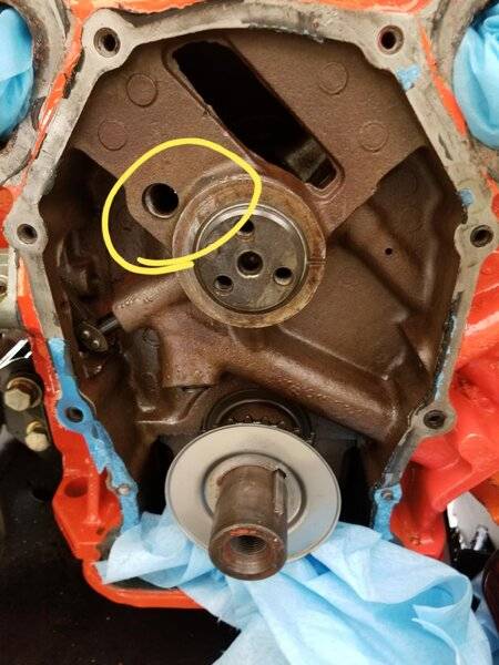

Good news! After taking a few months off, retiring from one job and starting a new career, buying a house, holidays, and whatnot I decided to dig into oil pressure problems on the superbee. Tore apart the front end of the hemi after I had a hunch that an internal oil galley plug was missing and creating a massive internal leak, causing me not to get oil pressure. Well...sure enough a plug was missing, just not the one I thought. @Fran Blacker called it.
I thought it would be the plug facing the ground as its easily missed but it was the one behind the timing chain. I should have caught it when I assembled the motor long block and that one is on me. So happy it's a cheap fix instead of a complete rebuild. Now we wait for the plugs to arrive next week.
Post#2 your welcome. :thumbsup: Glad you found it. I thought it would have been the other plug.
This is why you had flow to the top with no pressure. Under static conditions the pump had enough oil to get oil to the top. But nut enough pressure with that flow to move the gauge. The volume of flow wouldn't have sustained a hydro dynamic wedge while running. How long did it run like this? There may be damage
