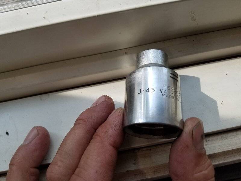

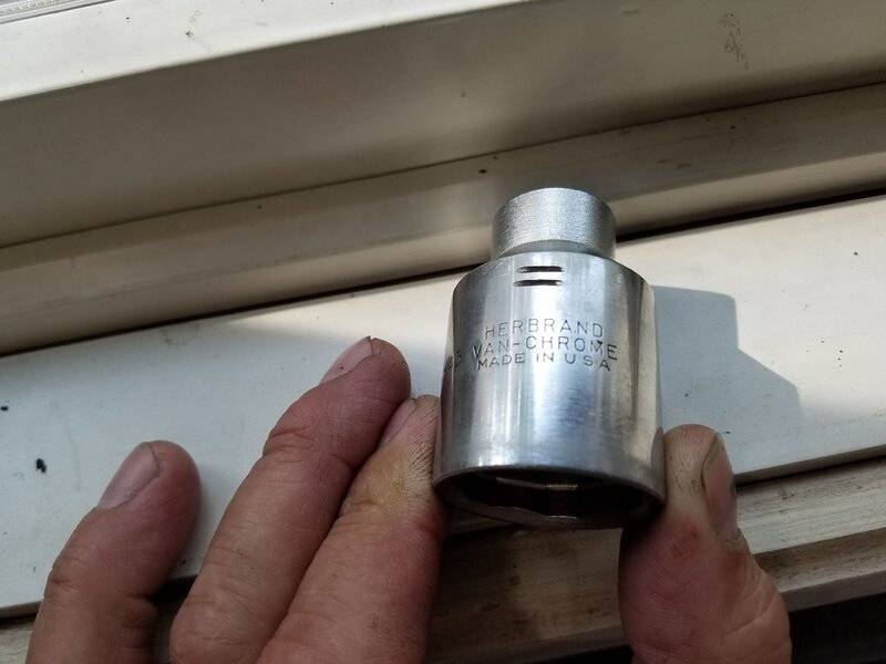

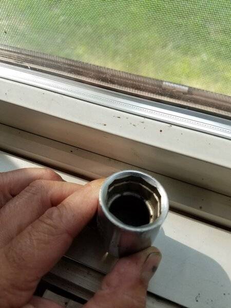

Here is the style socket you need.

I found the socket online that Hunt2Elk has shown for $15 online. I hate to pay that for something i'll probably only use one time, so I'll give a couple of the other suggestions a try first and report back. Thanks for all the response, this was suppose to be a simple thing,lol.
