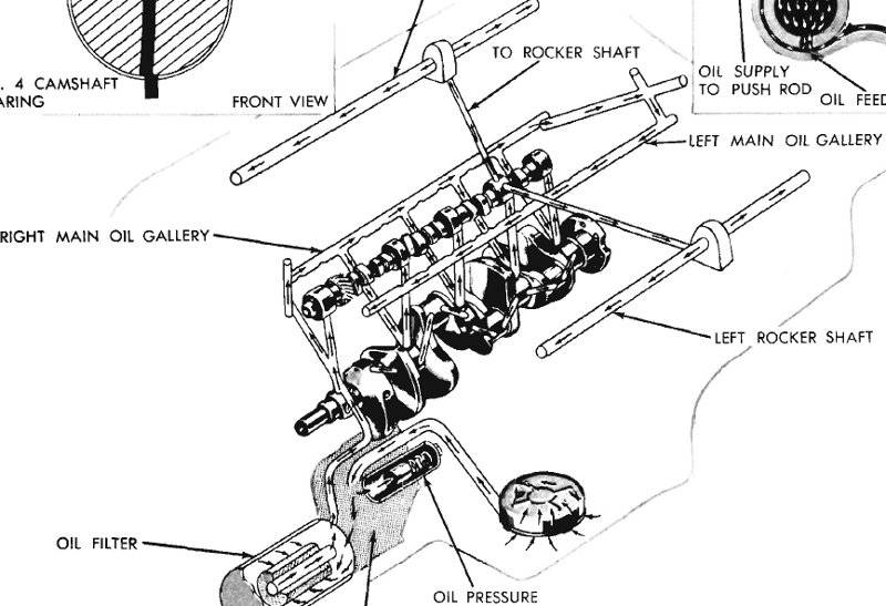

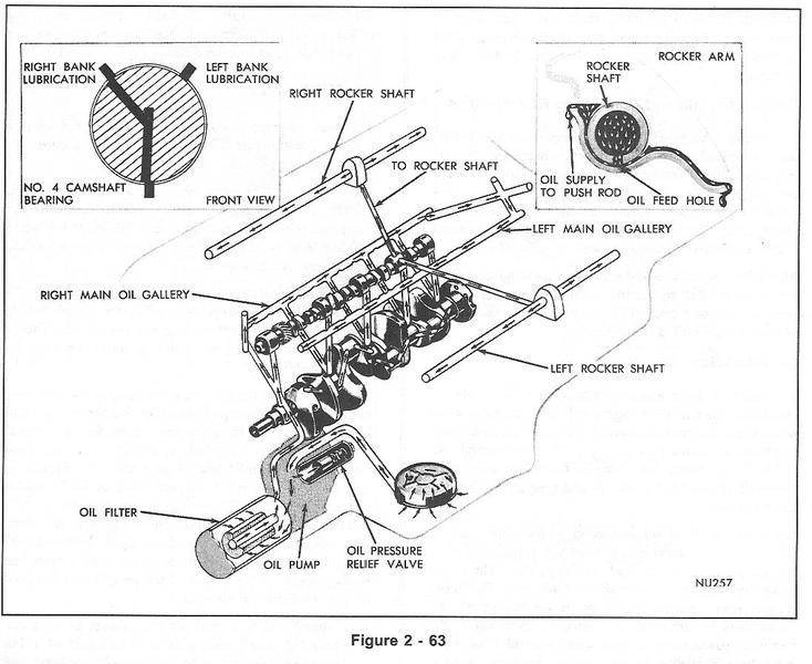

This should help

I would wrap tape, or use shrink tubing on the shaft where it goes through the bushing, to protect it from the sharp edges.
Post #5 is critical, it often takes me more than one full rotation to be sure the oil is up to the rockers. Both valve covers off & slowly hand crank it so the oil feed holes get a little time to take the oil.
