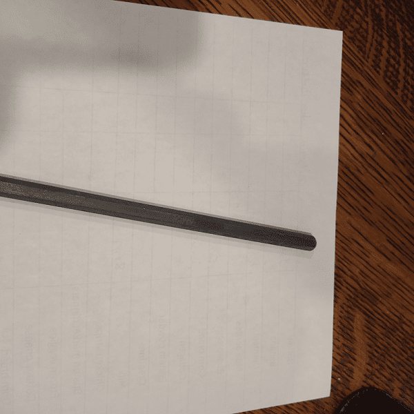

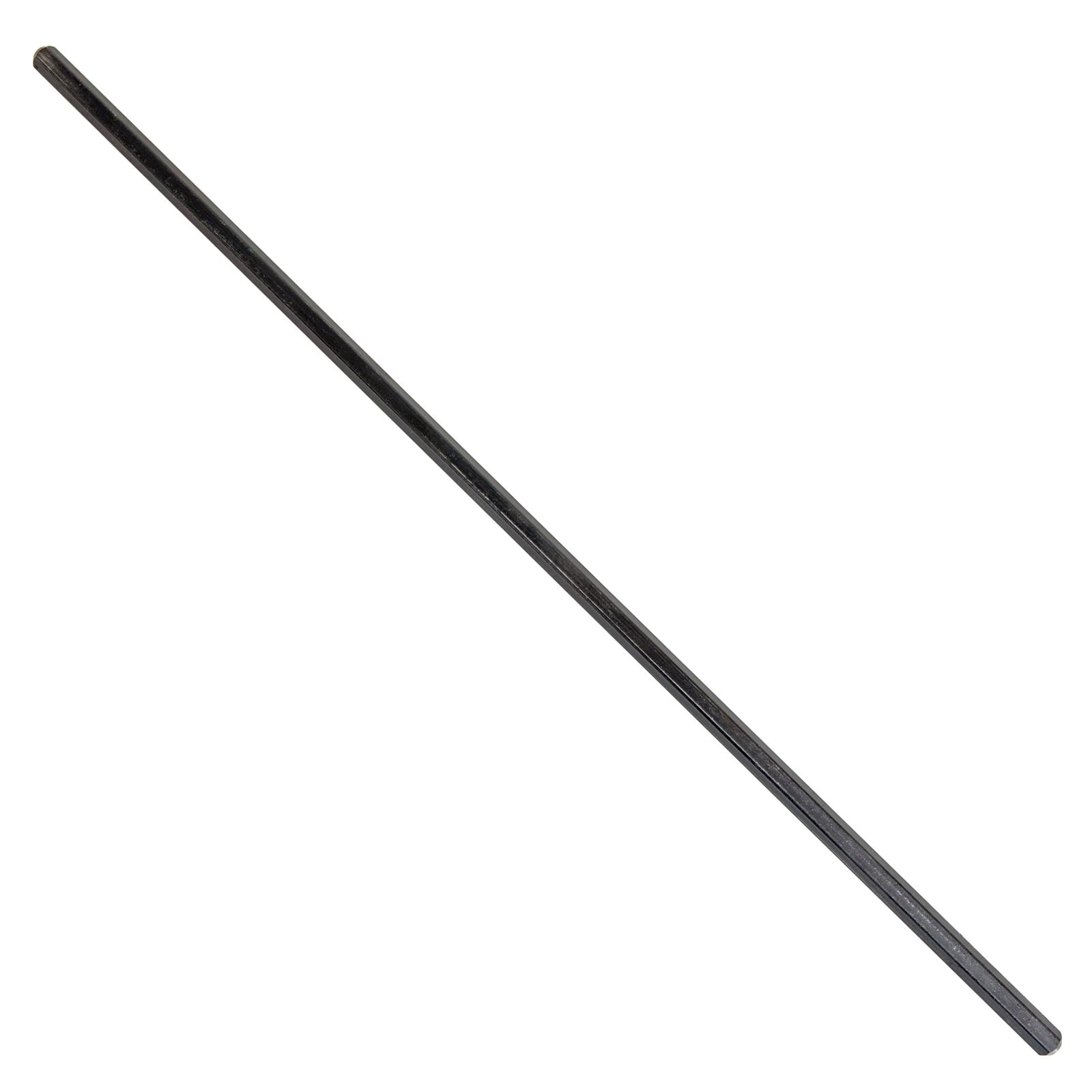

So a 5/16 hex tool is required.

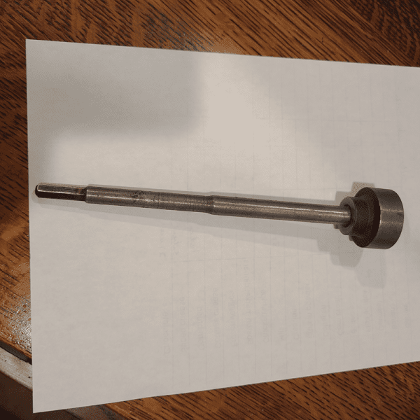

I made a priming tool out of 3/8 threaded rod by grinding and shaping one end. Some use an old distributor shaft.
Yes, a cutoff piece of 5/16 hex brazed to a length of rod. Been using that home made thing for 40 years.

I've used a piece of hex in a 5/16 1/4" socket all taped together in a pinch.
