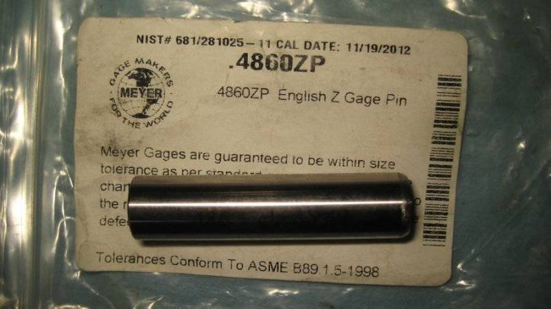

This is the solution to your problem. Its a pin gauge available from places that sell precision tools and such. Just tap it through the bushing after you've installed it per post #2

Based on Stanton's recommendation, I just ordered the z pin gage from GageShop.com. It asks if you need plus or minus, I ordered plus. They're about $5 a piece plus shipping ($9.25).

Got my z pin gage from GageShop.com today, which is Meyer Gages online store. They even provided a Certificate of conformance letter which in aerospace, is very important. Highly recommend Gage Shop.com, and not just because they're in Connecticut.
So is 0.4860 the size I need?
Nah, I just posted that size for the hell of it !!!
FWIW, the +/- tolerance is .0002 so don't be concerned - take whichever is in stock

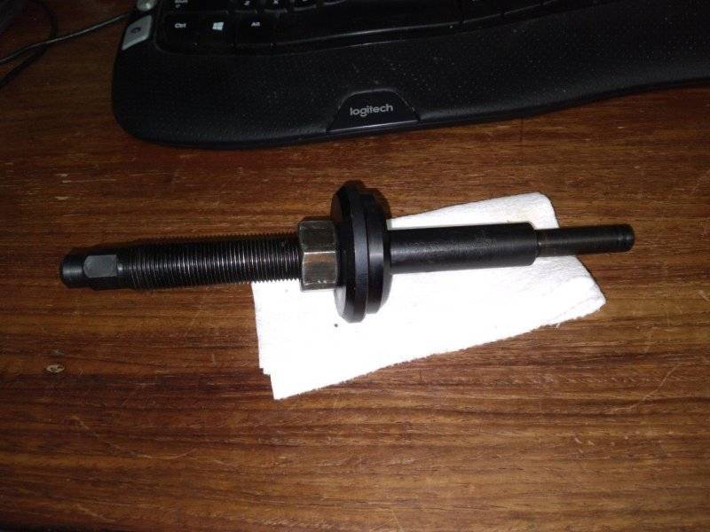

I have one if you want to borrow it. I'm in Okeechobee. Mopar CYC3053A
Chuck (snook)
