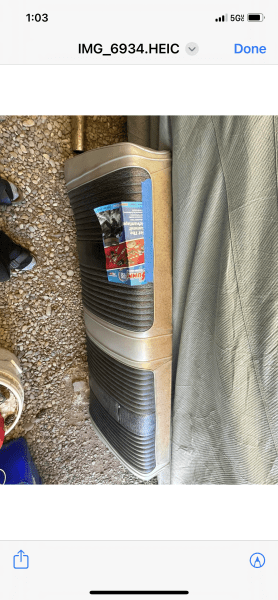

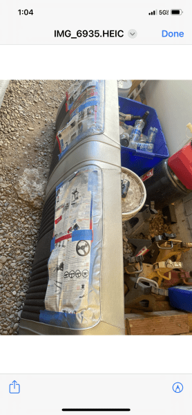

I cleaned and prepped sun visors. Added bulldog adhesion promoter. Let setup 15 mins or so
then sprayed paint
Did this a few months ago. Kept them in warm room
they are still a little tacky
what could it be
strange
