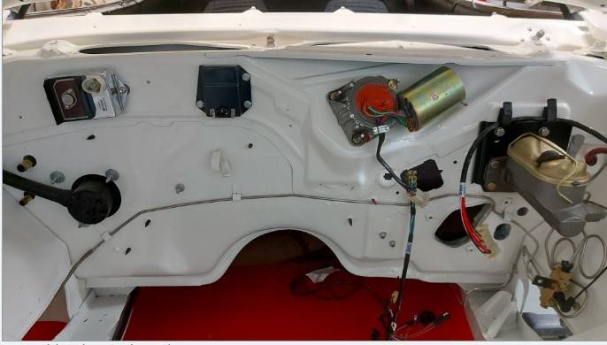

I did this conversion on my 1971 Runner.
The only item I changed was the master cylinder push rod - I bought an adjustable one for mine.
