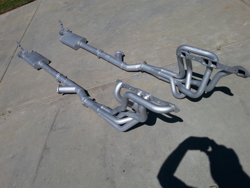

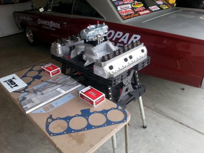

2quick, I think you and Mike should consider working out a trade - top end for top end.
Mike's Indy SEZ (non-max wedge port) heads, Indy Dual Plane and even the Mighty Demon 850 sound a lot more in line with a nasty street/strip monster, and if I recall, mike was recently lamenting his lack of max wedge ports.
The Dude abides.
I would trade him my INDY heads (non-max wedge ports) / Indy Hi Volume Dual Plane and 850 Mighty Demon...That would be good for both of us. I want a "race only" setup that he has and...I have the best street/strip setup there is for sale...trade would be good. Heck I even have a set of Hooker Super competition Headers ( 1 7/8 tubes) which are absolutely perfect for his setup to trade for his TTI's. My headers have the complete 3" exhaust system already setup with cut outs and MagnaFlow Mufflers all to fit a 66-67 Coronet.
