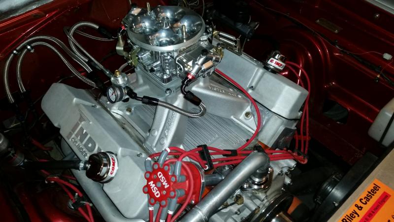

View attachment 301726View attachment 301725
The picture above shows my new carb (with adapter) on my Victor Single Plane (for your reference). The other picture shows the 2 1/2 "hood scoop spacer" I had to fab to get clearance for the carb (with adapter) and air cleaner.
I think a 440-2 (with carb) would fit under a "stock" hemi scoop...but may not leave room for an air cleaner unless you bought a top plate and a bottom plate and then found like a 1" tall air cleaner element.
If you had to use a carb adapter (that is about 2" tall) to adapt a 4150 carb to the 4500 base 440-2 manifold that might not fit.
You mention in a post that you might be able to fab a 4150 to 4500 adapter since no one makes one..... but you could probably buy a 4500 to 4150 adapter and do some work to "reverse" the mounting....but mounting a 4150 carb (with an adapter) onto the HUGE 4500 carb opening on the INDY 440-2 intake might just make the air/fuel velocity just "fall on its face"....don't know how this work for sure but it could be a problem.
I just bought a brand new offering from Holley (thru Summit). It is their all new #80688 Sportsman 4500 Dominator and it only cost $719.00. I mounted it on my Edelbrock Victor 440 Single Plane using a Transdapt 4500 to 4150 adapter. I set the transfer slots to .020", turned the 4 corner idle screws out 1.5 turns, set the float levels and set the fuel pressure to 7.5lbs then started it up. It fired up IMMEDIATELY and sat there and idled perfectly at 1300RPM WITH NO OTHER ADJUSTMENTS after firing it up. I let it warm up, put the trans in 1st gear and crammed the pedal to the floor and it lit up the rear tires with absolutly ZERO drama, no hick-ups, bogging or spitting. Can't wait to get it to the drag strip.
Maybe just keep your 440-2 Intake, buy the #80688 Dominator (your big heads and big cam should handle the 1050 carb just fine) and buy a 5" tall scoop and you could be home free on that end of things.I am sure you will have time to try things out....VN Fiberglass make a 5" Hemi Scoop that would solve all your problems...it is $160 plus frt from Chicago area.
PS: Canyon has a Harwood "bubble type" scoop for sale for $150 (it is a $300 scoop) that you could have mounted on your hood....it would also solve your problem...and that scoop is a mean looking scoop...check it out on for sale forum.
That car is absolutely gorgeous and I'm very impressed with the fit and finish of everything. The Dominator would be any easy solution to the height issues and I was kicking around running one anyway. Let me know how it acts (Maybe cruise it around town for awhile) and I'll be in touch to see your opinion.
