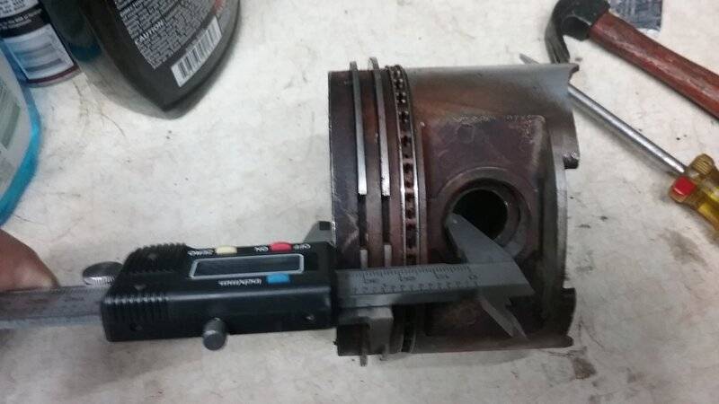

The old 440 domed trw/sealed power L2295 had a compression height of 2.029. It was a compression height that doesn't make much sense for a custom 440 piston.
why did TRW do a dome so far down the deck
we always had to deck the block .055 or so to get the pistons closer to 0 deck.
The best reasoning we came up with is trw used the ch of the 68-69 375hp engines and then added the dome and the valve reliefs.. just a theory any way
