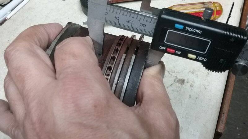

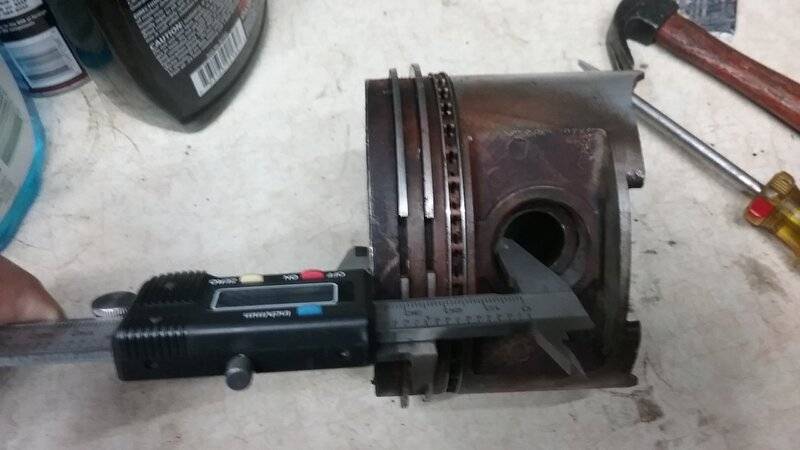

pin height

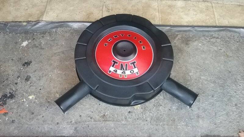

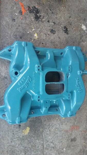

to top it off. 750 Edelbrock, ch4b , dual snorkel, hp manifolds and chrome valve covers. did the Newport come with 375 hp motor from the factory ?

short block back together. came out to 8-10 thousand in the hole after taking 7 thousand off the deck. compression will be 9.75.
