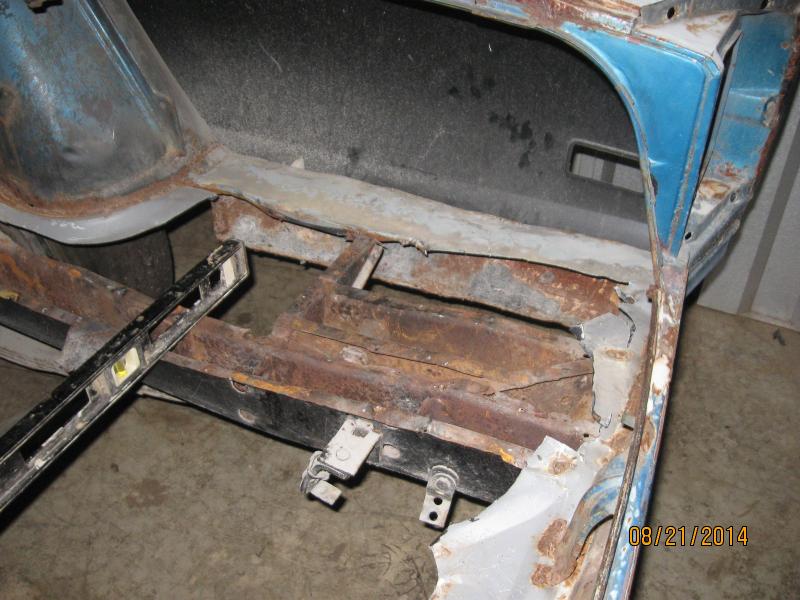

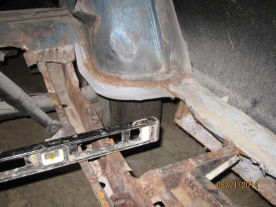

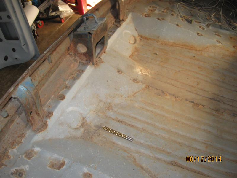

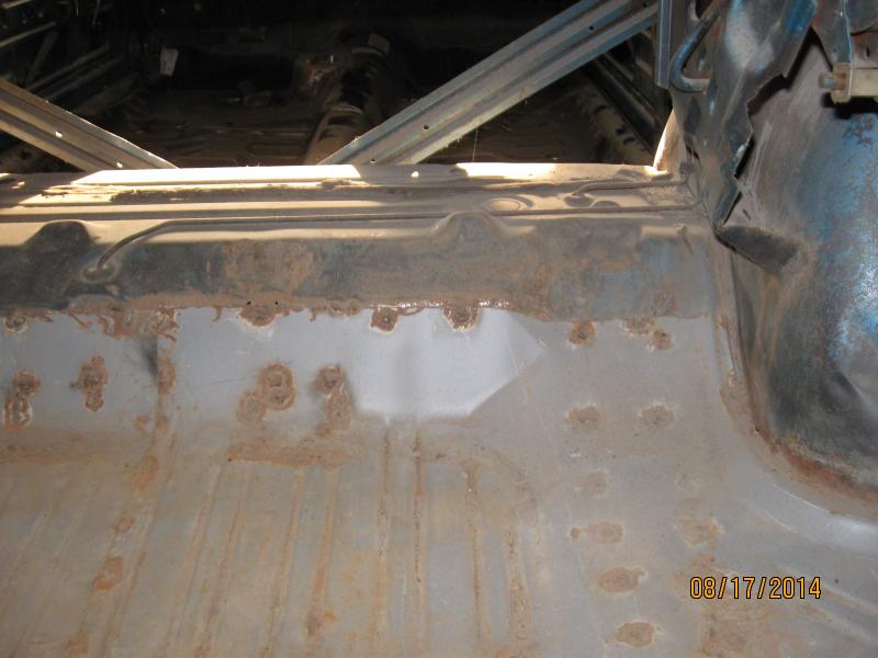

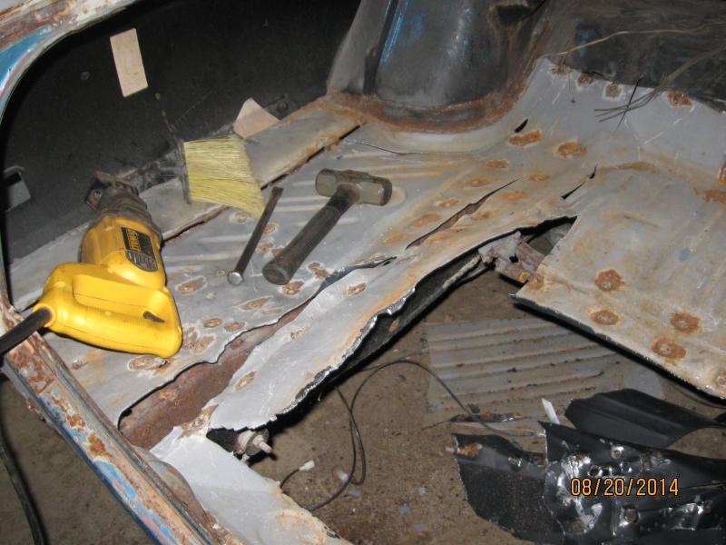

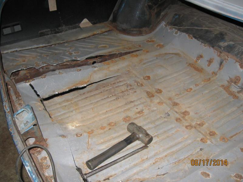

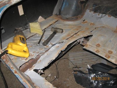

a few updates on my starting point with the trunk pan. IMG_1175.jpgIMG_1181.jpg i used a sawzall,hammer and chisel,and blair spot weld remover kit,this is the second time around for me on trunk pan removal and this time its a lot more easier to perform work,but it is still a job to remove a botched up trunk pan or any trunk pan, and you will notice the extra large spot welds that was left,without any grinding down at all.

Holy crap Johnny...the folks from that body shop should be drug out in the street and beatin! Wow! You go your hands full my friend. Hat's off to your "Think Positive-Move Forward" approach. Onward with your "butt-kicking" sir.
prop that is the first thing i said when i first seen it "holy crap",but i also looked beyond that and saw that this car could be made into a pretty decent car,with some work.the car has some good points as well,so i am feeding off of that and my little know how, with plenty of patience to march on to victory!

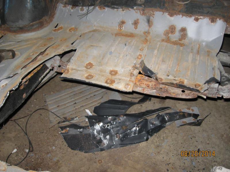

here are a few more updates on trunk pan removal for b5.IMG_1197.jpgIMG_1198.jpg
look to the left you can see one of those homemade trunk drop off that the body shop decided to weld on to the driver side quarter panel all the way down to the bottom of the quarter panel makes for a lot of work trying to detach it from panel some real caveman workmanship.IMG_1199.jpgIMG_1200.jpgIMG_1201.jpgIMG_1203.jpgIMG_1205.jpg

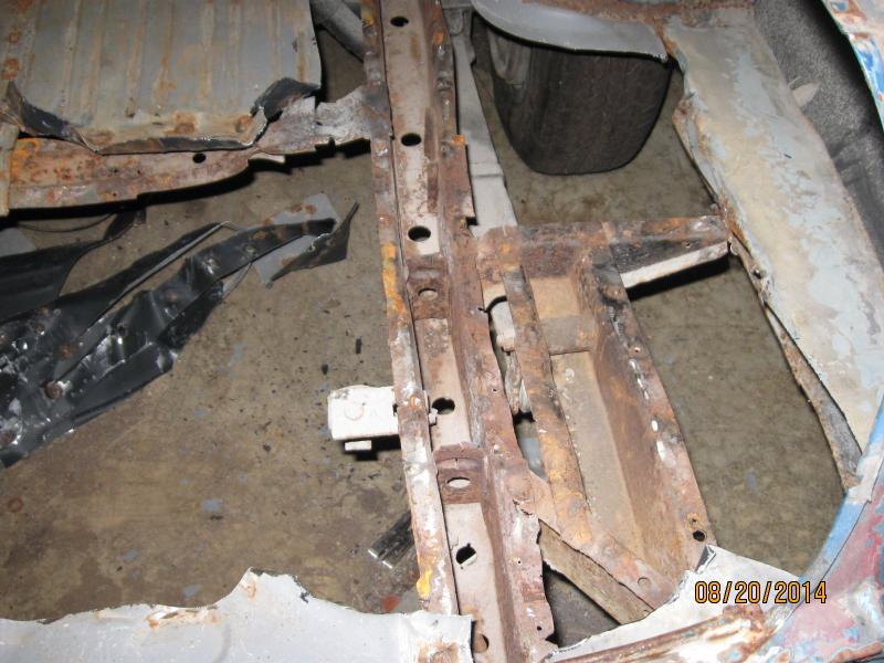

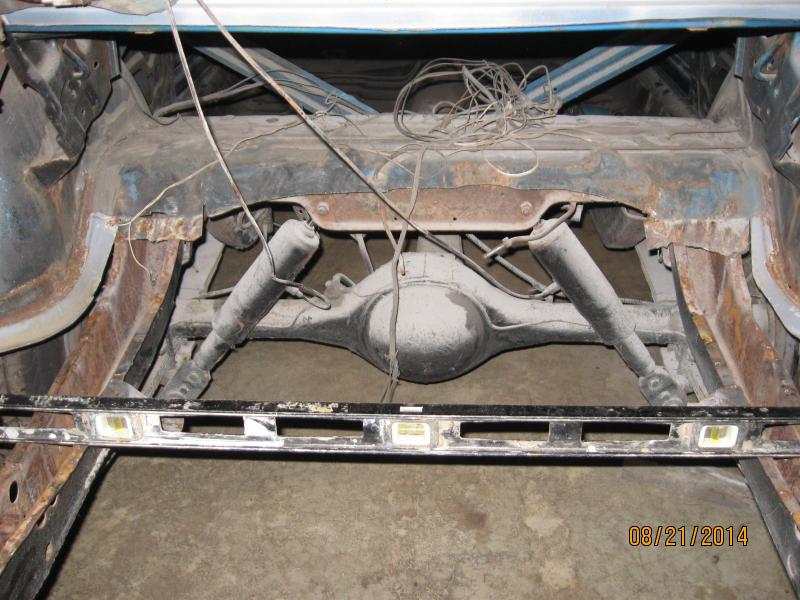

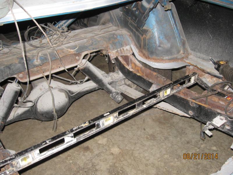

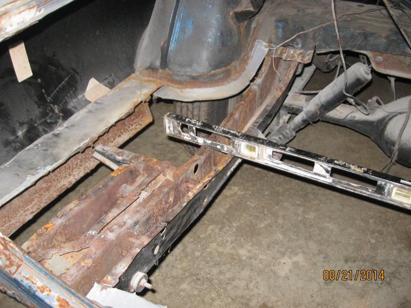

making progress finally got all of that botched up trunk pan out,next will be to grind down frame rails where all of those mountain size spot welds were and start to clean inside of frame rails out so i can start rust proofing with rust bullet or por 15.IMG_1242.jpg
Looks pretty solid from what I can see. Keep after it
yes the rails are in good shape,the insides are dirty,but i am cleaning and wire brushing the insides and out sides down so they can be coated with por 15 or rust bullet.

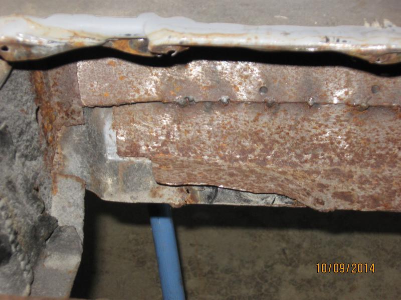

here is a closer look at one of the homemade trunk drop offs you can see how it was pop riveted all the way down to bottom qtr panel never seen this before now,so i guess we see and learn something new and something different everyday.IMG_1256.jpg
that looks about as good as the ones on mine. whoever did the quarters was a pop rivet master. not one sign of weld anywhere.

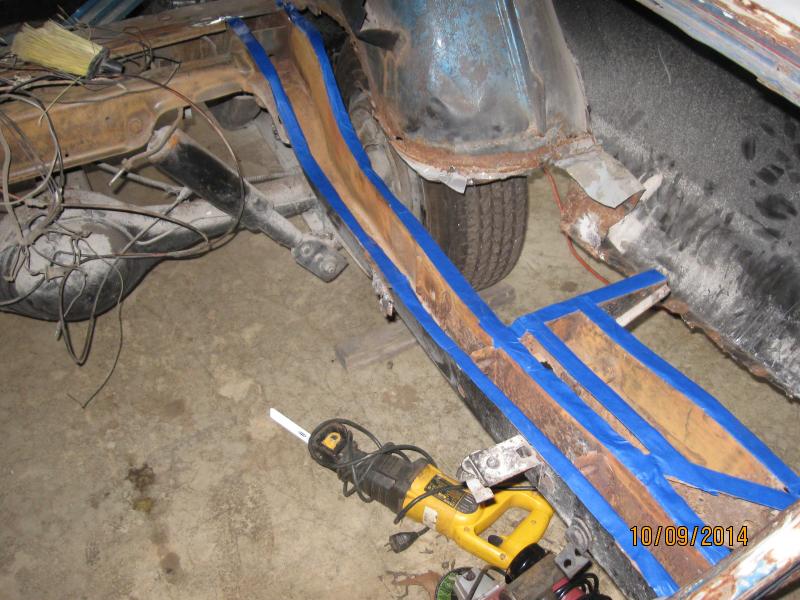

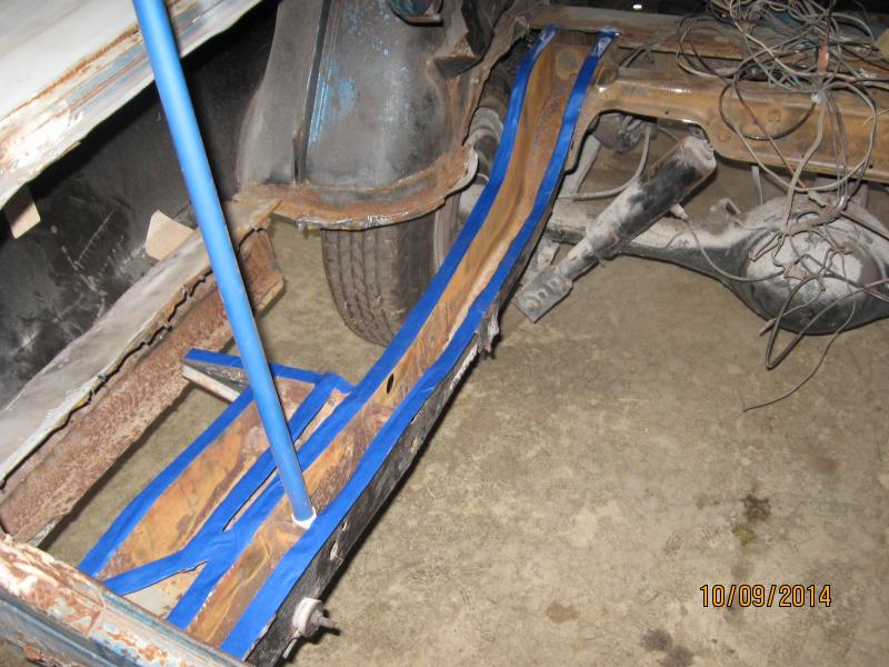

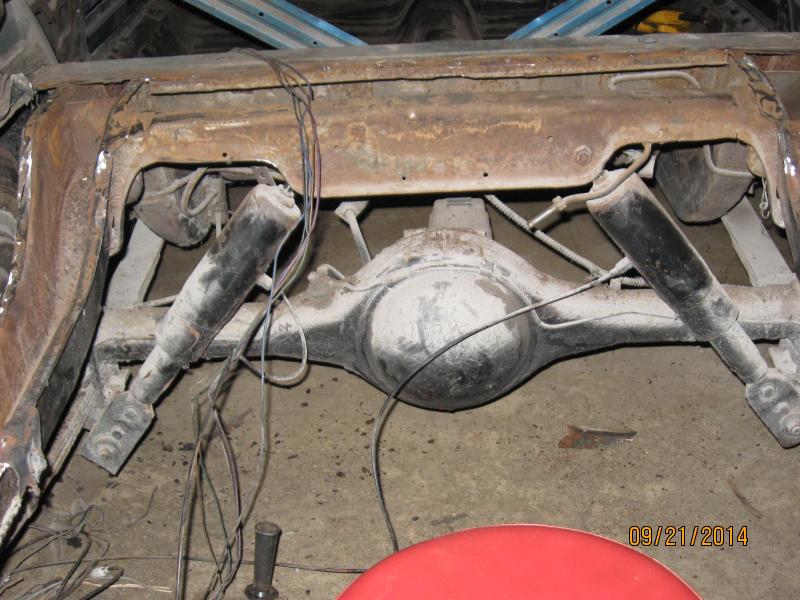

a new update on progress of b5 trunk removal processIMG_1257.jpgIMG_1258.jpg cleaned all the junk out of rails and i grinded down spot welds from the top of rails and cleaned top of rails off with grinder as well and i taped off with blue tape to keep the top of rails clean from rust proof materials.that will be the next step. i still have some more triming to do for inner fenders some material still remains on the bottom i will trim all that down as well and i will use my grinding wheel on the rails to clean them up from the outside as well.
Sounds and looks like you have everything under control good! I know it's a lot of time and work but like others i do think it's in the best interest of the cars and how we take care of them, later on its a good feeling knowing all the time and work the car is ready for another 40 years, only better with the rust converters we have to use on the cars now.. Looking great, Good luck!
Johnny's in the trenches, battling the ruthless onslaught of rust, previous cobble job's and rotten metal! Keep up the fight, looks like you're winning!
