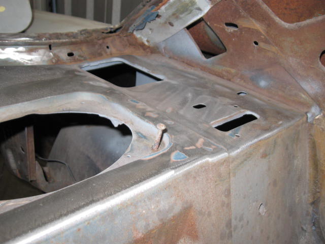

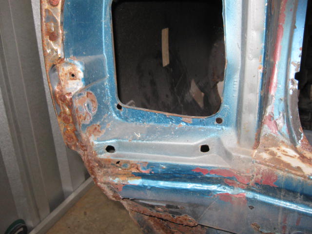

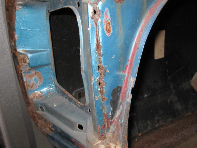

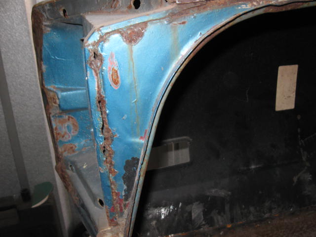

been working on b5 i have done so much grinding work until my hands and arms feel like a strong candidate for for a ben gay commercial,i have made a lot of progress and i continue working on rear of car starting with a bad driver rear tail light housing and light bucket i saw some rust and rot on that one and decided to remove it and i will replace it with new metal.
. i removed that entire light side.

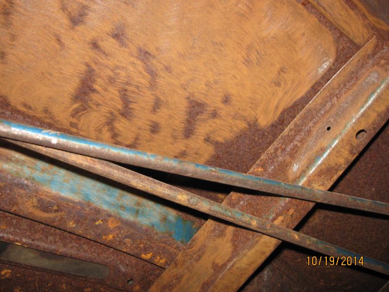

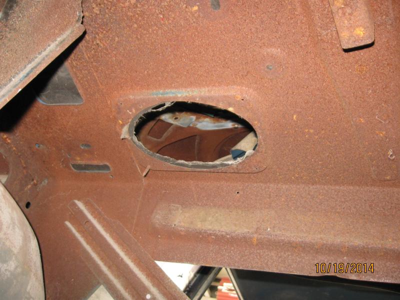

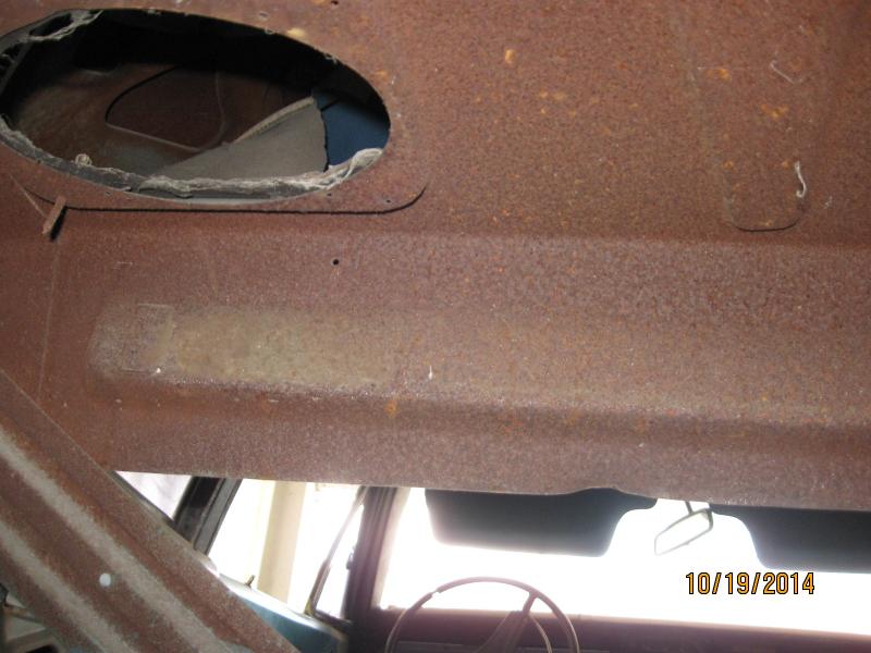

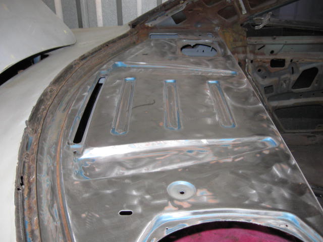

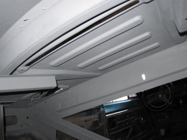

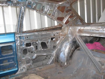

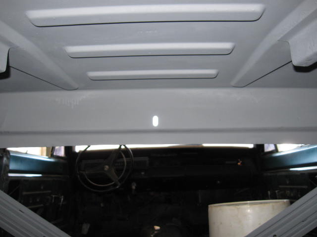

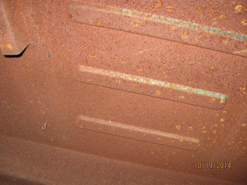

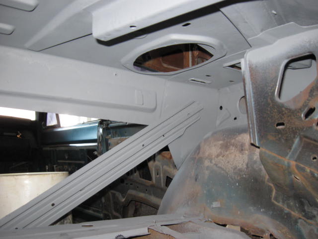

from the tail light section i decided to clean up the underside of the package tray,kinda tuff working under there with limited space to move around,looked like a pretzel at times with all the bends and twist i made to get position to grind,but it turned out nicely proud of my work with it.

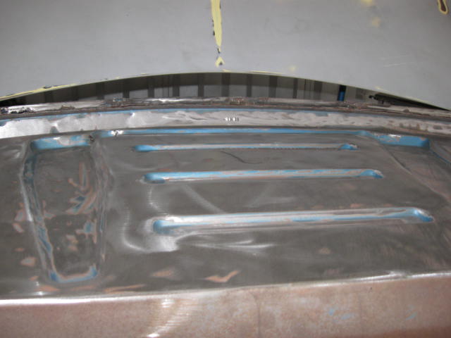

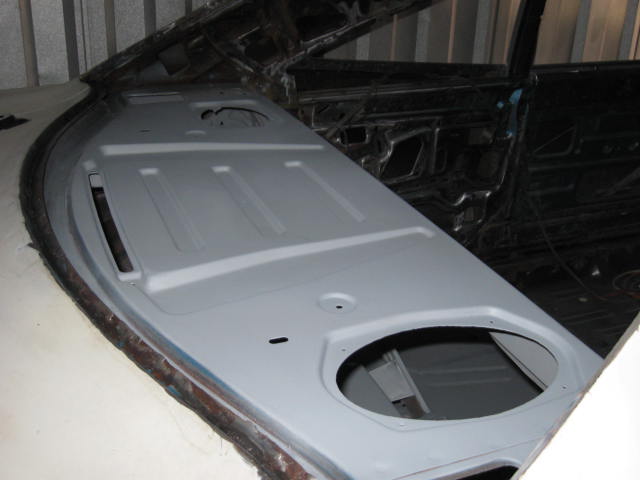

then i decided to go on top of rear package tray for some clean up as well,much easier working on the top,came out pretty nice.

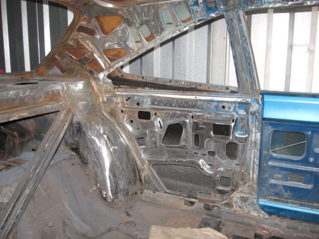

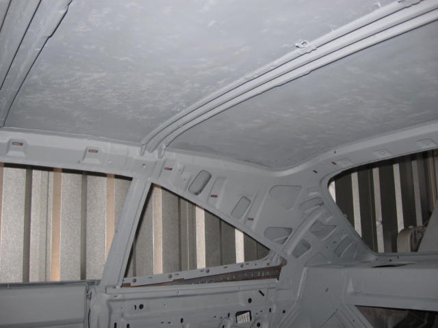

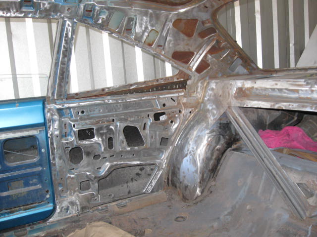

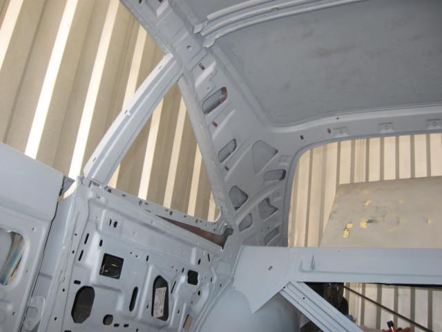

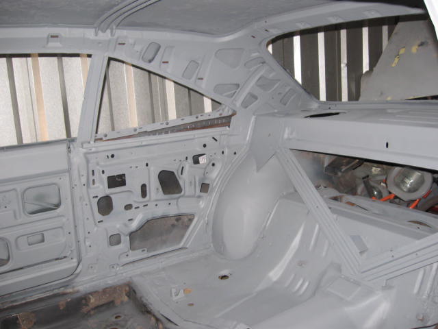

i went back over it a second time to clean up the blue spots on all the metal,then i used a etch primer and then i used eastwoods rust encapsulator to top off and i will go back after that with a epoxy primer.and i will have to replace the top parts of both corners not to bad a job for that i have ordered both small corner pieces,i could cut some metal and fit in those little spots,but i decided to do it correctly and will repair with amd small corner patches.i just kept on going forward with grinding work with interior and roof work.

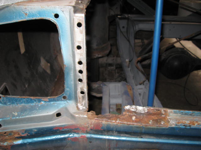

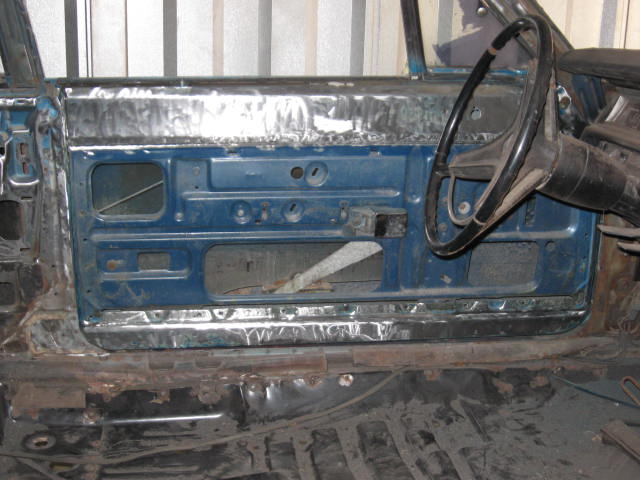

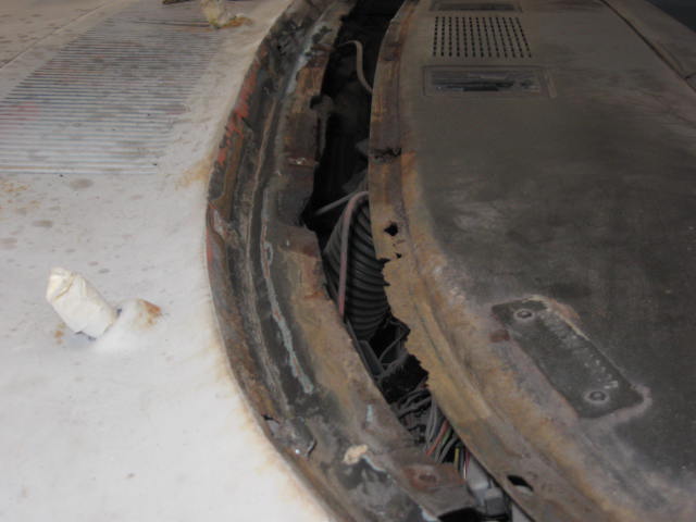

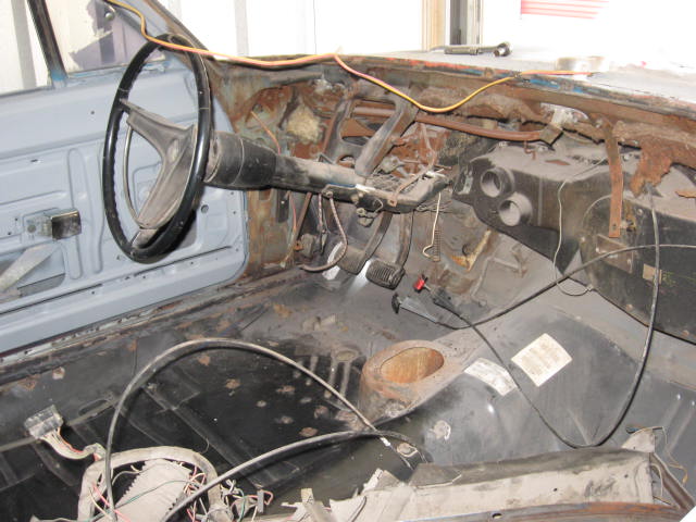

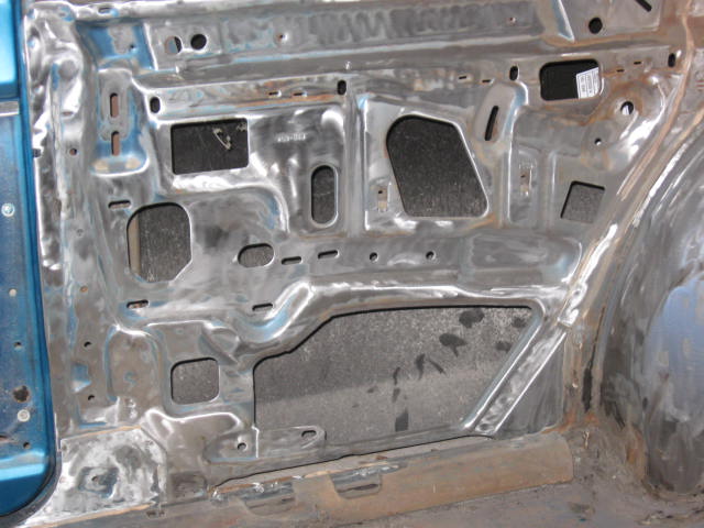

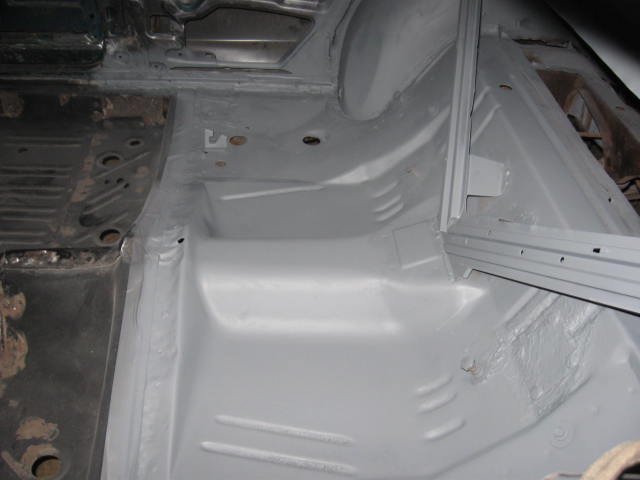

i am still working forward,i will remove dash and continue working on the cowl area for cleaning and under dash, the main floor has spot welds that needs grinding and i will clean all that up, and will go over all the seem areas with a good seam sealer before i shoot primer on main floor area,i know that passenger side outer rocker needs replacing because of shotty body repair,so i will be revisiting prop wash thread on that, to get some direction and insight,i started removing some spot welds from the top of rocker already,but that will be the last thing to do on floor area.thanks for dropping by.
