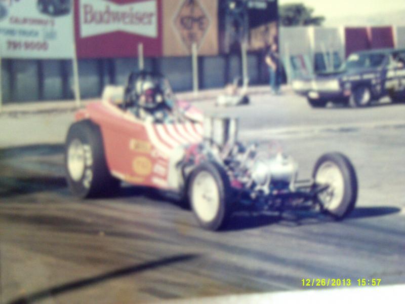

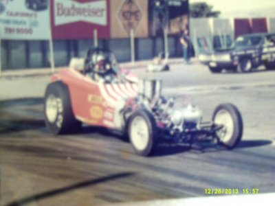

Seeing how this threads a little slow lately I thought I would throw this out there.32 bantam altered w/blown 392 hemi, glide, 57olds rearend. The chassis is 2x3 box rails w/straight axle front end,leaf spring and friction shocks. The rear is solid mounted w/3.63-1 gears and a spool. Rear disc brakes only and a chute. American racing magnesium wheels all around,18"12 spoke spindle mounts up front. 10x15 4window slots out back.12x30 slicks. The 392 is almost completely stock. Stock block,stock heads,stock crank. Good rods and forged pistons,about 7-1comp. This is a gas motor. Unknown cam w/ just over .400 lift at the valve. Solid lifters,stock push rods and rocker arms. Duel valve springs from Isky. Swap meet blower driven 8% over. Hilborn injection,Mallory mag. Car was built around 1970 w/426 hemi and clutchflite. We run it just for fun a few times a year. Goes 9 flat at 150. A blast to drive I dont push it. I only use the trans brake when I back up.

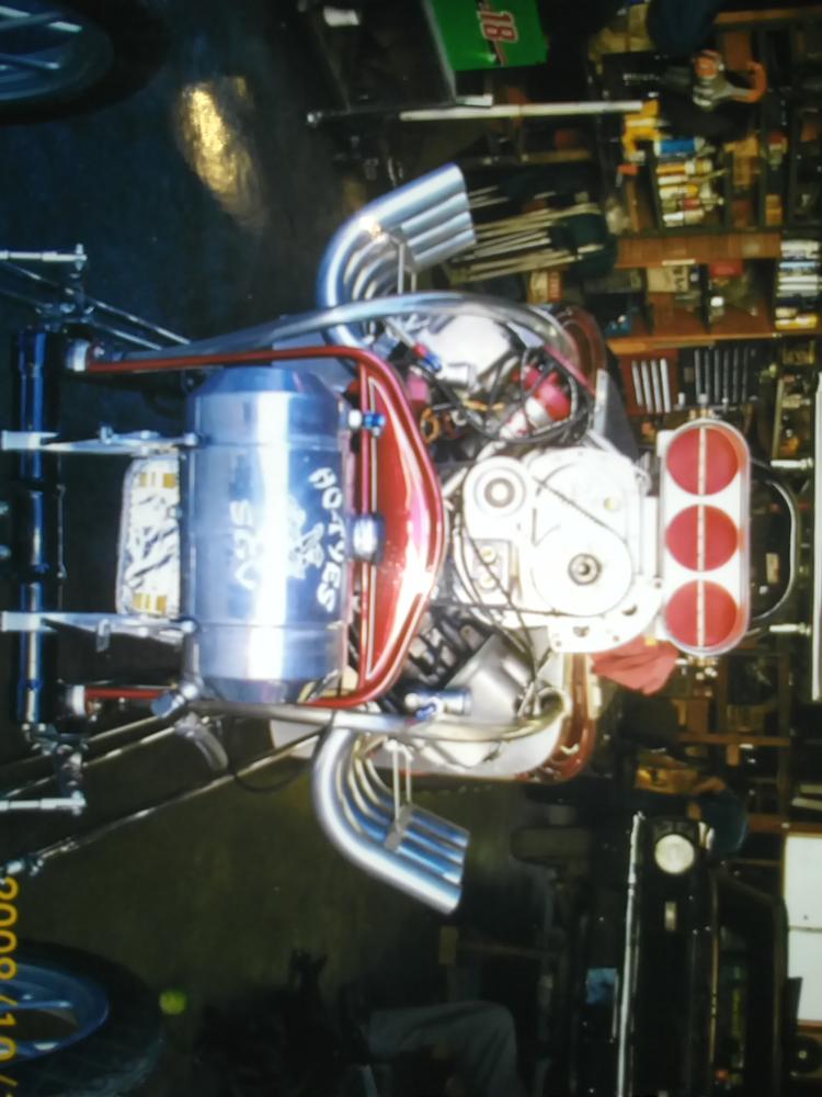

That hemi was in the bantam first. It only lasted one weekend. We took it to Barona and the first pass it wentwell into the other lane. I mean it just torqued to the left. Hmmm,needed a little time to think on it. Well first thing next morning the guys yanked the motor. Didnt even tell me. I would have given it another shot. This is the only pic i have of that motor in the bantam. Oops,sideways pic! lol

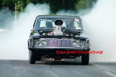

My 63 Plymouth SS MW, just a 440 source 528 kit with 368cfm Indy SR's and roller cam. Had a 3500 vert in it for the nitrous so think that kept it in the high 9.9's naturally aspirated, with a 150 shot it ran a best of 9.23 @ 145.
Car is sitting at the moment, would like to step up to an after market block and have 900hp aspirated, might even get those drum brakes off the front :)

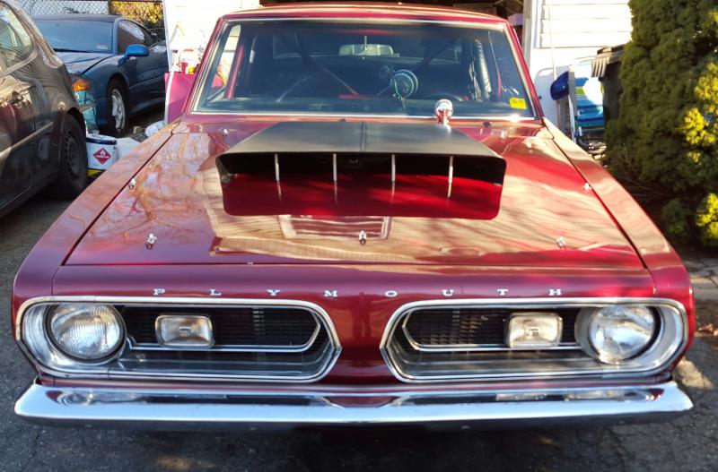

Barracuda looks good BOBTILE
what does she run ?
what are you running in ?
still just the NE Nostalgia stuff ?
or have you expanded your dominance ?...LOL

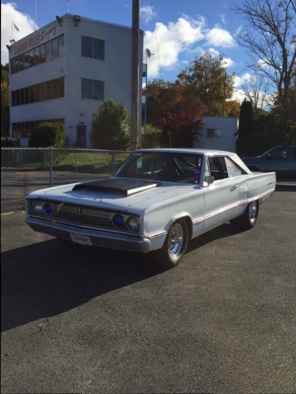

My "new" 1967 Coronet.
Ladder bar, coil over, tubbed with 2 seats and some fiberglass.
Best so far is 9.72@ 136.54
Still tweaking as there's more in there...
Only have a bottom pulley so it's harder to get quicker...just sayin
Like I eluded, more to be found
I know it'll get quicker after the summer heat
But I'm still tweaking now to see how fast it'll go in the heat
