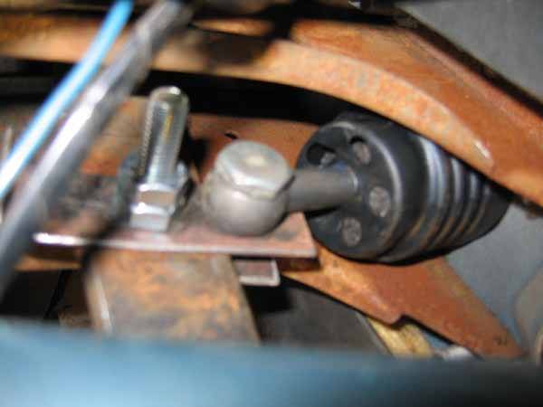

Exactly the same mounting holes at engine side. But I did make a little rod at driver side: the brake pedal was lower than the original.

I bought one from Summit for my '63 - a universal booster for around $70 as the one that came with the conversion kit was defective. The brackets are adjustable so no new holes were needed. Car didn't have power brakes so no issues trying to work with the original linkage setup. The SSBC setup is basically GM. I machined a new rod, much better than was in the kit and could still work off the manual brake hole in the pedal (upper hole). Had to make sure I had the booster rod to MC adjustment correct that took a bit of trial & error.

There should be two holes on the pedal upper - manual, thought the lower hole accepted a bell crank link.
