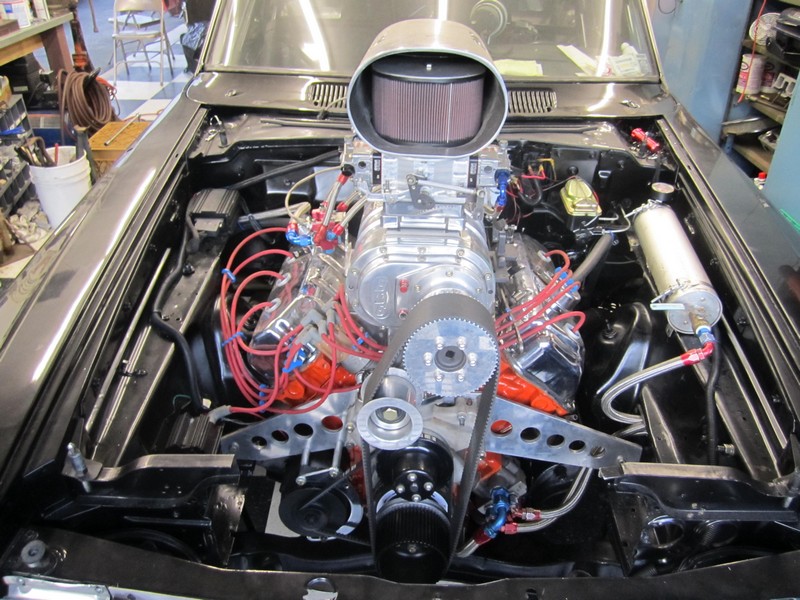

I have a vacume gauge tapped into the carb spacer.This tells me what the vacume drops to at WOT and at idle.I was told I had to use boost referenced carbs on my blower which I did not.When I tried the plug it method I developed an off idle/cruze bog when I opened the secondaries.I reinstalled the 10.5 PV"s and the bog dissappeared.It idled with 13 inches of vacume,cruze was 25 and WOT was 4.So I had a better set uo using the power valves.Your results may differ.

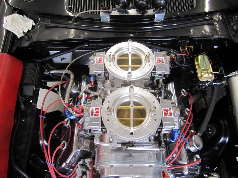

These circuits all work together,including the air bleeds to really dial in a carb.After many years with a pair of 750 DP's,I stepped up to a pair of SV1 carbs by Pro System.A new design by Patrick himself.I have dialed them in best I can untill I get a data logger,then I can really turn the boost uo over 10 lbs.I have not raced with more than 5 lbs YET!
