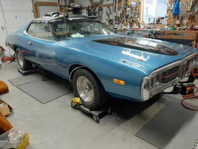

I used it on my 74 Charger since it is a car that will be driven by my grandson. It took 4 coats of color and 3 clear coats for good coverage. I had them mix 2 gallons of color at the same time. It was great for the trunk and engine bay. Just okay for rest of car. I got it for a very good price though. For a show car only, I would have gone the next line up on the paint.
