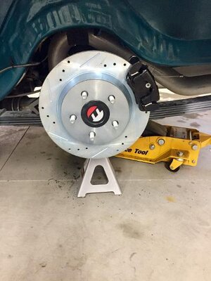

Awesome, I also have one of the 1 of 259 68 charger 383, 4bbl 4speed too. Has a non matching number 383 indy heads, roller cam and some other stuff in it, but now has a 5 speed and a dana 60.
Awesome, I also have one of the 1 of 259 68 charger 383, 4bbl 4speed too. Has a non matching number 383 indy heads, roller cam and some other stuff in it, but now has a 5 speed and a dana 60.View attachment 1014693 View attachment 1014694 View attachment 1014696
Put 4 wheel disc brakes on it also with moser axles. All the numbers I have seen and read show 259 383 4bbl 4 speed cars made in 68 but the numbers don't really matter to me I just wanted a true 4 speed 68 charger.
