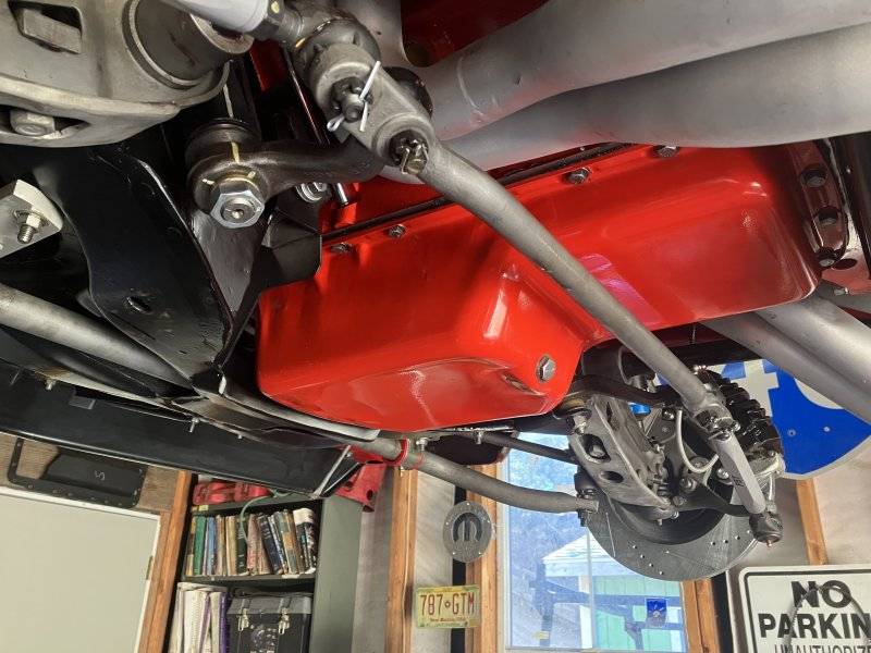

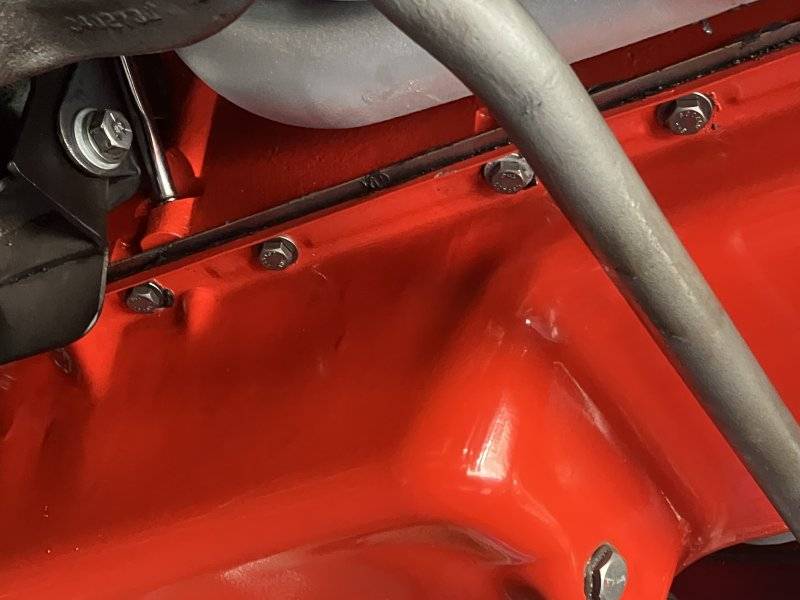

The oil and oil pan gaskets came in.
Balancing a steel windage tray and oil pan while trying to hold a bolt to install is a circus act.....Add in gaskets that have RTV on them, all hoping that nothing shifts out of position. I used the black fibrous gaskets that I've used with success before.
I had far higher hopes of a well sealing oil pan when I put the pan on while on the engine stand. Gravity is on your side and the steering linkage and K member are not in the way.
Regardless.....It is in. The bolts were cleaned and new red Locktite was smeared on the threads.

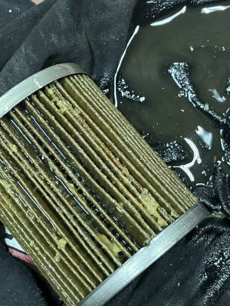

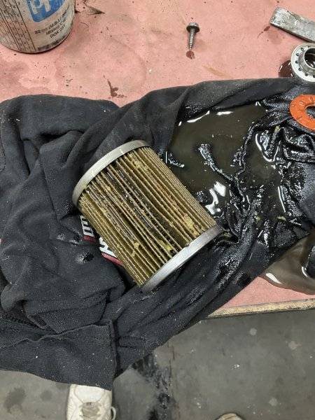

The oil in the old filter also had that shimmer to it so I cut open the filter.
Those yellow globs.....

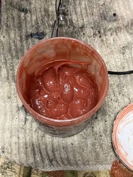

They are soft and really slippery. I can only guess that the globs are the assembly lube:
Oddly, this stuff is salmon colored in the jar.
Maybe after mixing with the oil or just the heat in the engine, it changes color?
Weird.
There were no shavings in the pleats of the filter. The shimmer must just be what I had hoped....cylinder wall and piston rings breaking in.

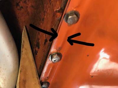

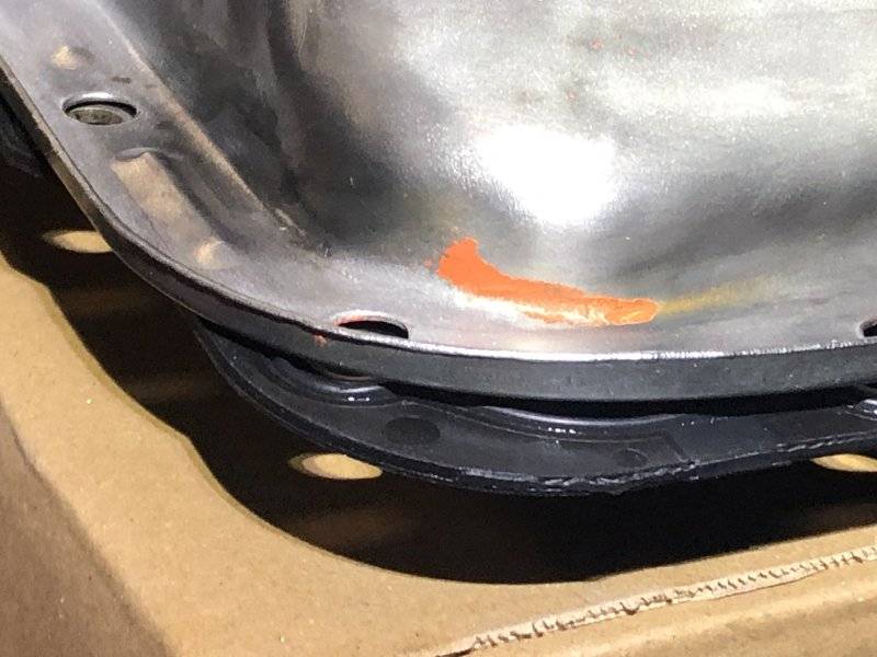

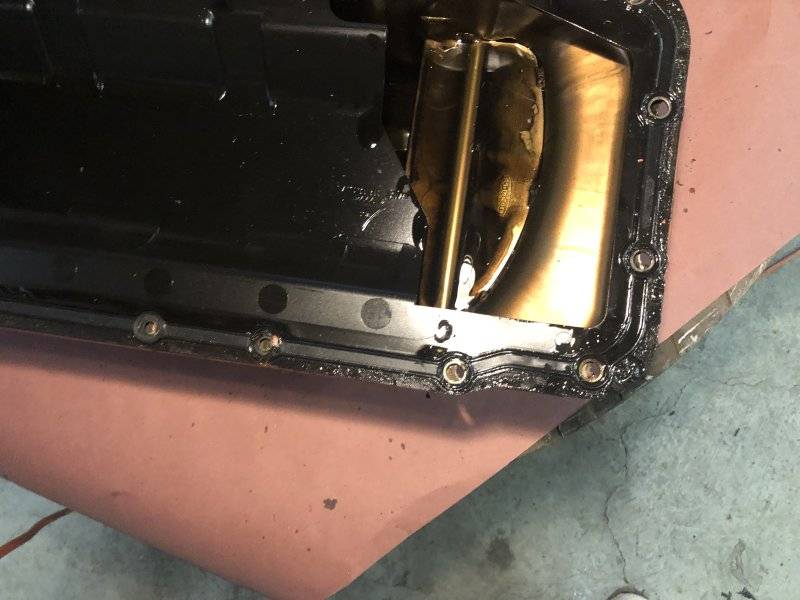

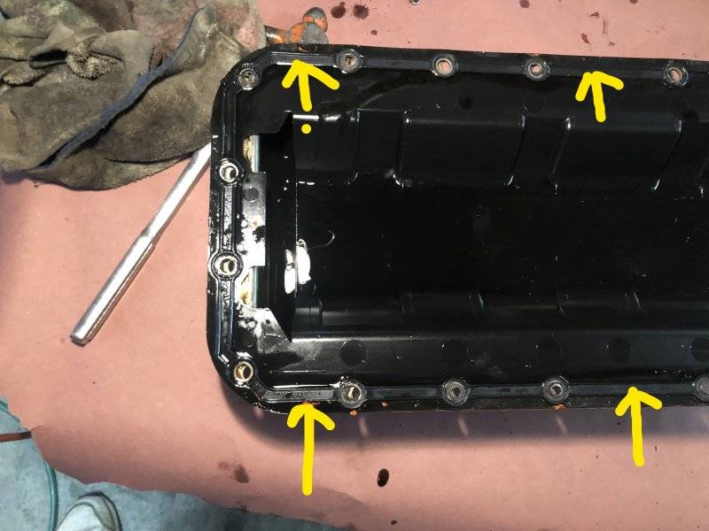

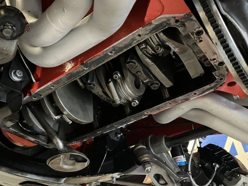

The molded plastic windage tray is an excellent idea in theory but to make them work, it seems you'd need an oil pan with dead flat rails...NO indentations to present voids where the windage tray sealing ribs would not make contact.
The reinforcing indentations may or may not line up with the sealing ribs.
This was with the MIlodon pan that is also 1/4" shorter than the stock pan. The bolt holes line up but the rails are not long enough at the front or back to cover the ends of the windage tray.
Welp, again too late to help you this time, but what I do if using the factory-style windage tray IF the engine is in the car, is make "the sandwich" on the work bench first. I use a thin smear of sealer at each layer but leave the top of the second gasket dry, as I prefer to put that layer of sealer on the block surface. Some bolts dropped through some of the holes keep everything lined up. After it sets a bit, I'll put my smear on the block surface, stick a couple three short studs in a few of the holes, and then twist that thing up over the pickup. Having all the pieces together and slightly cured makes it much easier!

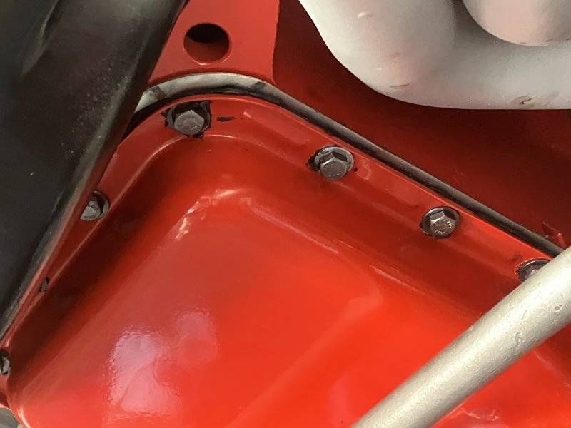

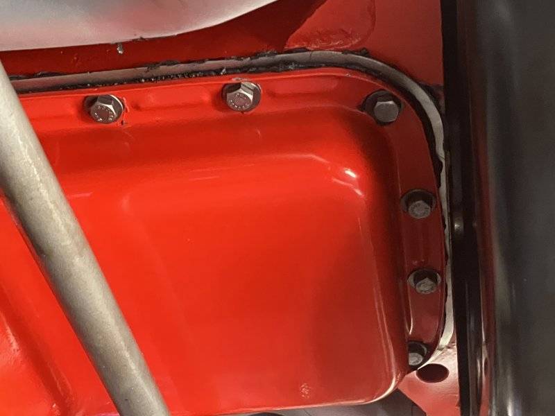

Well, the second pan gasket installation doesn’t look as clean as the first but it is good enough for me. Cold start and warm up showed no oil flinging off of the crank like before.
I am hoping that it holds.

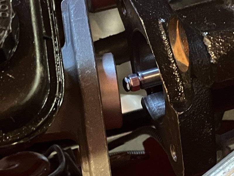

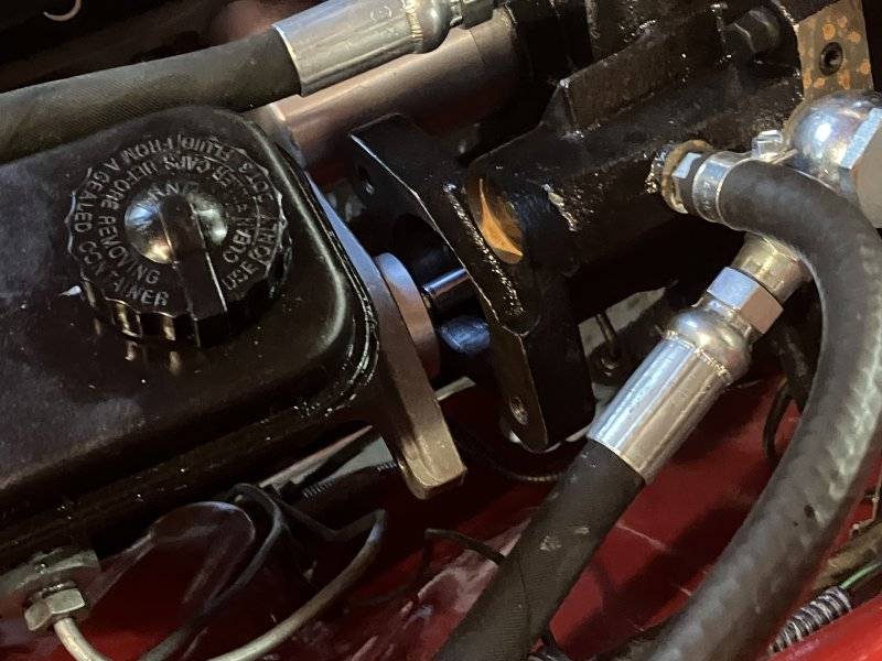

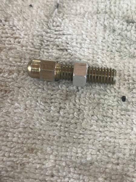

The brakes were bled but the pedal had some free play to it. One fix is to pull the master cylinder forward…
You then adjust the nub…
The man included another one for longer range adjustment.
I backed it out maybe 1/16” and bolted it all back up.

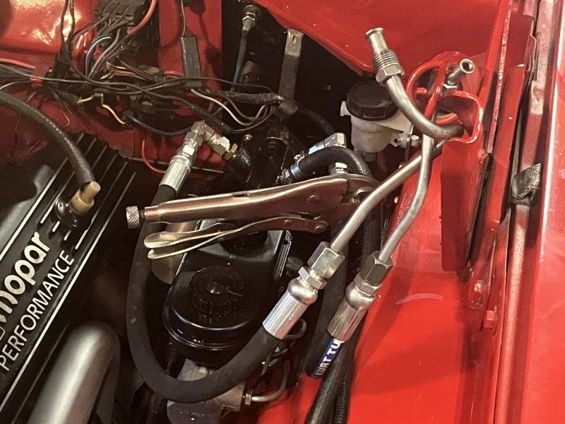

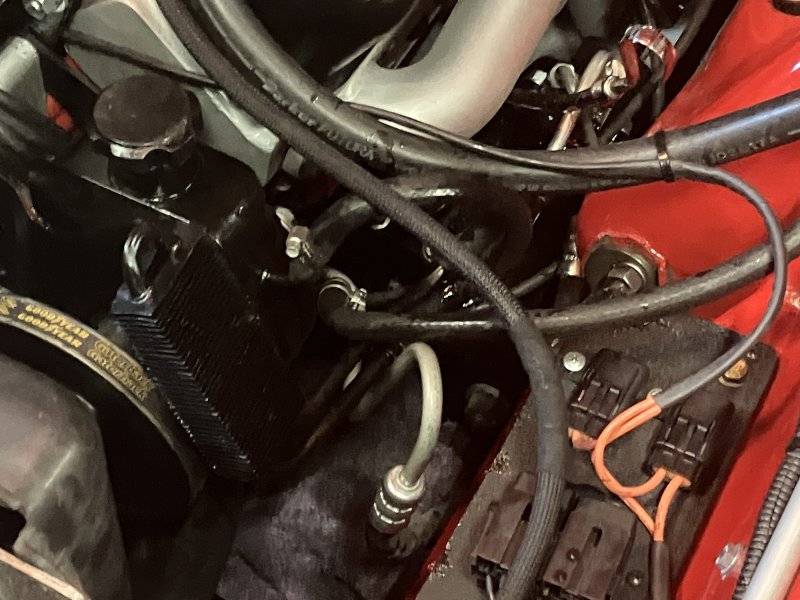

The brakes aren’t getting boost. The steering isn’t either. I revved it up and the steering got slightly better but it is not right. The brakes feel like a power brake car with the engine off. WTF happened? Inconsistent boost to both the HB and steering box?
Either the pump is bad or somehow the fluid dead ends at the inlet of the HB unit.
As a test, I pulled the lines to the hydroboost and ran a regular power steering hose to the box.
No boost. The problem is in the pump.
The five hours I spent a few weeks back screwing around with juggling pumps and reservoirs has again proven to be wasted time. I had a good pump but thought a smaller pulley would help.
Now I have to pull the pump and swap Parts around yet again. The pump sits under the A/C compressor and is a bit of a pain to get the hardware all lined up. Right now I have mixed feelings…. Pissed that I have to fiddle around with the pump again but also happy that I may have figured out the problem. In theory, the hydroboost should deliver excellent brake force but it has been a rocky road getting there.

I can’t really see how your clutch master cylinder reservoir is mounted, did you get a bracket to mount to your master cylinder?
