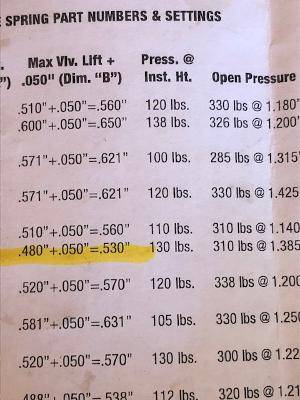

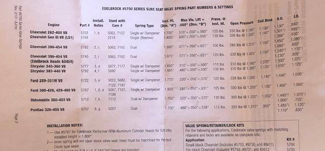

The replacement valve springs came on Monday.
Looking at the tech sheet....
The highlighted section shows the max lift with the springs....
How can this be right? The '528 cam and 1.6 rocker arms were at .563 lift.
The Lunati was even higher and I didn't have any troubles. Am I reading this right?

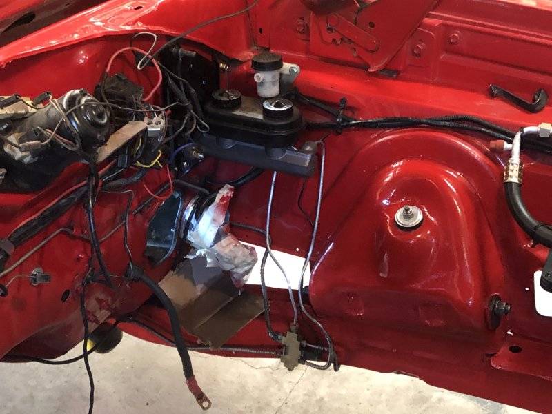

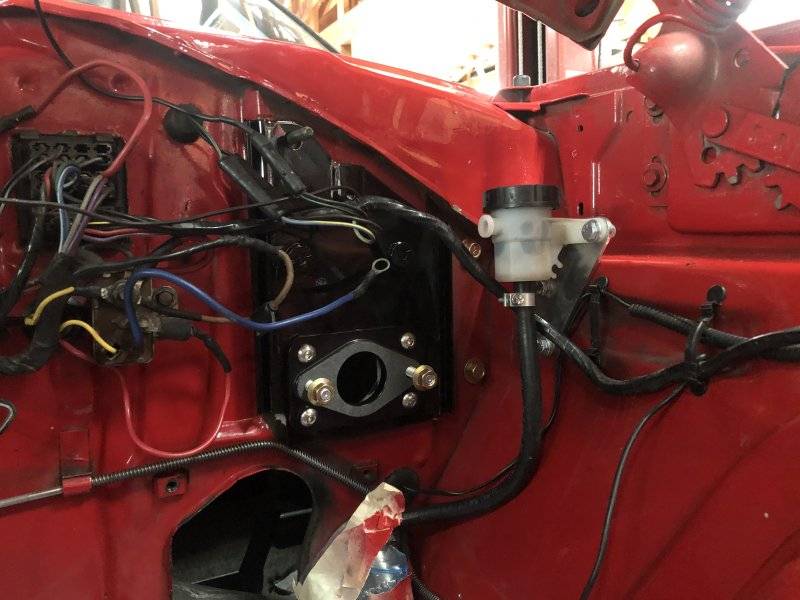

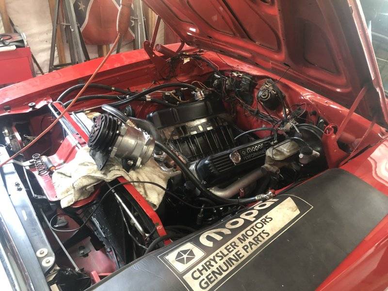

The firewall reinforcement plate was looking shabby. It sat tucked in behind the brake booster before but since I'm switching to a manual master cylinder setup, the poor appearance would be in full view.
You can see the original color of the car right here...
The plate was cleaned and repainted. It has obviously been on the car since it was new.
The clutch master cylinder reservoir used to be attached to two bolts on the master cylinder.....
With the new master cylinder being a 2 bolt pattern, I had to relocate the reservoir.
Simple enough.
The firewall plate is back in....what a friggin JOY that is to do by myself. With the steering column out, I had my hand through the firewall with a wrench on the engine side....then a ratchet, extensions and socket on the interior side.
Tuesday makes 2 weeks that the engine has been at the machine shop. As of now, the engine bay is ready along with the brake system. I still plan to refinish the K member and suspension. That is next on the list.

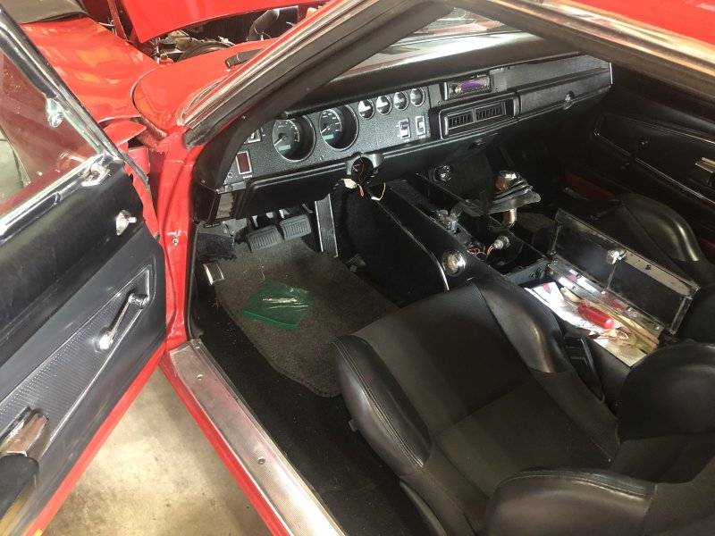

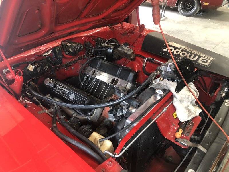

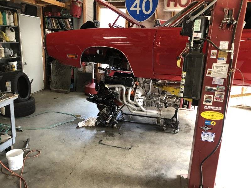

Busy day.....lookie what I did!
I got a bit of a later start but was lucky to have the day off to do this today.
So often when a big project awaits, I delay and put it off until I'm ready. Mary pushed me into doing this today and I'm glad she did.
This is my first time removing an engine and transmission this way. Nobody was around so I did it myself.
I was careful to disconnect and remove everything that could snag, drag or hang up. The wiring on these old cars is so simple! The A/C compressor is still connected. I was able to swing it over to sit on the core support. This bottom removal is great. I was able to leave the radiator and shroud in place.
I took the fan off though.
This method requires removal of the steering column and shifter.

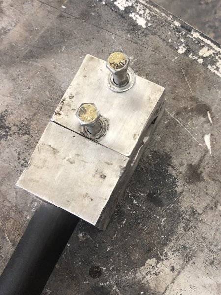

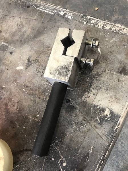

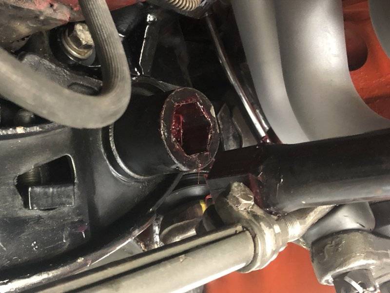

I raised the car up and used THIS tool to remove the torsion bars:
Tighten the Two 3/8" bolts and tap it rearward to dislodge the torsion bars.....
It helps if you remembered to grease them when you first installed them.

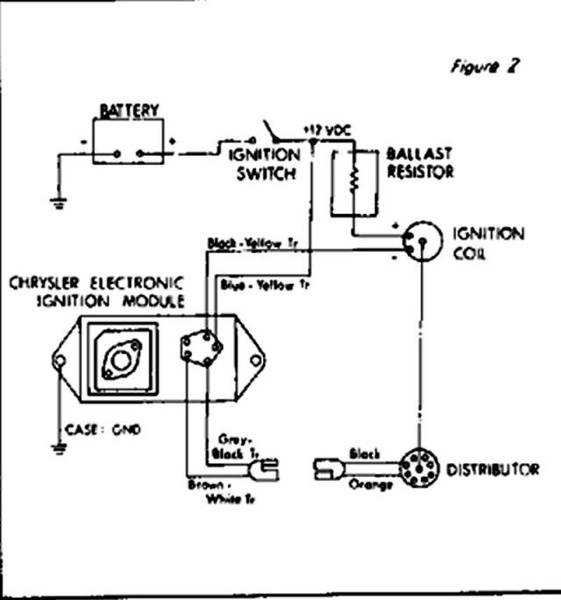

Most have a rev limiting feature. They break up ater a certain RPM. There is one I think FBO makes that is adjustable.

I wanted to get pictures of my own but since you posted them above in post #139,
FBBO member Beanhead/Lloyd sent me a FBO box and coil last week. I'll start the car with the existing setup and switch to the FBO setup after it is up and running.
