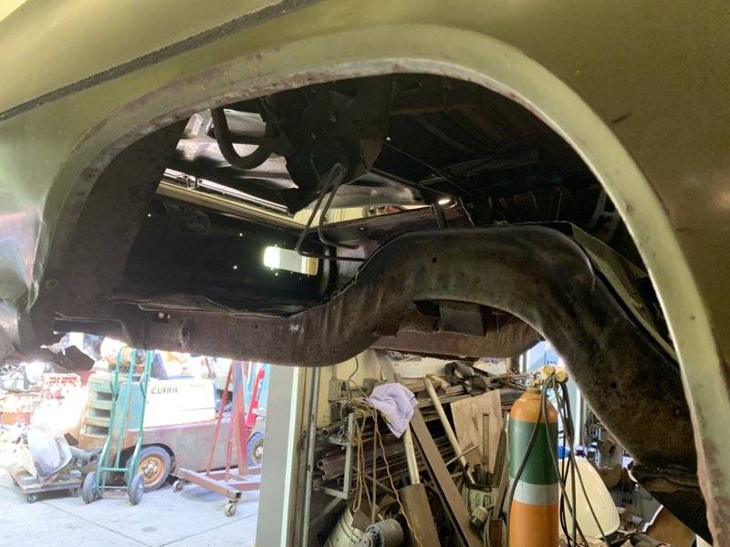

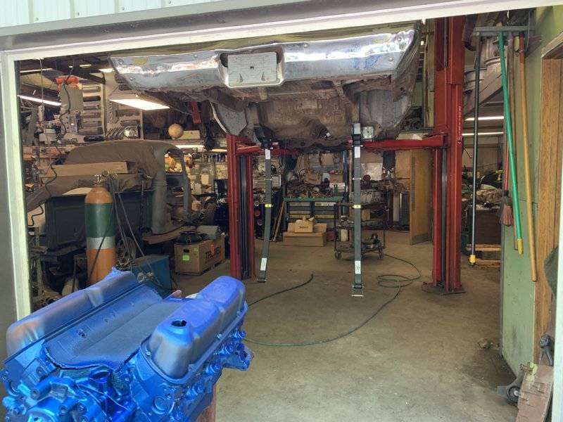

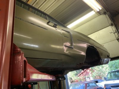

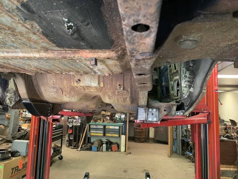

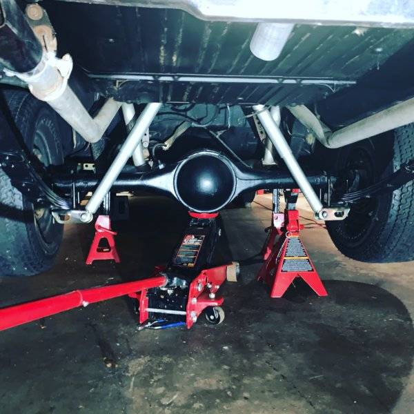

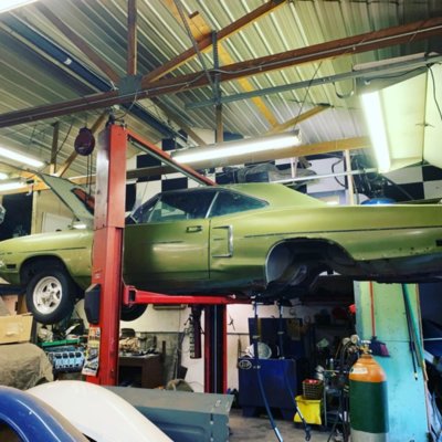

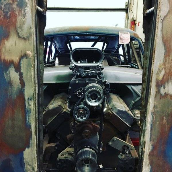

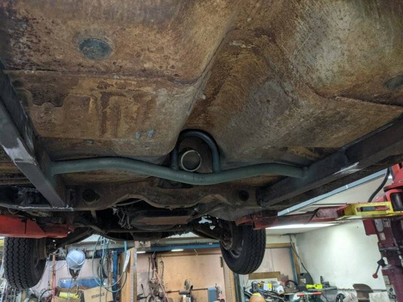

Super Beat should be back on her wheels by next weekend! Then it’s subframe connecters and roll bar...might not be driving this season, but dang i’m Stoked. The engine, and fab work are being done by local racing legend Gary Hedden of Magnum Superchargers out of Cedar Mn.

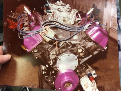

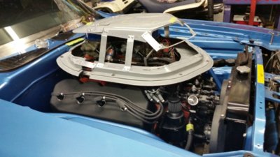

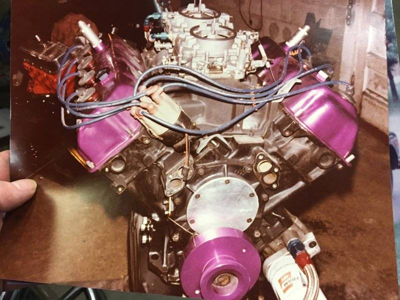

Here are some of his old cars, and a Henry J Gasser that’s getting a Blown 392 Hemi
should be cool, when done
more meat (as in tires, totally nonsexual) is always nice :poke:
what size rear wheel & tire are you going to ?

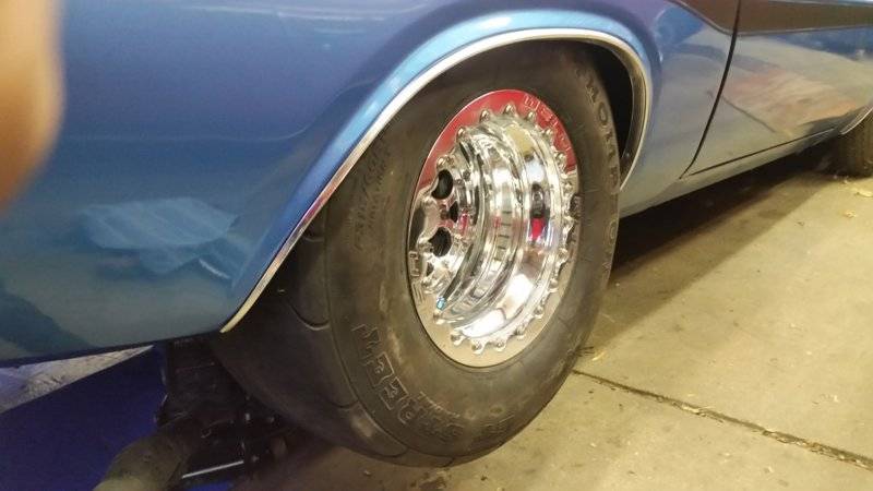

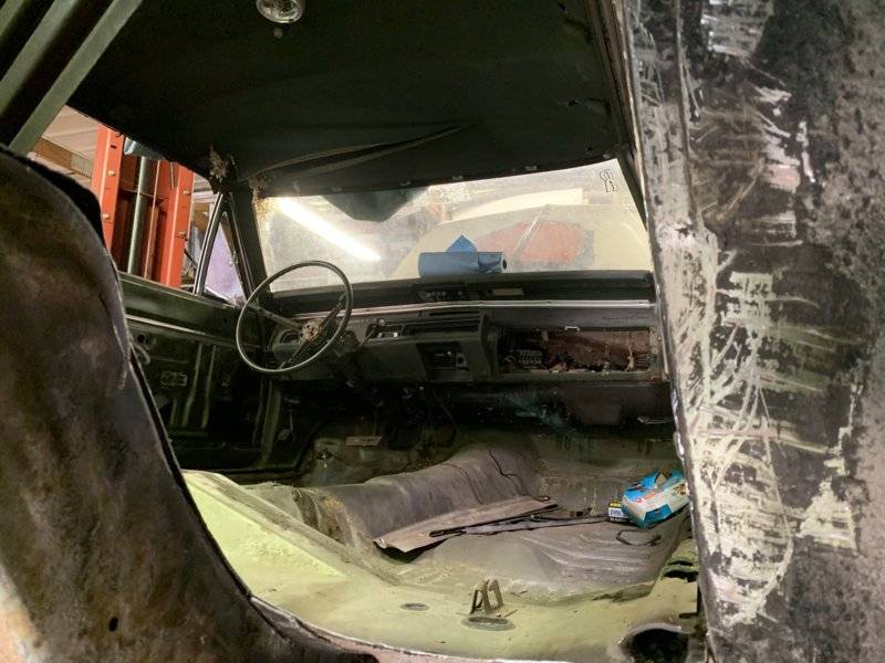

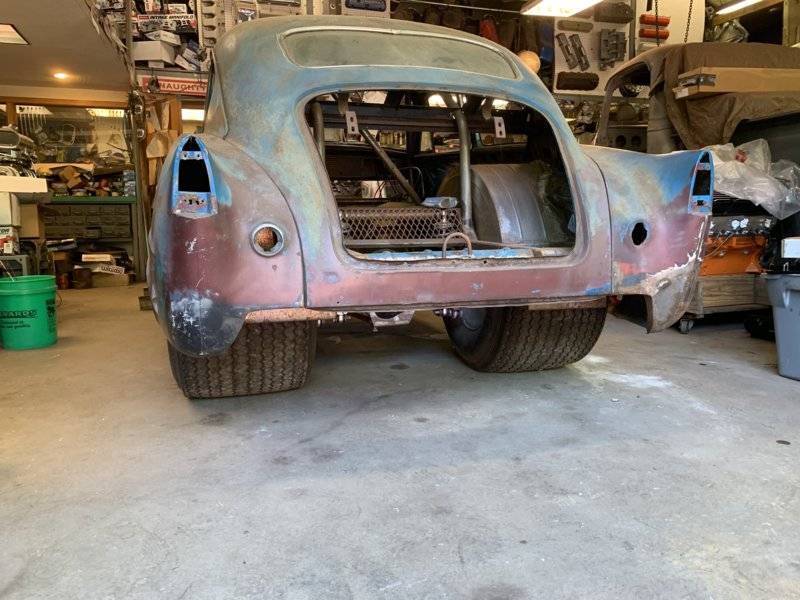

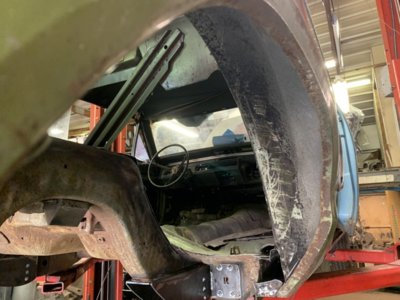

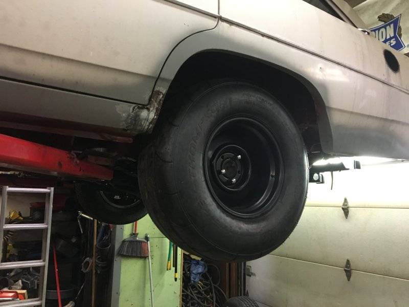

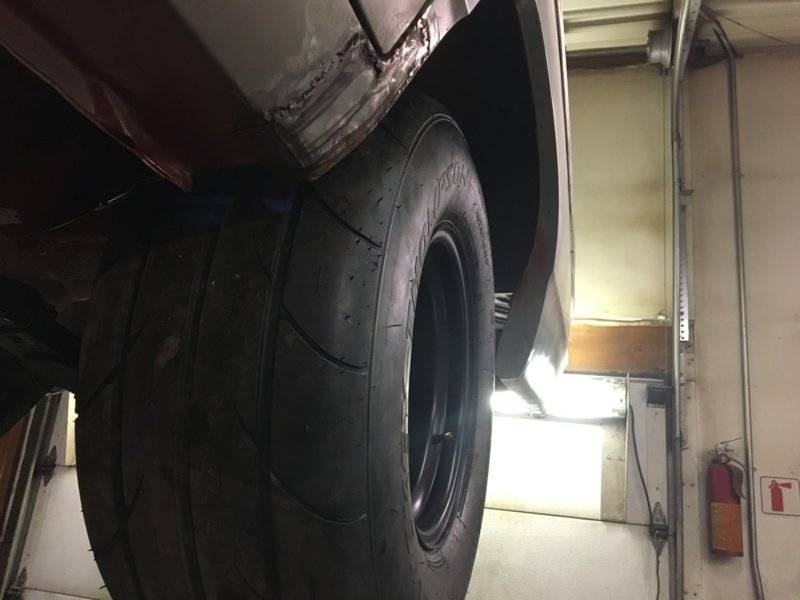

There is Almost 17” of clearance with mini-tubs. I’m out of town right now. Next week I’ll take some more pics. I’m looking at running Hoosier 29.5x11 15 slicks with 15.2 section width. This pic is the 295/65r 15 13” section width on 15x10 5.5 backspace on the 70 Satellite Wagon he did before my car. He narrowed My Dana 60 1inch each side.
CECF61B5-8FCD-4354-A557-4058CFAA6843.jpeg 374D6A5C-F695-4692-A8B8-34EEE89D9CA0.jpeg C898F4FE-C2AC-498F-99A7-362235BEF1A1.jpeg

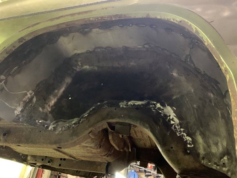

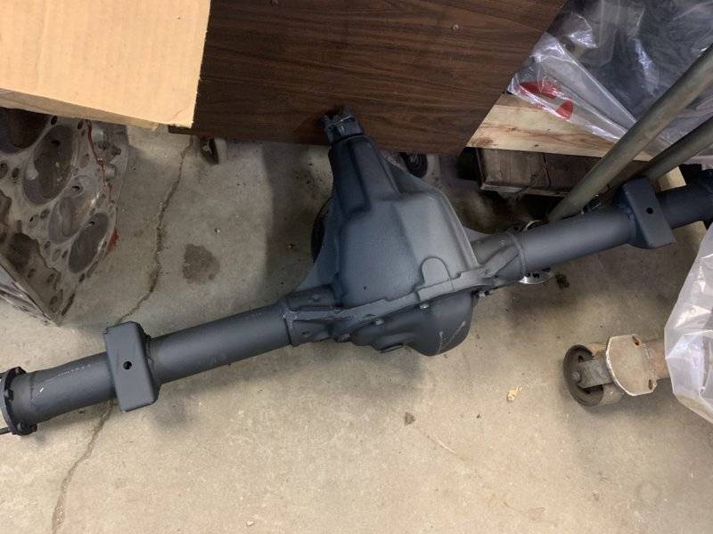

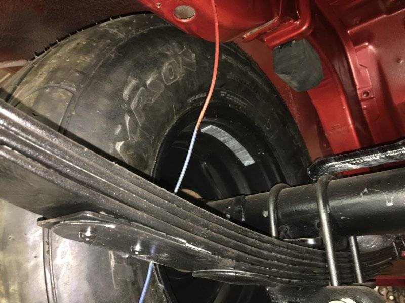

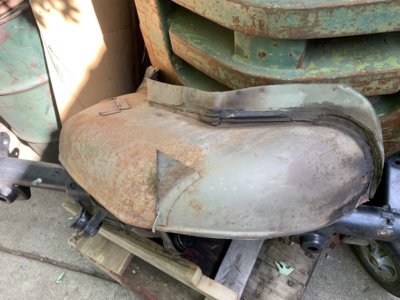

Did this on my Challenger also. Mini tubbed it to the frame rails and narrowed the Dana 60 to fit. Now I can fit a 315/60/15 Drag Radial or 29.5X10.5W slick. Also went with spool, 40 spline gun drilled axles.

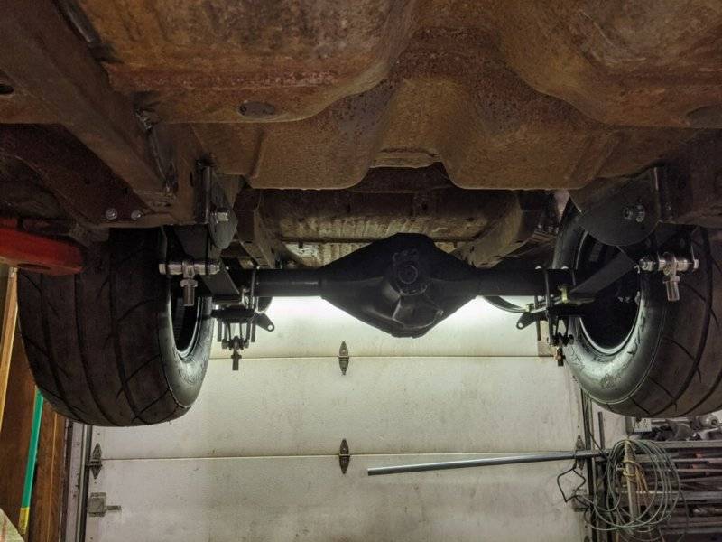

The narrowed Dana is just waiting for disc brakes, but perches are welded in. Spring relocation is done waiting to finish welding in the mini tubs. Can’t wait to mock up the rear end! And sit the car on the ground.
Oh yeah, I installed super stock springs On my Satellite. So I’ll be able to compare to Caltracs on the Coronet.
