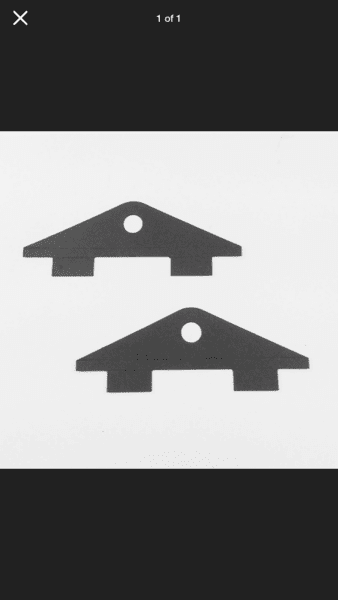

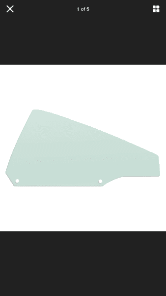

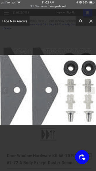

Is this what’s needed for the holes on the quarter window?
