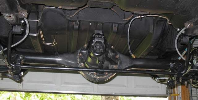

Those posted are E body or aftermarket E body based design. 72 and lates B bodies are diff. I had a good thread about that at dodgecharger.com board, but since the board was upgraded, attachments are still being fixed.
Thats what I said. They give you GOOD instructions. CALL Firm Feelyours is same as the photo of BigFlo's car or like the one of the E-body I posted?

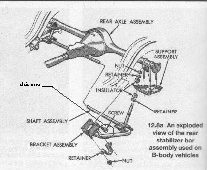

Here is the factory diagram.
the pic got circled the screw used to attach the bracket to the frame rail, because I was adding the sway bar on my car and was asking about the size of the screw.
72 sway bars assembly are one year only, then 73 and lates are slightly diff due the isolation spring setup, but they are pretty much the same.

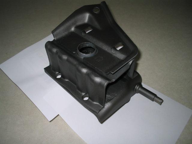

This is almost comical. We all had to wait for something lately for way to long. IDK what if they have someone separately that just handles shipping but I will say that some parts are heavy to ship like rear springs and even a sway bar. In referring the sway bar Its kinda an odd shape. I know when I ship heavy objects, do you really think I can pull a shipping quote out of the air? It is what it is, regardless if they get back to you later after a quote.That is the funkiest sway bar I have ever seen. Can't believe the way the end links mount to the bar - although I guess you can't call them "end links." No way Firm Feel's End Link Plates will work with that arrangement.
