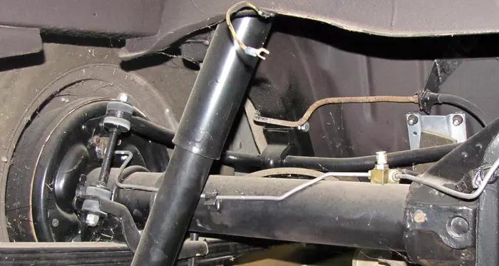

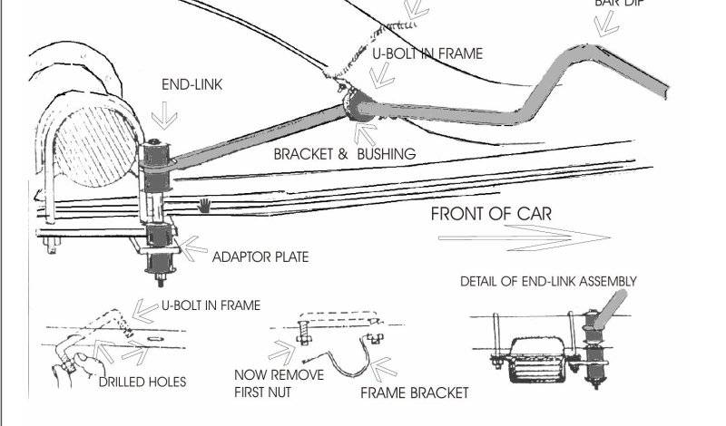

Here's an example photo from another forum. You can see the support mounting bracket on each side.
Thanks for posting that pic! I purchased a set of those sway bar end link plates from Firm Feel but I had no idea how the plates mounted, or how the sway bar mounted. Now I've looked at how PST's bar mounts -
- and I can see I'm in for drilling holes in the subframe regardless. That must be how Chrysler did it, so I suppose it's o.k. I'm concerned about measuring the location of the holes precisely enough, but perhaps it's obvious where the brackets go when you look at it.
I have to say I like Firm Feel's sway bar end link plates better than the little PST adapter plate that is only held on by one nut. It doesn't look like PST's bar would be compatible with Firm Feel's end link plates though - or with the factory plates, I assume. That is an odd decision - presumably guys with factory sway bars would want to upgrade to a stiffer bar, but use their factory end link plates.
I think I may like PST's way of mounting the sway bar bracket on the subframe better, although I didn't at first. It looks like Firm Feel's brackets bolt on from the side, which is four more holes in the subframe. On top of that, you have all that area between the bracket and the subframe for water, salt, and gunk to get into and create rust. I could live with it, since my roads don't get salted all that often and I don't plan to drive the car in bad weather anyway - but it's not a concern at all with PST's design.

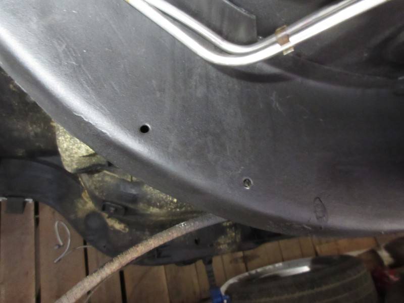

72 and laters already have the holes for the brackets on frame rail. Stock brackets and location can be used if adding the rear sway bar
I'm glad you posted. I was looking at the frame rails today and spotted these holes -

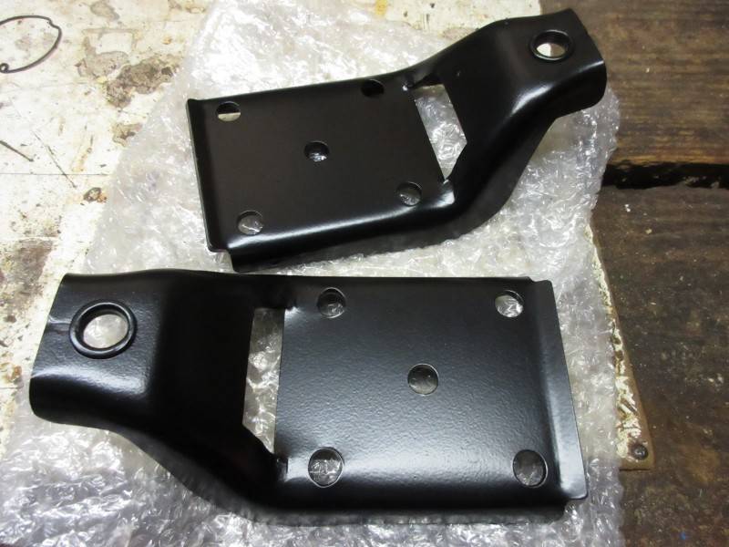

About these Firm Feel swaybar end link plates -
Firm Feel's description says - " These are direct OE replacements for the factory style plates. They mount between the axle and leaf springs to allow you to install a factory rear sway bar."
I don't understand how these can be used with a factory style sway bar mounted near the bottom of the frame rail.
If I can use them though, that would be great. I could get on with reinstalling the rear end and fuel tank, and worry about putting the sway bar in later.
If I have to go the Firm Feel sway bar route though, it looks like it would be best to put that in before anything else.

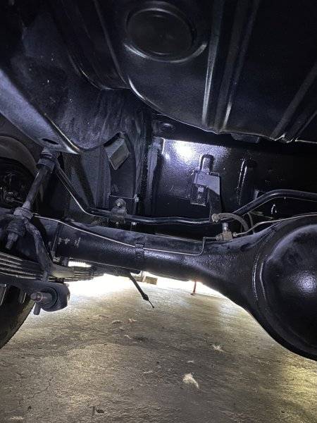

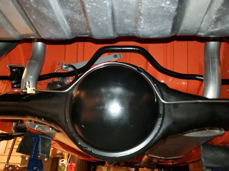

Found this Firm Feel sway bar installed on user BigFlo's car -
This looks like it is mounted same as the one in my previous post - is it possible 68 Sport Satellite's bar is not installed correctly? His sway bar brackets are right up next to the bump stops.

That's how FF designs it, same as mine

that photo I posted is not of my car. It's an E-body, but the mounting location on my 68 Satellite is in the same general location.
Best thing for you to do is call Dick at Firm Feel. He'll clarify everything and is very nice to talk to.
Your sway bar brackets are way up by the bump stops as well (on a b body?)
yours is same as the photo of BigFlo's car or like the one of the E-body I posted?
Here's where the mounting holes are on my 72 Charger -
About as far away as they can be from the bump stops, without being on the bottom of the frame rail.
