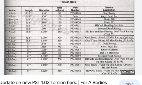

I found a chart, but looks like part numbers are not factory because they start with a "P".
Some stock parts got later the Mopar Performance PN supersedes number. The stock Magnum BB camshaft ( and 6pack camshaft bro ) is one of them in fact, being the first (and second) one on the MP catalog list

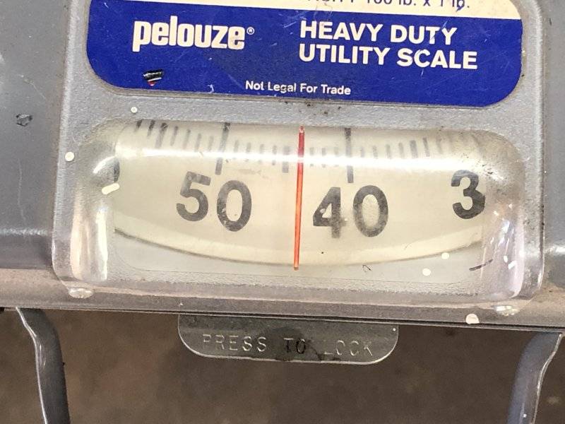

The K in my 66 Belvedere is 32 lbs with mods and still uses the stock steering box mount and engine mount stands but they are modified. Have another K that's 26 lbs but there's no stock engine mount stands. The engine will have to use Effellant ears with the 26 pounder.
Really? 32 lbs?

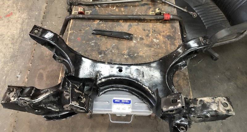

My '70 Charger K member with welds and gussets....
These have the double shear idler arm mount but I wonder what else is different to explain the weight difference.
Based on my experience in weighing my own self, some scales are nicer to weigh on than others . . .
