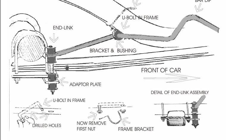

Thanks for posting that pic! I purchased a set of those sway bar end link plates from Firm Feel but I had no idea how the plates mounted, or how the sway bar mounted. Now I've looked at how PST's bar mounts -
- and I can see I'm in for drilling holes in the subframe regardless. That must be how Chrysler did it, so I suppose it's o.k. I'm concerned about measuring the location of the holes precisely enough, but perhaps it's obvious where the brackets go when you look at it.
I have to say I like Firm Feel's sway bar end link plates better than the little PST adapter plate that is only held on by one nut. It doesn't look like PST's bar would be compatible with Firm Feel's end link plates though - or with the factory plates, I assume. That is an odd decision - presumably guys with factory sway bars would want to upgrade to a stiffer bar, but use their factory end link plates.
I think I may like PST's way of mounting the sway bar bracket on the subframe better, although I didn't at first. It looks like Firm Feel's brackets bolt on from the side, which is four more holes in the subframe. On top of that, you have all that area between the bracket and the subframe for water, salt, and gunk to get into and create rust. I could live with it, since my roads don't get salted all that often and I don't plan to drive the car in bad weather anyway - but it's not a concern at all with PST's design.
Well it looks like I am locked into Firm Feel's rear sway bar, unless I want to sell these Firm Feel end link plates that I rather like. Which means I need to come up with a larger sway bar that fits inside the QA1 k member and strut rods. Anyone know how big the Hotckis front sway bar for 72 is?
The Firm Feel bar design is the same design that the Factory used on E body cars that got a rear bar. Once the bolts are installed, there is zero loss of strength in the frame rail.
