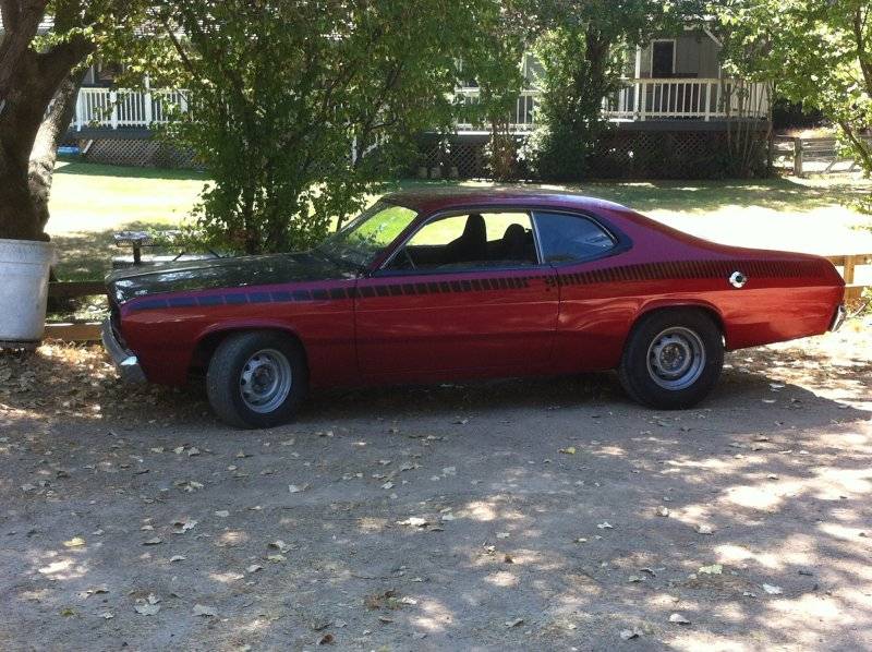

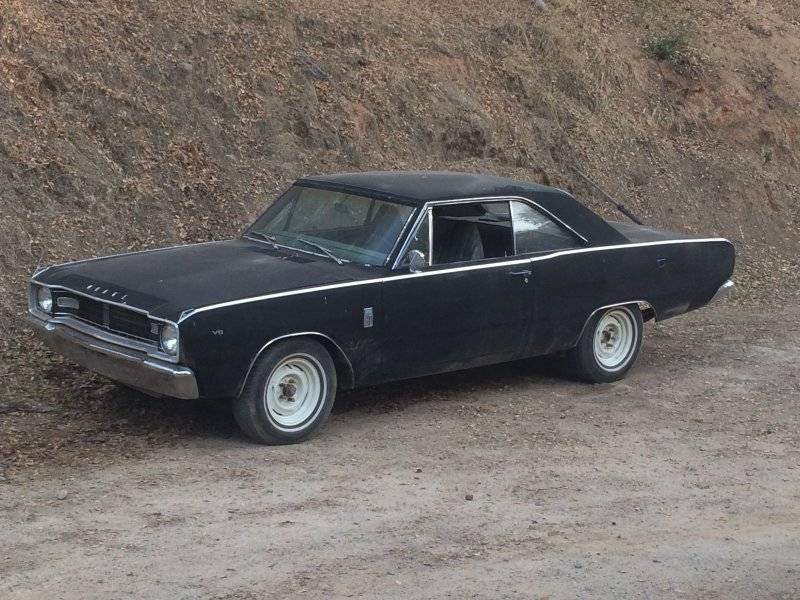

I have these cars out back:
They both have mild 360s with the most basic of all Holley carburetors, the 600 4 barrel manual choke, list 1850.

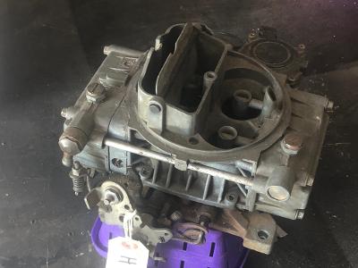

Sort of like this one:
