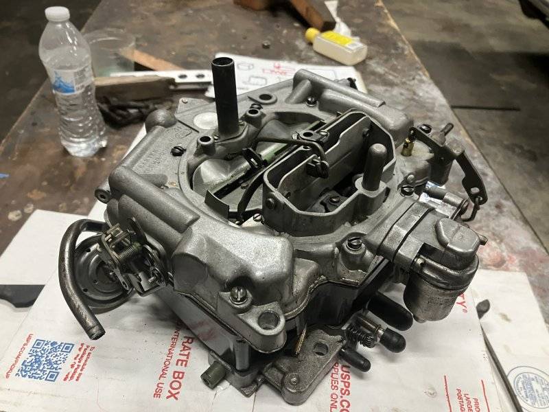

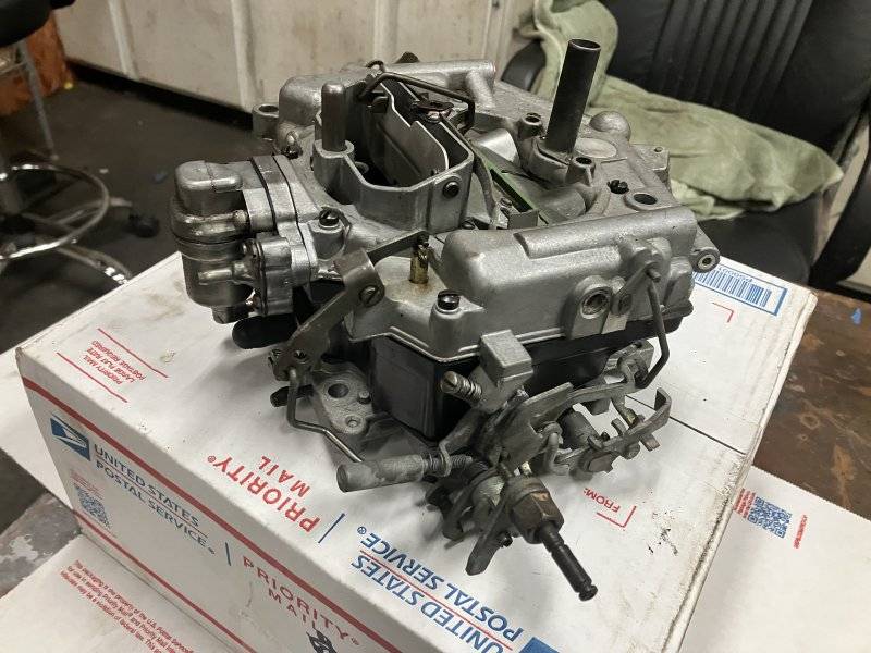

This is the carburetor that inspired the thread for me.
I don’t remember where I got it. I had a guy at a local shop go through it. He did say that I’d need to install and run it in a short time but I got distracted with other things and let it sit.
This one PUKES gas up the throat as the car is running. I figured the needle and seat were stuck so I tapped on the top with a ratchet but it kept pushing gas so I pulled it and swapped on a known good Holley 600.
It essentially has zero miles, it just needs to have this one issue addressed. These are the only numbers I can see at a glance.
With that ugly, bulbous thing at the front I suspect it is from the mid to late 70s.
The carb guy used to rebuild stuff for me in trade for parts he needed for his Dart. I lost some of my rebuilding skills by farming out the work instead of doing it myself.

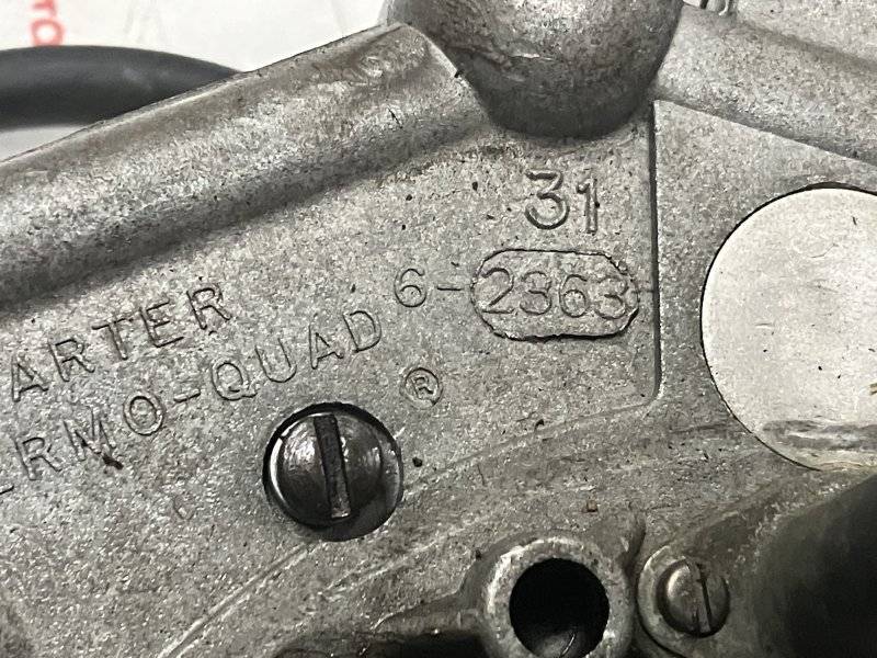

To identify Thermo-Quads, the model number is stamped on the throttle body lower left rear bolt flange. The model number consists of four digits, usually followed by an ‘S’ or ‘SA’, along with the date code.
The model number is above the date code. Example:
9009SA <-- Model Number
268 4 <-- Date Code
The 6-2363 in the picture is the casting number of the bowl cover, or top, and does not identify the carburetor model.
The device on the front of the carburetor is the Altitude Compensator or Alcomp (Alc). Alcomp was introduced in the 1975 model year. This device alters the high speed metering circuit by sensing atmospheric pressure. It mounts to the same area as the IE system at the front of the bowl cover. This system is a driveability enhancement, which also reduces emissions, by allowing the Thermo-Quad to compensate for elevation.
268 4 <-- Date Code

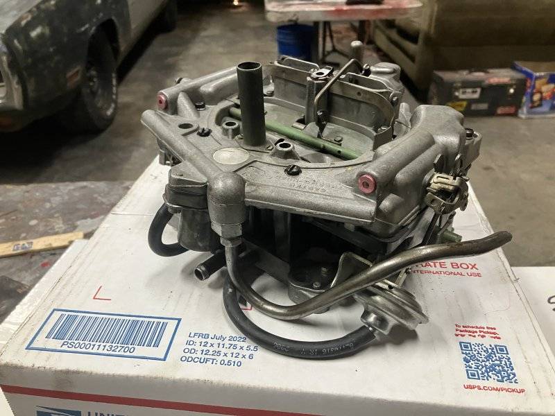

Are all of those 6324’s? What are you doing with them, I’m looking for an early 73 dated one
Yes, all are 6324...and from all of them I can make one working one. Sadly...
