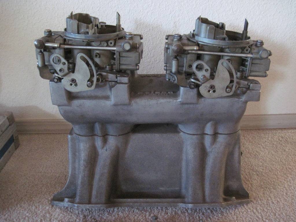

Just bought a pair and they probably should be rebuilt. Throttles are a little sticky and most likely internals need freshening up.
I've ordered 2 kits from Summit (although I've never rebuilt a carb before) but willing to learn.
Any advice/recommendations appreciated.

Turn the carbs around on the intake. :D Also, the fuel inlets were turned backwards for shipping reasons. Didn't want them to poke a hole through the boxes. The nuts holding them are only snug. Also, make sure all the jets are the same. Make note of what's in the first carb you do but I've heard people using different jets based on what the plugs say. And don't let anyone tell you to mill the choke horns off. Even though there's no provision for a choke plate, they actually perform just as good if not better with the choke horn left intact.
